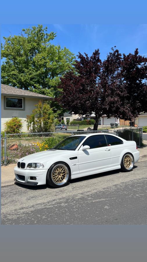

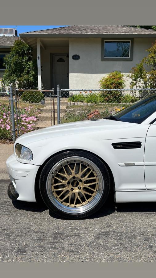

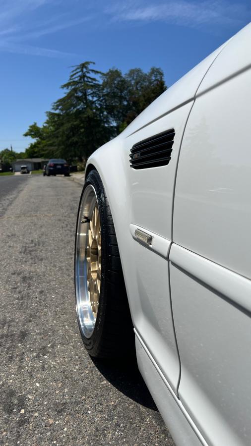

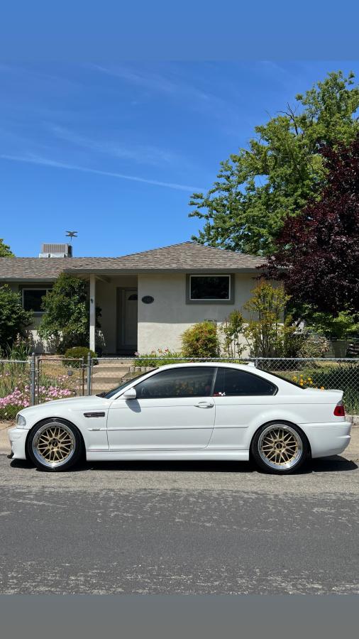

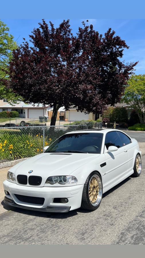

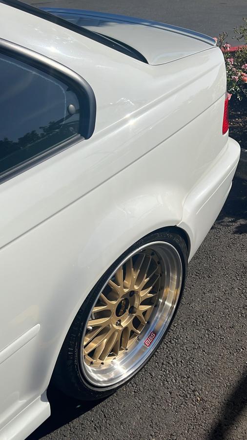

                            Chiming in with my wheel and tire setup since I didn't see it under the recommended section.
                            BBS LM
                            19x9
                            19x10
                            ET27 all around
                            PS4S 245/35/19
                            Cup2 265/35/19
                            Love the meaty look of this setup, definitely rides a lot better than my former stock 225/255 19's setup. Also got to shake it down on the track this past weekend and the car performed flawlessly.
                            Future plans include raising the rear up a tad as the cup 2's rub every so often just barely. My goal was functional aesthetics which I think I accomplished quite well.
