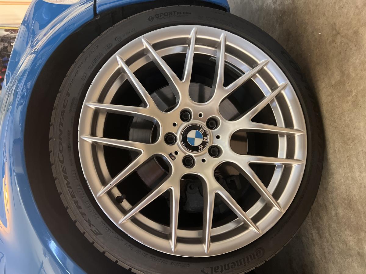

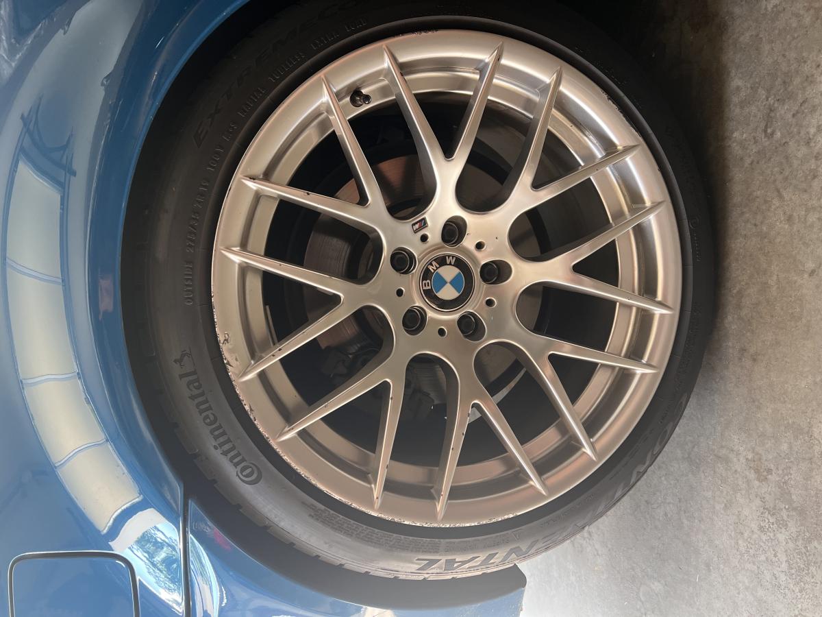

                  Hello All! I recently rejoined the M3 ownership club, adding an E46 to my garage. It came with some CSL wheels, not sure if OEM or replicas but the tire sizes on the car now are a bit confusing as mounted.
                  275/30/19 in the front, 275/35/19 in the rear. I don't know the exact wheel sizes but this seems out of spec to me. Should I be putting the current fronts on the rear and getting 245/35/19 up front? Thoughts? Any help would be much appreciated!

                    Welcome! And congratulations. I'm going to assume it's running a square setup, that's why it has such a large tire in the front. So in a square setup, the front and rear wheels are the same. They look OEM from the pictures, but it can be hard to know for sure unless you inspect them closer.
                    There is nothing wrong with a square setup, that's what I run in my car, but it will tramline a bunch, and the front steering can be twitchy. Really, it's personal preference and driving style. If you want a more OEM driving experience, swap out the front wheels for a set of "front" sized ZCP/CSL wheels and a smaller 245 tire. I'm sure you'll have a line of people willing to trade you straight up.
