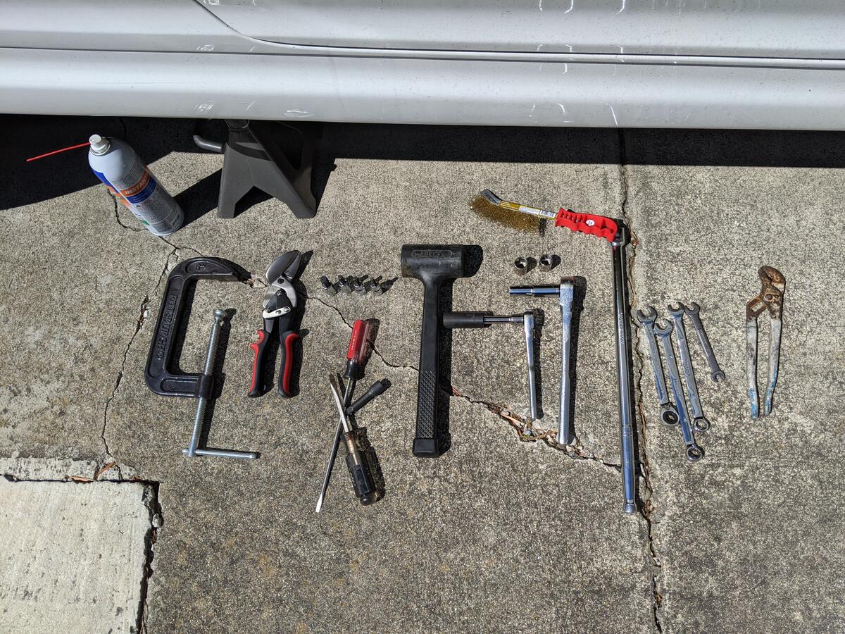

    The Tools
    • Jack and Jack stands
    • Hex Socket set - 5mm, 6mm ,7mm and 12mm
    • 12pt Deep socket - 13mm (front RR nut)
    • Ratchet set
    • Breaker Bar
    • Metric Socket set - 16mm, 14mm
    • Flat/Combination wrench - 16mm, 14mm, 11mm
    • flare nut wrench - 11mm (proper tool for brake line)
    • C-Clamp
    • Rubber Mallet
    • Rags
    • Cutting tool - Angle grinder, dremel, tin snips
    • Grinding tool - Dremel, angle grinder
    • Wire brush
    • brake cleaner
    • Brake Bleeder kit (optional)
    • Nuts and bolts - will provide home depot part numbers

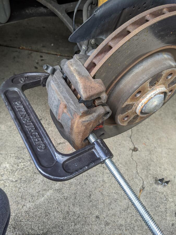

    • Compressing the Caliper Piston (Left Picture)
    • Caliper removed (Right Picture)

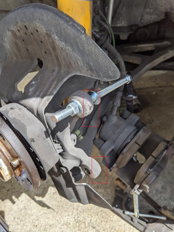

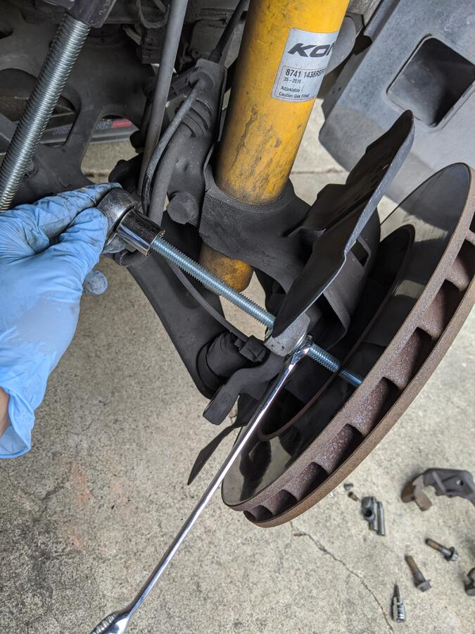

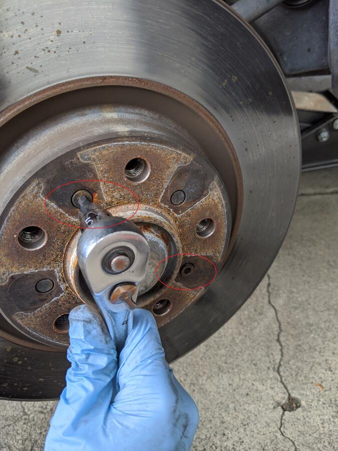

    4. Remove the Rotor. This is where I hit my first snag. The rotor is stuck and will not come off no matter how much I pounded with a mallet.
    a. Instead of wasting time with mallet, use a nut and bolt for leverage and push the rotor out - https://youtu.be/pMuHKDI00rw?t=34
    Click image for larger version  Name:	IMG_20200324_101517.jpg Views:	33 Size:	110.9 KB ID:	8351
    Tip 1 - You will need to loosen the contraption to rotate the rotor a few times and push on a different spot
    Tip 2 - you will hear a pop when the rotors are free

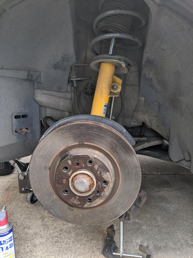

    b. Clean hub / dust shield - wirebrush/brake cleaner worked for me

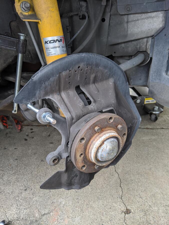

    Rotors removed (Hub not yet cleaned in this picture)
    Click image for larger version  Name:	IMG_20200324_101627.jpg Views:	33 Size:	100.5 KB ID:	8352

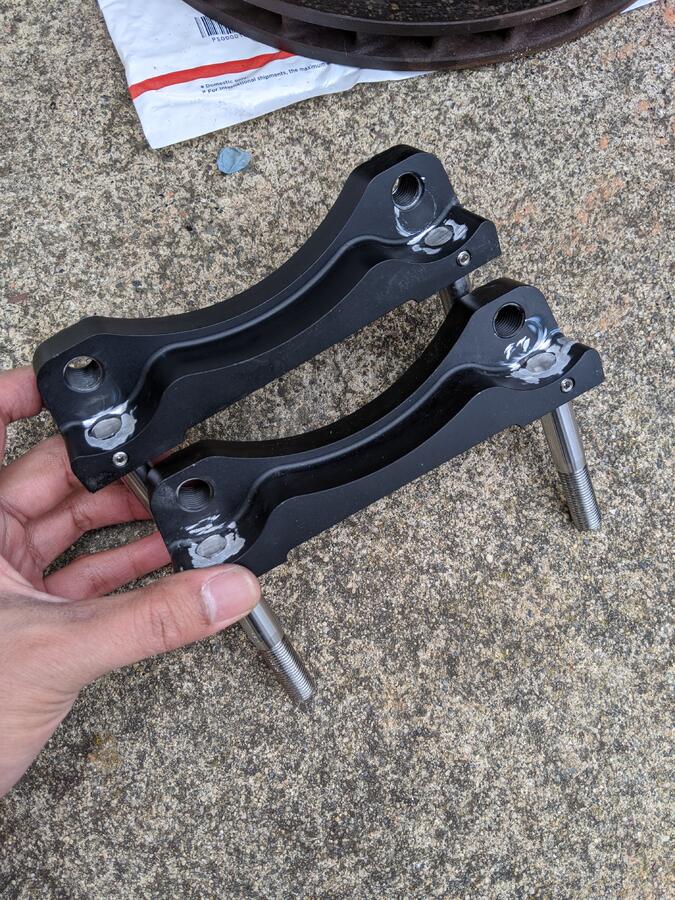

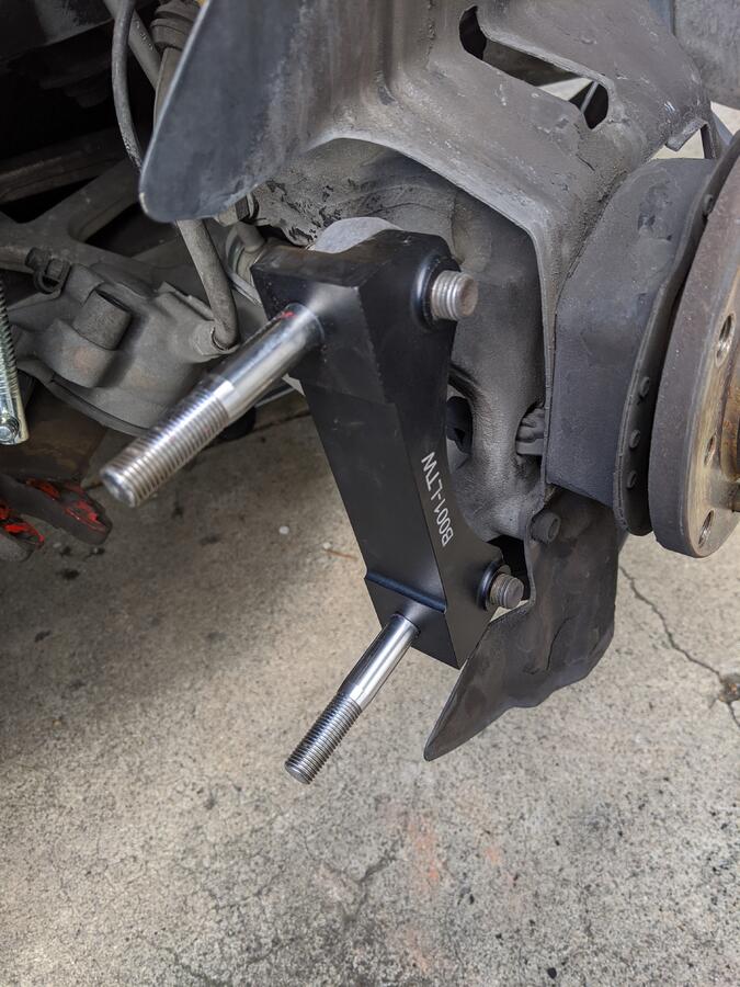

    5. Install the Front Adapter bracket to the knuckle

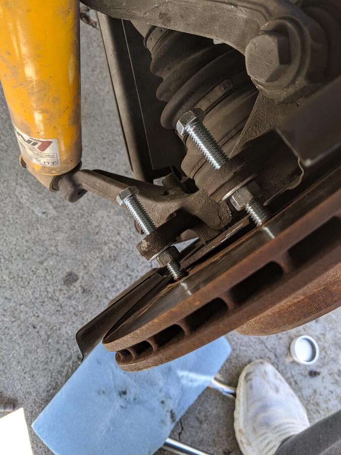

    a. This is where i hit my second snag. Turns out the bolt was screwed in too far that its protruding. This causes the bracket to not line up properly with the hole. In my case, i used a dremel to grind off the protruding part of the bolt. I contacted Eric from Rally road after the install and he confirmed this to be by design. You need to grind off the knuckle until to make the adapters fit. Use Dremel or angle grinder to do the job.
    Tip - Test fit your adapter before making any modifications. I have the RR brackets and it didnt line up correctly. Some members who also used RR brackets did not need any modifications to fit the adapter.
    • Not so right way (Picture on the left) - I ground part of the bolt
    • Grind these knuckles down to fit the RR Brackets instead (Picture on the right) - Eric from Rally Road recommends to grind the knuckle if needed to properly fit the bracket and have the holes align properly
    Click image for larger version  Name:	IMG_20200323_174943.jpg Views:	33 Size:	182.5 KB ID:	8353Click image for larger version  Name:	IMG_20200323_144218.jpg Views:	33 Size:	86.9 KB ID:	8354
    b. Both brackets are the same - make note of the orientation of the bracket. There is only one way to install this for the caliper to fit properly.
    Bolt >>> Knuckle >>> Adapter Bracket
    Click image for larger version  Name:	IMG_20200324_102315.jpg Views:	33 Size:	97.7 KB ID:	8355
    c. Re-Use the original bolts to secure the bracket - Tighten 50 ft-lb

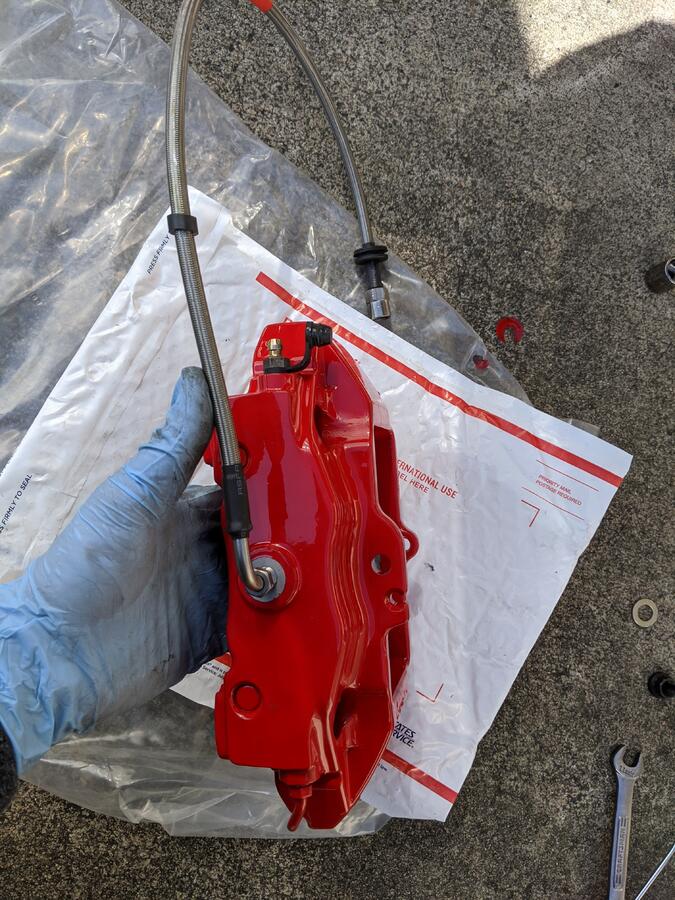

    6. Prepare the caliper for install

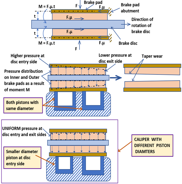

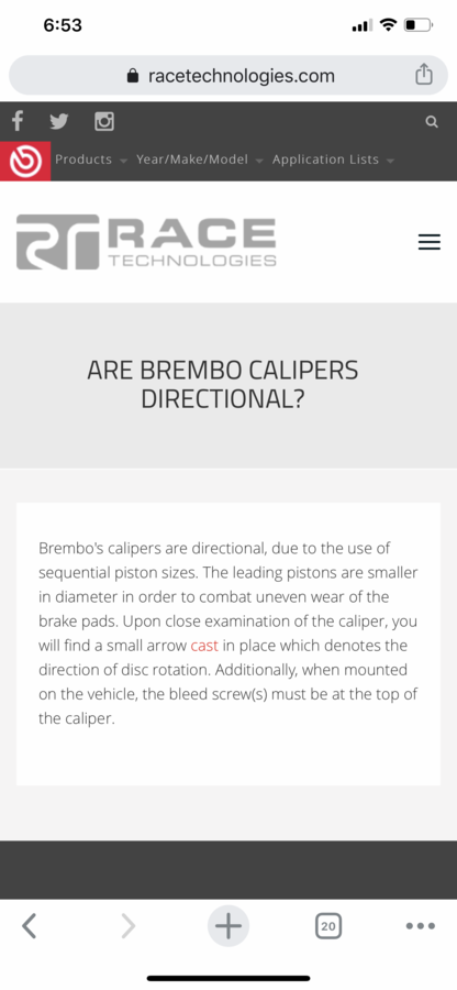

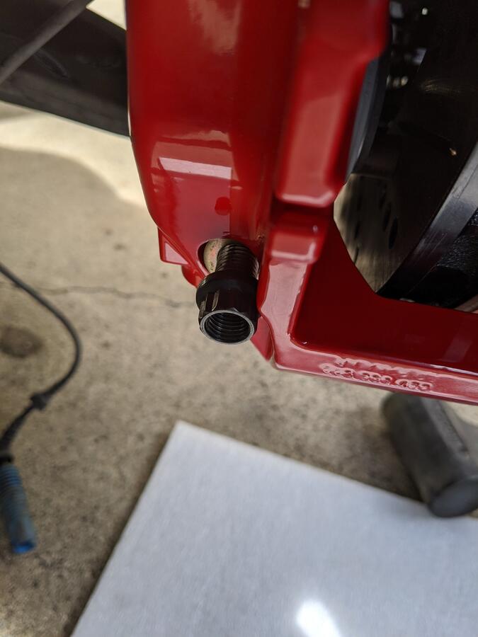

    a. Verify you have the proper orientation for calipers - bleeder screws should be on the top and the cross pipes in the bottom.
    b. swap cross pipes and bleeder screws if you need to change orientation
    c. tighten bleeder screws
    d. Compress piston calipers if needed - use C-Clamp and brake pad - https://youtu.be/3RYG0ymWEFE?t=131
    Tip - If pistons are not fully compressed, you will not have clearance to install the pad later - dont be like me - I was lucky I still had the old worn pads that fit so i was able to compress the pistons without removing the caliper.
    e. Screw in the stainless steel brake line to the caliper (90 degree bend) but do not tighten. - You want to be able to adjust this later when routing the lines
    f. Install brake shim/dampers if you are using it
    Click image for larger version  Name:	IMG_20200324_103347.jpg Views:	33 Size:	132.4 KB ID:	8356

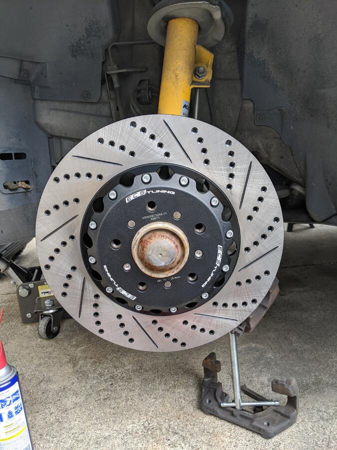

    7. Install the rotor - ECS came with new hex bolts
    Click image for larger version  Name:	IMG_20200323_145853.jpg Views:	33 Size:	109.9 KB ID:	8357

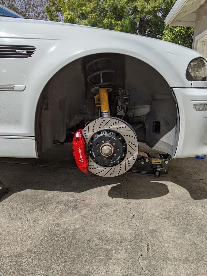

    9. Install Brembo caliper onto bracket
    a. Tighten 35 ft-lb - 13mm 12pt deep socket

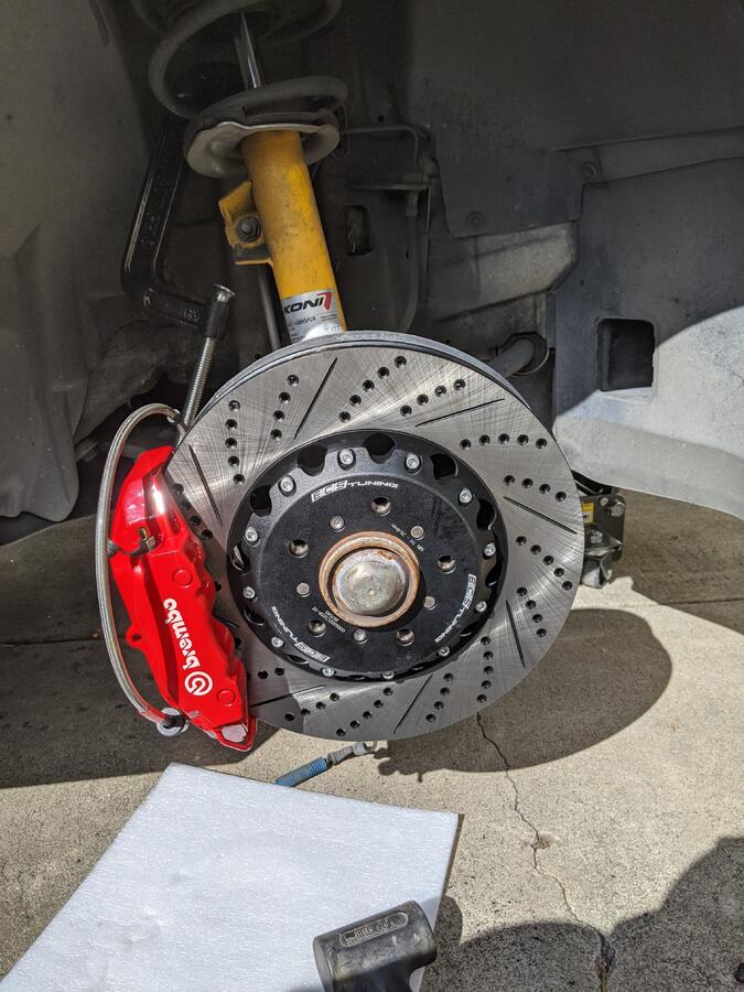

    Caliper installed (Passenger side pic)
    Click image for larger version  Name:	IMG_20200324_104651.jpg Views:	34 Size:	45.9 KB ID:	8358Click image for larger version  Name:	IMG_20200324_103614.jpg Views:	33 Size:	98.3 KB ID:	8359

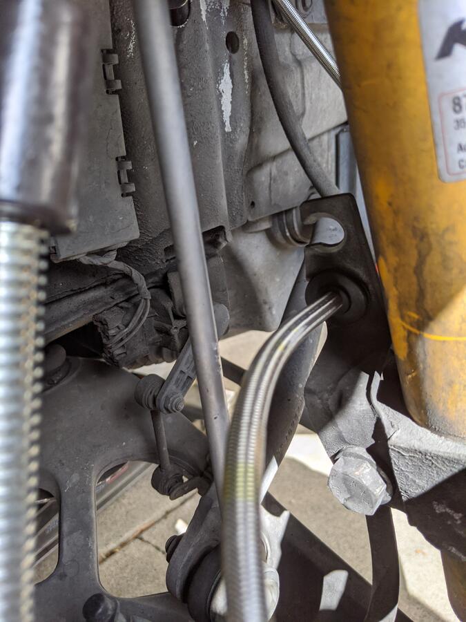

    11. Connect stainless steel brake hose to the brake line
    a. route the hose and make sure lines is not rubbing onto anything
    Click image for larger version  Name:	IMG_20200324_104018.jpg Views:	33 Size:	98.8 KB ID:	8360Click image for larger version  Name:	IMG_20200324_104034.jpg Views:	33 Size:	79.8 KB ID:	8361

    Pic of Passenger side installed
    Click image for larger version  Name:	IMG_20200327_110041.jpg Views:	33 Size:	114.0 KB ID:	8362

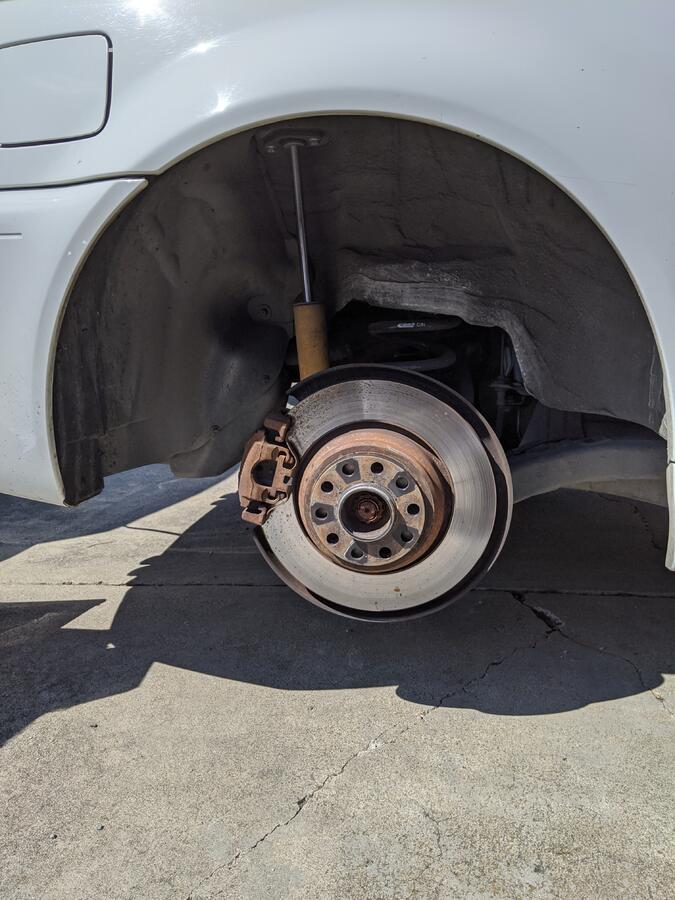

    III. Rear Passenger Side
    1. Remove wheel to access the brakes
    Click image for larger version  Name:	IMG_20200330_114226.jpg Views:	33 Size:	85.9 KB ID:	8363

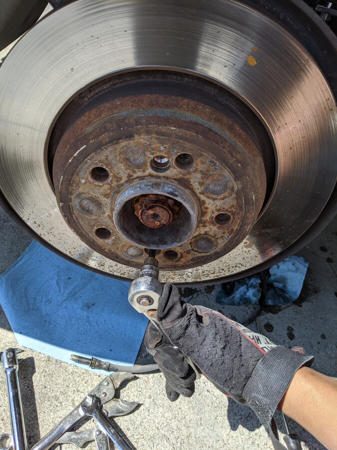

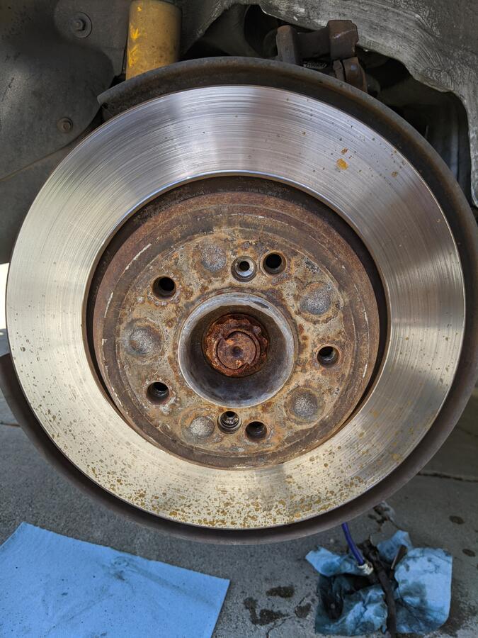

    4. Remove the Rotor
    a. As with the front brakes, rotors are most likely stuck - https://youtu.be/pMuHKDI00rw?t=34
    Click image for larger version  Name:	IMG_20200330_124500.jpg Views:	32 Size:	84.7 KB ID:	8366Click image for larger version  Name:	IMG_20200330_124633.jpg Views:	32 Size:	105.0 KB ID:	8367
    Tip - alternate tightening both bolts until the rotor is free

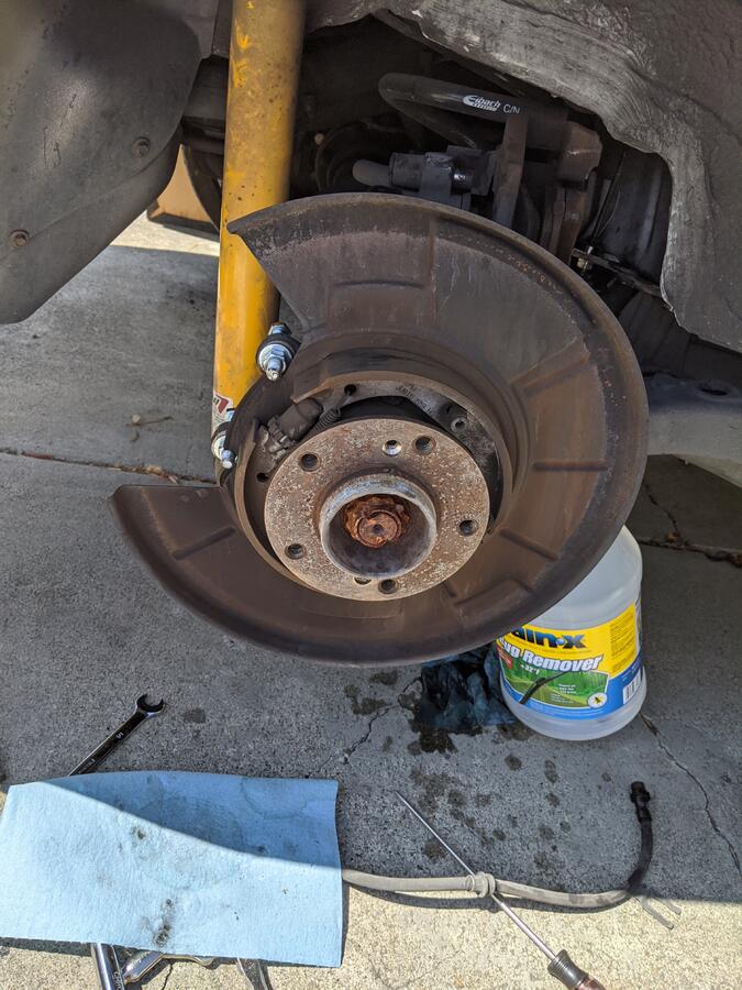

    5. Adjust parking brake if necessary

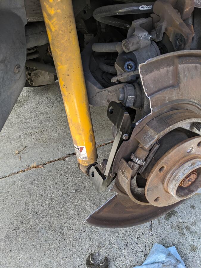

    6. Cut approximate 1.5" from each side of the dust shield
    a. Use any cutting tool at your disposal - Grinder, cutter, dremel, or tin snips - I used tin snips
    b. Optional - smooth out the cut edges and paint to avoid rusting
    c. Clean hub/dust shield - wire brush and brake cleaner worked for me
    Click image for larger version  Name:	IMG_20200330_131301.jpg Views:	32 Size:	121.7 KB ID:	8368
    e. Screw in the stainless steel brake line to the caliper (90 degree bend) but do not tighten all the way. - You want to be able to adjust later when routing the lines
    9. Install the rotor - I had to reuse the old hex bolts since this rotor didn't come with new ones
    10. Remove the stock caliper
    a. unplug brake pad wear sensor
    b. unscrew the brake hose from the brake line - expect some fluid to spill - place something under to catch the brake fluid spill
    c. Remove caliper
    11. Install the Brembo caliper onto the bracket
    a. Tighten to 45ft-lb

        Do you happen to have any pictures of the rear caliper orientation? I just want to make sure I understand which piston is supposed to go where.
          Its a busy day at work. Still working on uploading the pictures. I didnt have help and have been trying to take as many pictures as I can with my phone. Unfortunately a lot of the pics dont really show what I needed to convey so Im using pics from both sides. Will try to get the rest done after work.
            Awesome write up , thanks for the contribution!
            Sorry I didnt take a picture. But its quite simple - The rear is installed as a trailing caliper - meaning the smaller piston will be at the top/front and the bigger piston at the bottom/rear. If that makes sense. Bleeders will always be on top. Its easy to figure out from that point. If you are still confused I can probably help with facetime or something at some time.
              It's the other way 'round. You want the smaller pistons making contact "first," leading, so bottom.
              Smaller pistons, front and rear, should be closest to crosspipes.
              The way the rear calipers mount on the porsche is 180 from ours, so we have to swap the pipes. You don't swap calipers from side to side, because you want to keep the smaller pistons as leading.
                ^^+1
                Budget CSL MAP Conversion
                  ok i'll check my rear calipers when the weather breaks. I didnt swap my calipers from side to side but i will definitely check the orientation. Thanks.
                    Ya left is still left. You just taking the cross pipe from right caliper and putting into bleeder holes of lefty and then put bleeders into where the original left crosspipe vacated. Smaller pistons and crosspipe on the bottom when you're all done and mounted.
                      Found a few pieces of information to support the smaller piston leading orientation.
