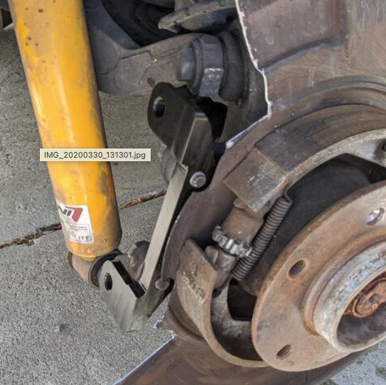

                          Hi OP, sorry to hijack the thread but since I am in the process of doing this conversion, I thought I could add a few more pictures feel free to move them to the main page.
                          today I spend most of the day trialling the callipers (rear) to modify the dust shields, I wanted to do this before I paint the callipers so I don't risk scratching them during the mockup and proceed to cut the shields to accommodate the Porsche callipers.
                          I am using rally road brackets
                          So the first step was of course to remove the wheel, calliper, and rotor, nothing out of this world here; I also was very lucky and my rotor screws came out pretty easily
                          Below you can see the share I followed for the upper part of the dust shield. at this point, I had cut just enough to bolt the upper section.

                          Next, the lower part, I did this to avoid cutting too much and follow the pattern of the mounted calliper, as you can see it was not much what needed to be cut just to seat the bracket, but you do need to cut off some more for the calliper to clear.

                          After cutting the shield I was able to mount the calliper
                          Click image for larger version Name:	IMG_0029.JPG Views:	0 Size:	53.1 KB ID:	36511
                          So far so good, but then I also checked how centred was the calliper in relationship to the rotor, and I found that is 3.2mm too car inboard. the bracket kit comes with 4 washers but they are just 0.8mm thick, so for the calliper to be centered I would need to use the 4 washers on one calliper, so I need to get some stainless washers from home depot.
                          See how the supporting pin of the outboard pad is contacting the rotor
                          Click image for larger version Name:	IMG_0031.JPG Views:	0 Size:	68.8 KB ID:	36513
                          Here you can see how much clearance is on the inboard side (that gap is 3.2 - 3.3mm), I measured it with feeler gauges. in this very picture, you can see where the bracket seats to the knuckle, there it is where the washers need to be placed, ideally 1.6mm thick to put it in the middle.
                          Click image for larger version Name:	IMG_0035.JPG Views:	0 Size:	62.0 KB ID:	36512
                          I will post a photo of the other side so you see the final product of the cut, I did use my Dremel smooth out the cuts and since I don't drive on the rain or winter I am skipping paining it for now as I would hate if I spray other bits in the process, plus you don't see it at all. bellow

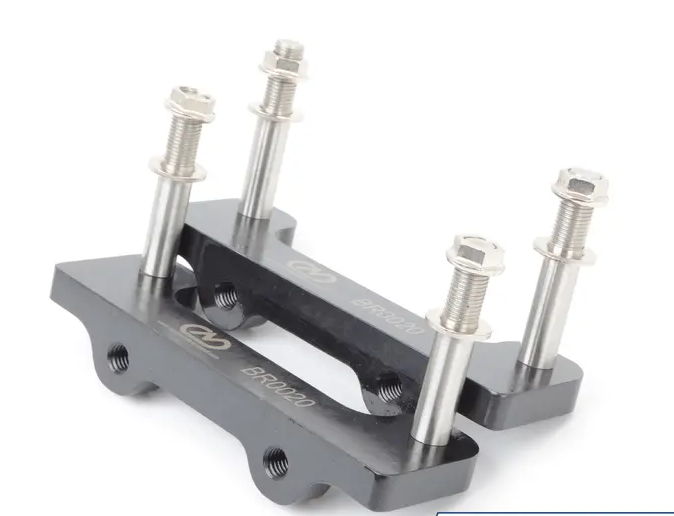

                            Almost done with my rear 996 install but EURO 737 pads not seating properly on inboard side. The EURO737 pads extend out the additional 5mm to avoid the rust ring that forms over time on the 328mm rotors. The culprit? The Creation Motorsport BR0020​ brackets! It looks like the Creation Motorsport brackets don't have a "groove" like the Rallyoad brackets - see pic below - so the "taller" EURO737 pads can't clear. I don't know why Turner (and ECS) continue carrying and selling this junk. Turner is always my go to but this is disappointing.
                            I guess I can Dremel the groove in but it that advisable? Or bring it to a machine shop to machine the groove in? Or just take the $170 loss on the CM brackets (been sitting on install for more than the 3 month return period) and get the Rallyroad brackets for peace of mind? I know, these are brakes we are talking here so the answer should be obvious to me.
                            What would you do?
                            Click image for larger version  Name:	Screenshot 2023-04-13 at 8.53.43 PM.png Views:	0 Size:	495.0 KB ID:	213739
                            (Rallyroad bracket w/ groove between mounting points)
                            Click image for larger version  Name:	Screenshot 2023-04-13 at 8.56.34 PM.png Views:	0 Size:	171.6 KB ID:	213740
                            (CM bracket w/o groove between mounting points)

                              azmirm5 Pretty sure this was mentioned in the 996 brake conversion thread by Tbonem3
                              If it were me I'd have a go machining them, but it does seem the rallyroad is worth the extra cost. They're lighter, better hardware, and obviously fit the proper pad.
