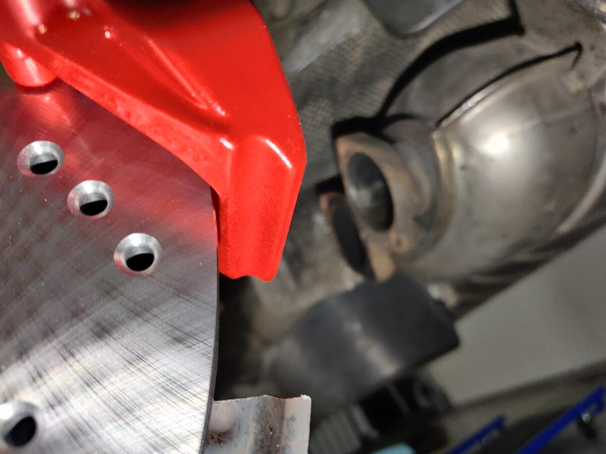

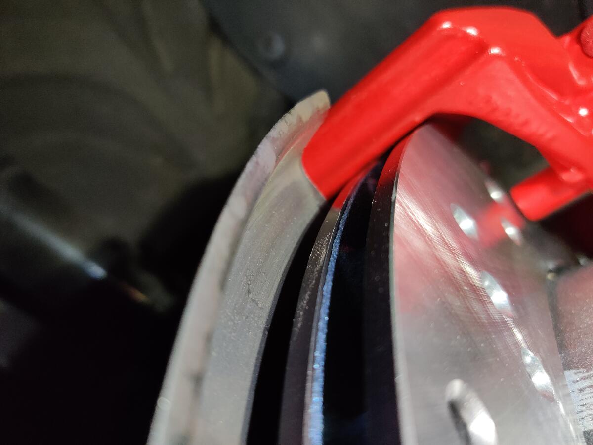

    I was doing some test fitting before final assembly. For some reason, my rear rotor is extremely close to the calipers. This is on both sides, using Rallyroad brackets and OEM ZCP rotors, 328mm. See images. Anyone else have this issue? There's probably less than 1 mm of clearance but I'm just thinking thermal expansion of the rotor on track day may cause issues.
    I've test fitted the pads and they sit correctly and fully contact the rotor. Should I be concerned?

      That's how it is. It can get a little tighter depending on thickness of paint/powder coat. You could grind it down a bit if you want, wouldn't be very visible.
        #78
        The clearance on my rears were the same as yours, I just added two SS washers between the bracket and calipers.

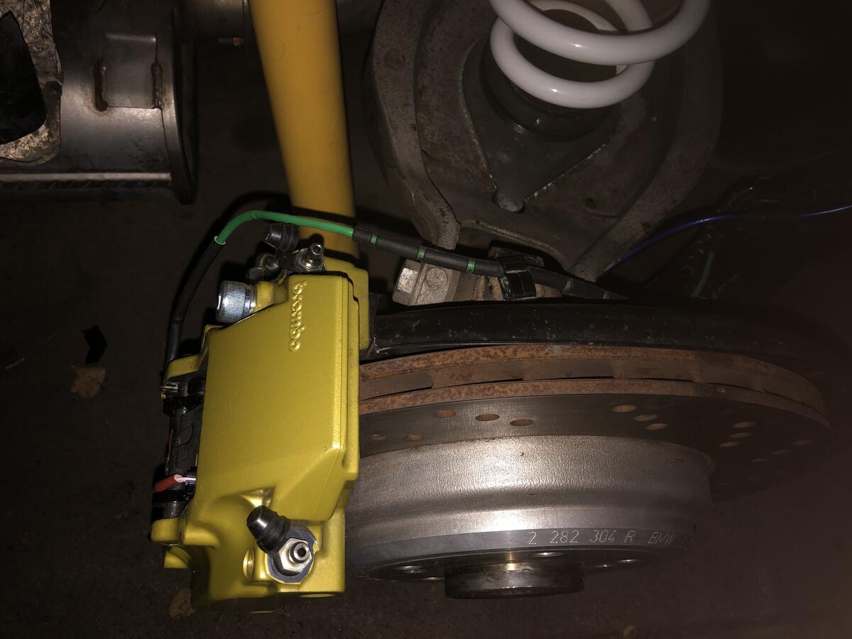

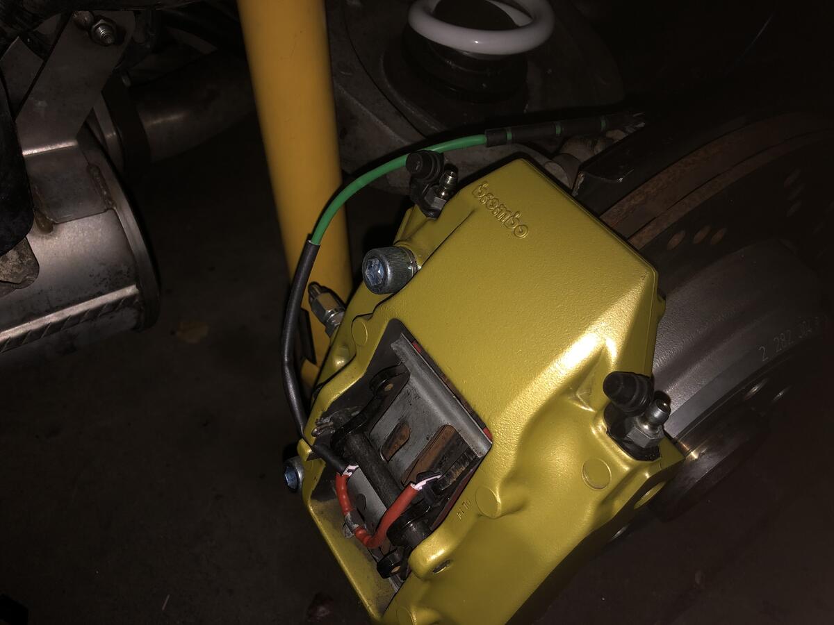

          I tinker with the pad sensor and came up with this. it looks pretty stealth and factory fit if you ask me

              You can just short it if you don't want the sensor or idiot light.
              Personally, I love having pad wear sensors and am doing the same as above.
                #82
                So this set up works by creating a circuit and ware occurs it warns us when the circuit is broken? so just connecting the wires will keep the light off? Thanks
