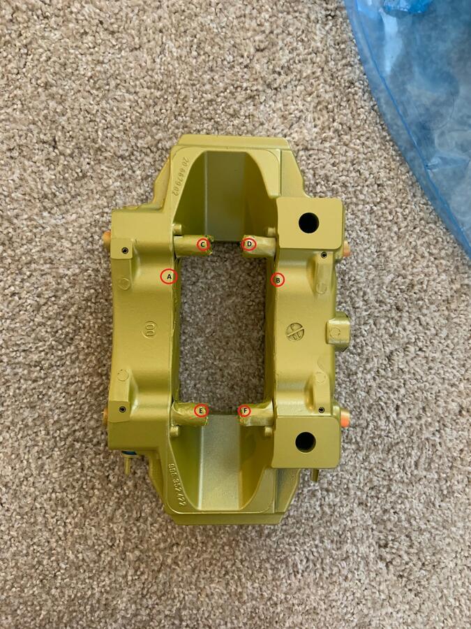

        I took some measurements and I think the pins in the callipers are not really an issue. Please see the image below with some references I added.
        A --> B = 61MM
        A --> C = D --> B = 19mm
        A --> E = F --> B = 19mm
        C --> D = 23mm
        Based on the above, the pins are centred in the rotor ditch of the calliper.
        Click image for larger version  Name:	Caliper.jpg Views:	0 Size:	139.1 KB ID:	37836
        I still have tape on the pins as I have my clear coat pending, but I am for sure not 3mm off as I saw when mounted for fit test. at least not in my case. the pins' length is symmetric side to side so if I center my rotor between them, I am centring the rotor in relation to the calliper monoblock.
        I hope this makes sense and is useful to others.

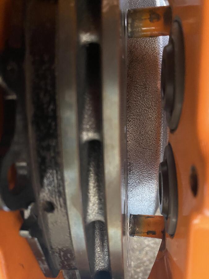

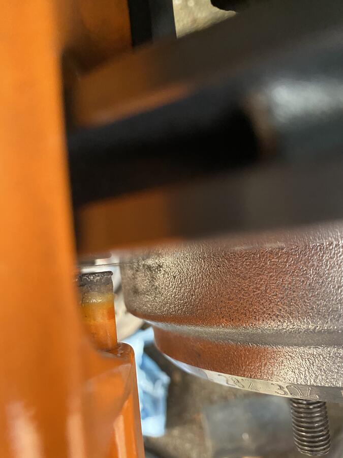

          So I am following this DIY to install my 996 brakes finally over the last couple days and have run into this issue regarding pin clearance on one of my rear calipers as well.
          I purchase a mismatched set of rears, but with correct part numbers for our application, and seem to have one carrera and one boxster caliper. The carrera caliper has perfect pin clearance on both sides of the rotor, however the boxster caliper does not.
          When I originally mounted the caliper with p0lar brackets it was a tight fit but I thought it was nothing serious. Turns out the outboard pins were binding on the rotor and I never noticed. After a quick test drive I find out that the outer face of the rotor has been damaged. A new rotor and new RallyRoad brackets later and I am trying to tackle this issue properly this time now that I am aware of what’s going on.
          Does anyone know what the minimum clearance needs to be? Even with the supplied washers from RallyRoad the outboard pins are very close to the surface of the new rotor, maybe only 1-2mm clearance. Is this enough clearance to be safe? Or do I need to continue to try to remove material from the pin?
            A --> B = 61MM
            C --> D = 23mm
            so are you saying this is a RR adapter tolerance issue?
              Click image for larger version  Name:	160CAD00-8664-4E10-91B4-BC9CA266451F.jpeg Views:	0 Size:	60.8 KB ID:	37880
              Click image for larger version  Name:	D5FC3288-2E87-42CE-BBE3-3105509E98F3.jpeg Views:	0 Size:	60.8 KB ID:	37879
              I think you will be fine. the rotor is 20mm thick, and the spacing between the pins is 23 (at least in my set, which is also from a Boxter S), so there is will only be 1.5mm on each side. with heat, the disc will expand radially only so you will be ok.
