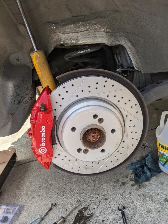

      Thanks. Your post on the old M3F was something i was trying to get a hold of. Site went down as soon as I decided to finally tackle the project. Thanks to TBone and all other resources here I was able to get my install on the way and I figured why not document it for others so they can avoid the pitfalls I went through.

        Hi there! I am new to the forum and this thread was the last source I found with all the important details (part numbers, etc) for this project. I am installing the rear 996/986 Brembo's to my Z4M along with front 135i BMW Performance 6 pot callipers.

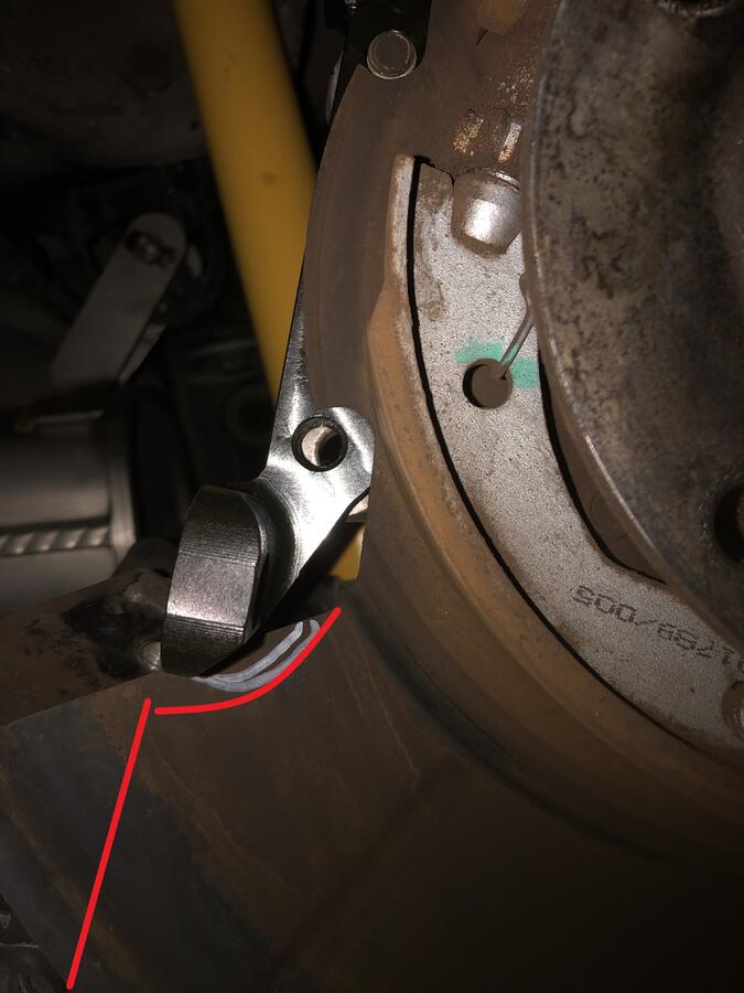

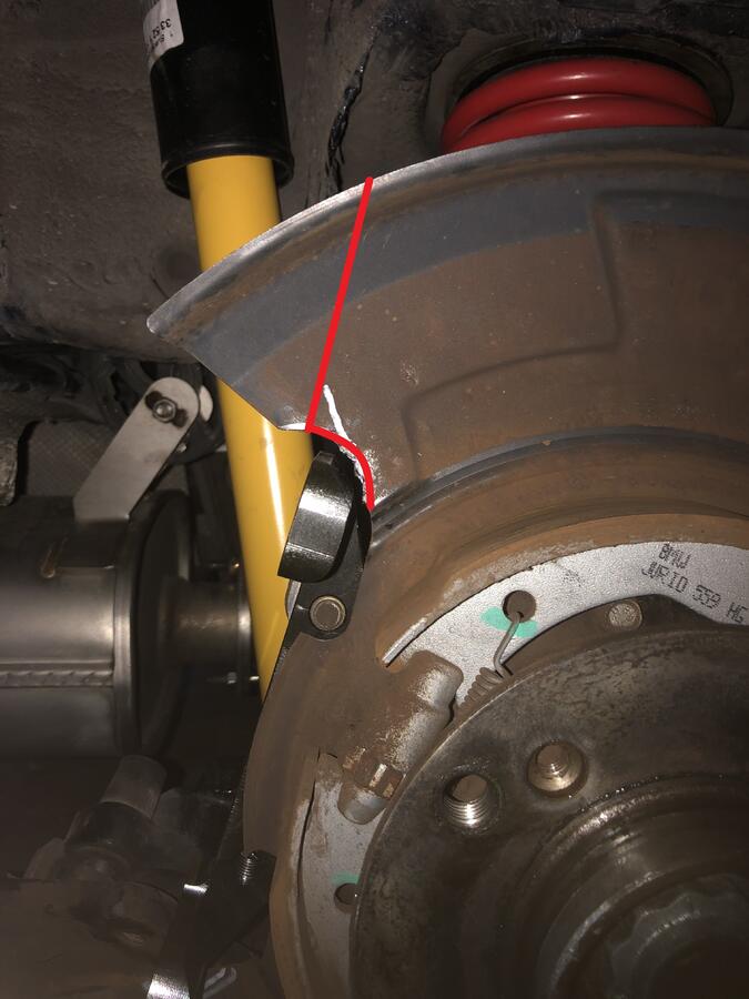

          Below you can see the share I followed for the upper part of the dust shield. at this point, I had cut just enough to bolt the upper section.
          Click image for larger version  Name:	Top-Cut.jpg Views:	0 Size:	58.2 KB ID:	36510
          Next, the lower part, I did this to avoid cutting too much and follow the pattern of the mounted calliper, as you can see it was not much what needed to be cut just to seat the bracket, but you do need to cut off some more for the calliper to clear.
          Click image for larger version  Name:	Bottom-Cut.jpg Views:	0 Size:	56.1 KB ID:	36509

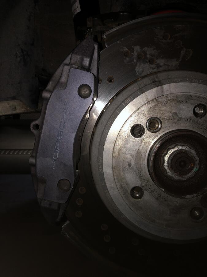

          After cutting the shield I was able to mount the calliper
          Click image for larger version  Name:	IMG_0029.JPG Views:	0 Size:	53.1 KB ID:	36511

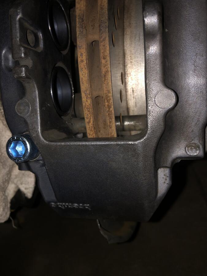

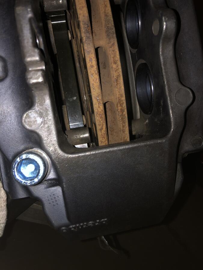

          So far so good, but then I also checked how centred was the calliper in relationship to the rotor, and I found that is 3.2mm too car inboard. the bracket kit comes with 4 washers but they are just 0.8mm thick, so for the calliper to be centered I would need to use the 4 washers on one calliper, so I need to get some stainless washers from home depot.
          See how the supporting pin of the outboard pad is contacting the rotor
          Click image for larger version  Name:	IMG_0031.JPG Views:	0 Size:	68.8 KB ID:	36513
          Here you can see how much clearance is on the inboard side (that gap is 3.2 - 3.3mm), I measured it with feeler gauges. in this very picture, you can see where the bracket seats to the knuckle, there it is where the washers need to be placed, ideally 1.6mm thick to put it in the middle.

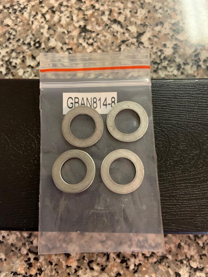

              Hi, these are the washers I was given. they are 20mm OD, 11 ID and 0.8mm thick. They don't seem to be inox, so I may just buy some from home depot. or ask Eric from RR to give me 4 more.

                Thanks for sharing. I never got any washers in my kit from RR. Looks like I need to make a trip to HD.
                Where exactly are you placing these? In between adapter and trailing arm I'm assuming?
                  #53
                  Correct. Between the adapter and the trailing arm mounting points

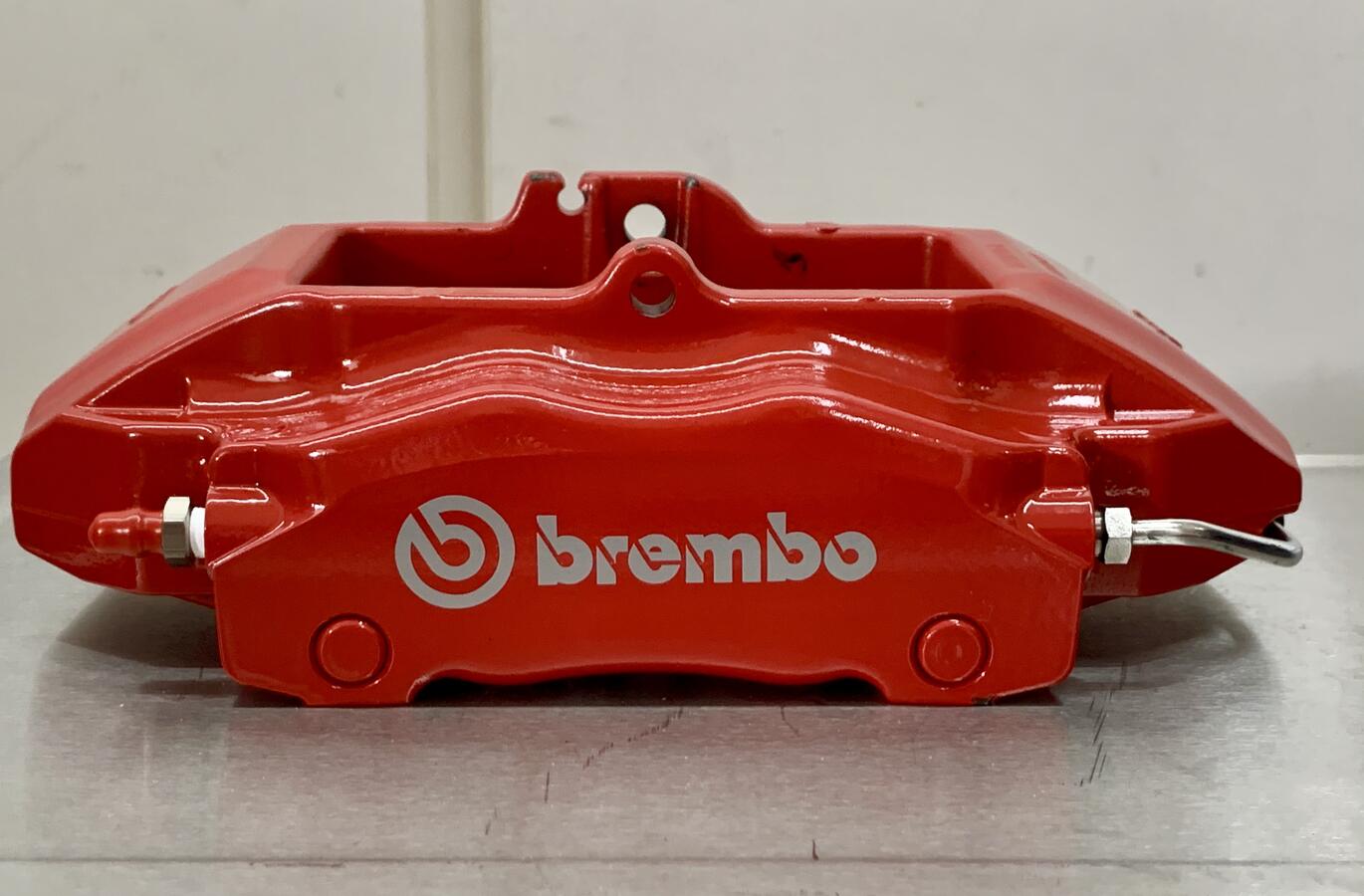

                        My Rally Road brackets did not come with those washers and my pin clearance was perfect. It looks like the pins are pushed inward too far on the face of the caliper. Most pins ( including mine ) are flush with the face of the caliper. If they were flush the front pin clearance would be the same as the rear pins.

                          threads are in the trailing arm, all things kept equal, 1.6mm are about 1.5 turns of the bolt, I don't think it matters, or... use a longer bolt but there is not much space between the other side of the knuckle and bearing. so it is no brainer. with heat expansion, I would be more concerned about the pins binding to the rotor.
                            Click image for larger version  Name:	image_2949.jpg Views:	0 Size:	111.0 KB ID:	37336
                            Click image for larger version Name:	IMG_E4422.JPG Views:	0 Size:	99.5 KB ID:	37322
                            Hi Json, that is a good point, I also checked how the pins are attached, and they seem to have a locating dowel pin (I assume so they don't come out), but without taking them apart, I don't know how much tolerance there is to push the pins more in than not, but in your photo is obvious your pins are flush, mine are not, and yes, I can tell the front pins (where the Porsche logo was) are not within the same location into the pockets as the backside. odd, however, both of my callipers are identical
                            What I will do is to measure the distance from the rotor face to the inner face of the calliper and see if their distance is consistent with the measurements I took using the pins.
                            when I collected the kit, Eric (Rally Road) did say I am giving you these washers if you need them to center the calliper in relation to the rotor. he mentioned variability, based on this it seems the variation may be in the calliper themselves if the pins are pushed-in differently from set to set.
                              #59
                              Yes they are held in place with dowel pins so that would have to be removed to move the pin. Makes sense there is a variance between different Porsche calipers, the washer is the easiest route. It's Gary btw...
                              Evolve Eventuri
                                #60
                                I believe Porsche uses the same part number for the Carerra and the Boxster, however the Boxster (non S) has a different offset on the rotor which can be seen looking at the face of the caliper. If the 2 pins are flush with the face, it will fit the M3 fine. If they are inset by about 2-3mm, they will not clear the rotor (just like the ones in your photos). Also, my RR brackets did not come with any washer as well.
