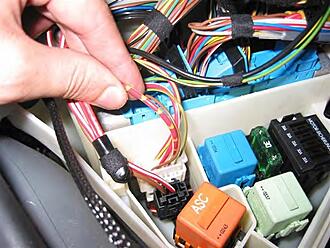

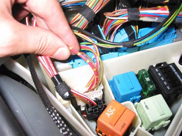

    Everything looks good on your wiring diagram. The Orange wire is basically a signal wire to turn on the relay so it has a very low amp draw. I personally installed a fuse on both positive lines to be safe. Use a 15/20amp on the line to the Red/Yellow ignition wire and the 30amp ( that came with the relay ) on the Yellow line from the relay to the Postive lug in the engine bay. Hope this helps...
    Yellow: Postive Lug
    Orange: Red/Yellow Stripes
