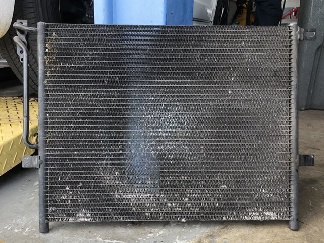

                      The condenser was the original factory 17yr old 181k miles unit and pretty beat up (pic below). The cooling system refresh involved brand new OE genuine BMW waterpump, new oem thermostat and both temp sensors, and fresh 90/10 distilled coolant + water wetter. Finally the AA underdrive WP and PS pulleys were replaced with stock units and new belt (ot: strangely my alternator one was still a stock unit) to hopefully help the flow since the 'power' pulleys were slowing down the WP and maybe affecting flow keeping up w/ the temps on track at high RPMs.

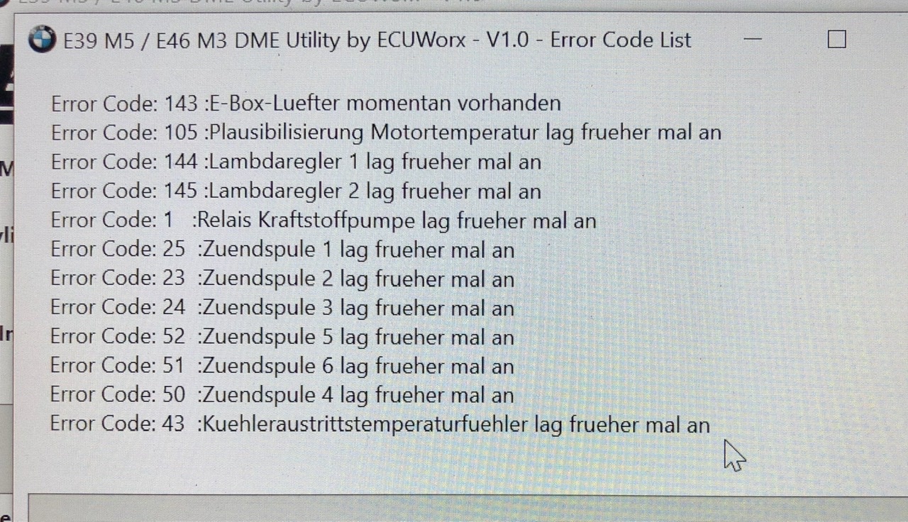

                      Also leading up to me taking the car to the Indy, I pulled these fault codes. One of them seems related to a bad t-stat, roughly translating to coolant taking too long to warmup to operating temp (also got the related OBD code P0128 for it), so this made my optimistic the t-stat was faulty and the main cause. Let's see after I test the t-stat and do my track day.
