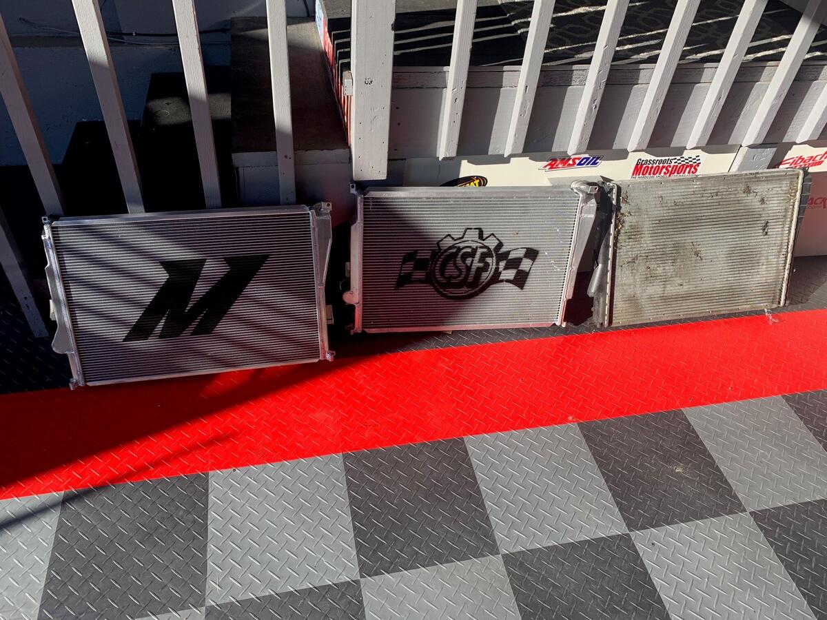

      Update on radiator # 3 - Mishimoto:
      A few days ago I finally had the time to put it in, but not before I took some measurements. It's most noticeable that is thicker than both stock and the CSF, about 1/4'' thicker. The fit and finish are better than the CSF as well. After the install I had to wait for the weather to warm up a little bit, and finally in the last couple of days we hit mid to high 80s.
      I took it to the same road I've been testing my car for the last couple month, trying to troubleshoot this problem. When the overheating problem started, I would replace a component, take it to the backroads on the warm day, and after several high RPM pull, when the oil temps get up to around 250F, and the motor is heat soaked, is where I would see the coolant temps creeping up north of 205F and the needle start moving to the right.
      Today and yesterday were totally different, the motor is running noticeably cooler, no matter how hard I tried with the Mishimoto, I couldn't get the coolant temp to go over 195F. I also noticed the heat dissipation is better, within seconds of getting off the throttle, the coolant temps will drop a couple of degrees, it certainly happens faster than with the CSF.
      I don't know when I'll take it out for another track day, but I'm 99% that the problem has been solved, and the CSF radiator was insufficient or defective.
      I'd also want to give kudos to ECS Tuning, who let me return the CSF radiator.
      I hope that helps to those of you that still struggle with the overheating issues, I'd like to think I resolved mine... FINGERS CROSSED!!!🤞🤞🤞🤞🤞🤞🤞🤞🤞🤞🤞🤞

        Or you could have simply used an oe rad for less and is not made in china.
        I also quite enjoy when people use the term defective when describing their experience with csf radiators. Seems they are all defective in that case.

              My guess is the OEM will be an improvement over the CSF, and might suffice for your needs, however, looking at the units side by side, and the analysis data from the R&D process shared by Mishimoto, I'm certain the Mishimoto cooling capability is higher than the stock unit.
