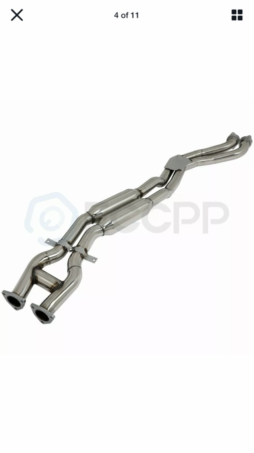

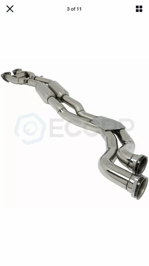

benzthis thank you for the clarification. Since were both from NY you’ve probably heard of Tesh from the monkey wrench. He does some great welding and exhaust work from what I’ve read. I was thinking of having him cut the small resonator in the section 2 and welding in 2 larger resonators.
here’s an example in the photos.
