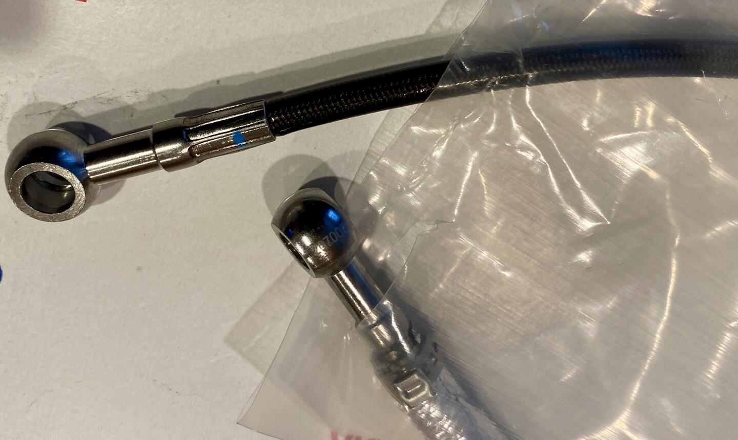

    Ok I called RE direct and asked about the covering. Said it hadn't changed and that it's a light "smoked" transparent cover. Said the photo lighting probably makes look different.
    Since I have always liked Rogue Engineering (from the initial start-up days when they split off from UUC) and their quality I went with their's. Made in USA, DOT approved hose and they usually over engineer their products. I am not so confident with ECS's product line contractors.
    Does seem all aftermarket very close. That was just my rationale. This is not my thread, sorry for thread-jack. So please continue on..

              Just to update about the Rogue Engineering hose, the one I recently recieved the cover is basically black.
