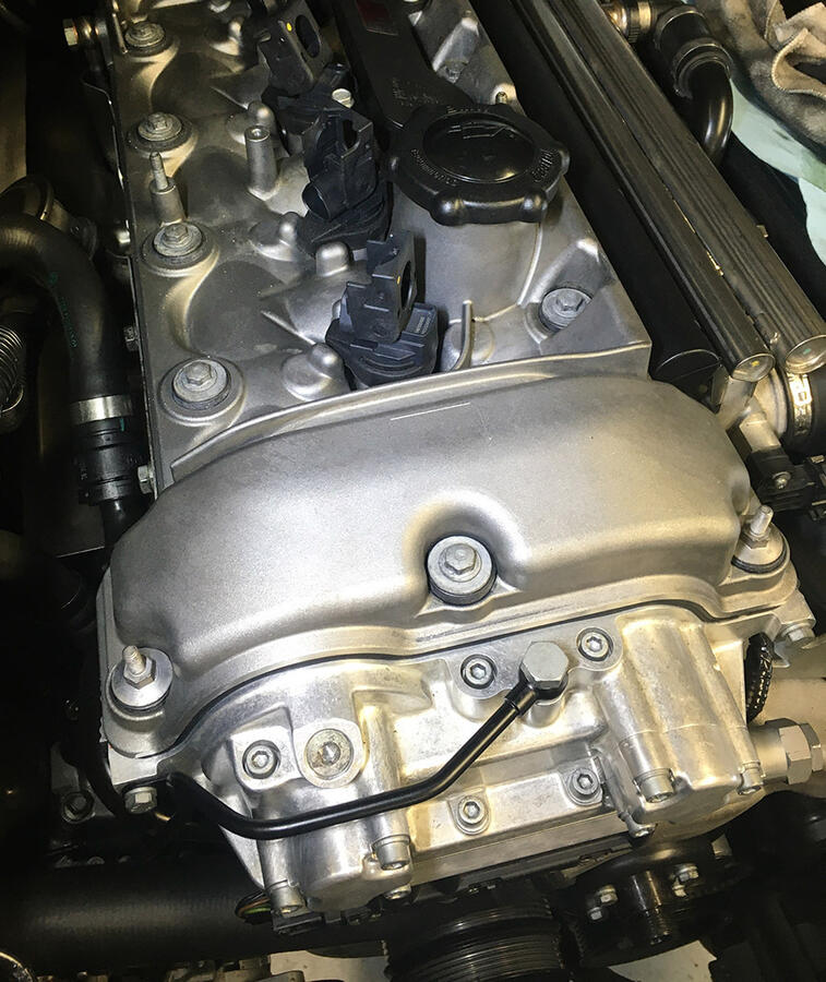

                  On 99% of vanos overhauls (unless a customer requests a different line) I install the revised Genuine OE BMW vanos oil line. I always suggest this part over aftermarket options as it fits great and with the additional mounting tab it will be a very reliable part. I have yet to see one of the revised lines fail. I also believe some of the original line failures are due to improper install during vanos overhauls. I've seen a few cars in which the top banjo bolt was torqued prior to tightening the vanos oil line lower mounting tab bolt which put additional stress on the line.
                  Revised Genuine OE BMW vanos oil line installed during a vanos overhaul.

                  With some of the aftermarket lines they rub slightly on the lower radiator hose, have different line internal diameter, etc. Also, I wanted to mention for those who have purchased the Bimmerworld vanos oil line, DOUBLE CHECK your torque spec for the banjo bolts. The instructions I've seen have said to torque the banjo bolts to 20 ft. lbs!!! This is incorrect and will lead to stripping threads. I have notified them of this torque spec mistake and they said they would correct it in their installation instructions. The correct torque spec for the banjo bolts is 115 in. lbs (you should be using a calibrated inch lbs. torque wrench for vanos related work). Also, be sure to use a torque wrench for the vanos to cylinder head bolts. I've also seen a local installer strip these threads on multiple cars.. The correct torque spec for these bolts is 89 in. lbs.

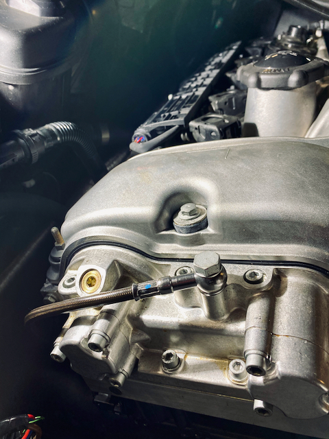

                      I installed a RE line when I did my VANOS bulletproofing recently. Fitment was spot on, I didn't notice it rubbing on anything. I don't think that extra clamp on the left VANOS bolt is really necessary other than peace of mind. If you let the aftermarket braided line flow naturally, it doesn't seem to stress the banjo fittings.
                      I torqued the banjo bolt to Beisan's number in their DIY and no issues. Good luck getting a torque wrench on the lower banjo bolt, though.

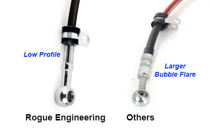

                        How did you get a RE one with the clear sheathing over the S/S braided hose? RE and ECS show it all black. Is their an option somewhere from them?
                        I like the clear (or even transparent blue over S/S).
                          I didn't even know there was a difference, I just ordered one from ECS and it showed up looking like that. Also came with 4 crush washers which was nice.
                            Actually the more I look at it that isn’t what RE advertises as their product. At least not now, the top fitting looks different from smooth low profile on both sides (edit* ok maybe not so different, could be lighting). You got this recently?
