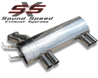

      Schmiedmann stainless steel sport rear silencer 4XØ76MM tailpipes with sharp cuts (not rolled) SCMM346R276NR - Fits on models: E46
      this looks like it could be the street with the tips you want
      That would be an insta-buy if it had SS rather than Schmiedmann tips, but yeah that’s basically what I want, 2.37” or not (doesn’t seem to really matter for the muffler). I’ll contact Schmiedmann and see if they’ll make a SS branded one as another poster suggested. I buy way too much from them so maybe they’ll listen

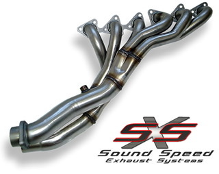

        Just some clarification, headers for this car aren't 60mm. The biggest parts of the entire system get up to 60mm (in sect 2 I think), but headers, other than full stepped 2.5", are like 2.16" or 55mm.

              With the 2.5" full setup, you'll see gains on NA cars that are airboxed/cammed ^

                  The one listed above is a great price considering it is made by Supersprint for Schmeidmann as someone stated. I think Schmiedmann logo looks fine with the "S" logos and the $200 savings is a plus. Hamann and Evolve also have their exhausts made by SS. There does seem to be a slight difference between the SS Street and the Schmeidmann muffler and that is the routing of the pipes where it connects to the section 2. On the SS Street, they are straight. It appears that the chamber portion of the Schmiedmann muffler is smaller than the SS Street and larger than the SS Sport. Sound wise, it could be between the Street and Sport.
                  Along with the 2.5" internal diameter and slant cut tips, they should also be able to make it with the black chrome tips rather than the standard chrome tips. I think the black chrome version looks quite good on a light colored car. The custom Supersprint muffler will probably be a bit more expensive the Schmiedmann muffler.

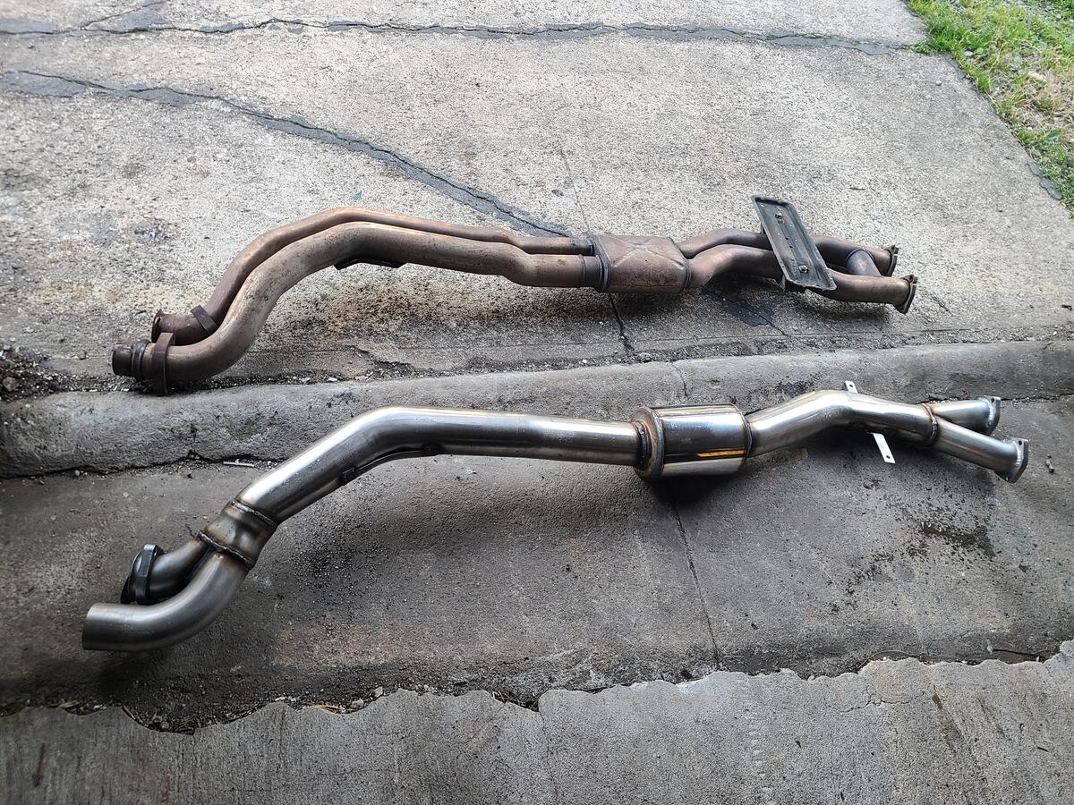

                              ordered monday, arrived yesterday morning, installed by the evening. time was not wasted.

                              i do have a follow-up question for those that know this. i noticed that when installed, it gets VERY CLOSE to my driver side rear axle (1/4"-1/2")
                              not knowing how close my OEM Section 2 was or wasn't, i'm curious if any of you have experienced this?
                              i am able to physically move my Section 2 up and it hits the axle. i haven't driven the car yet but i assume once i get on the road, i'll start to clunk.

                                You can fiddle with the sec 2 rubber hangers. If you slide them outward-most in their slots (in the crossbrace), they won't be quite as tall thus lowering the whole piece slightly. You can also shim the crossbrace(s) with washers to lower the piece. You might need to correspondingly lower the other crossbrace as well.
                                Also what muffler do you have? Sect 3 fitment will affect sect 2 fitment (unless sect 3 is stock).
