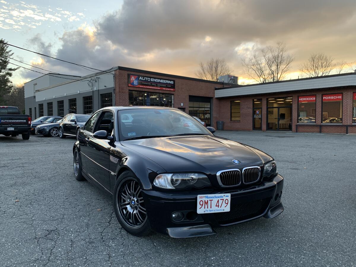

    Where I got it installed -
    My homie Emil at Auto Engineering installed it and I can't recommend him enough. He's been a close friend since elementary school and is the best in the area - over 10 years of working on BMW's. I love Auto Engineering as well and bring my car there for legit everything: from oil changes to Rod bearings to VANOS to this. Just want to shout them out as I really love them over there!

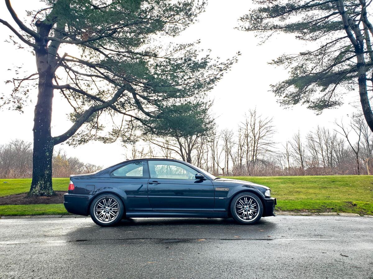

                    great write up. so is it safe to say that the front is slightly lower than the rear? Thats always a concern of mine when getting these types of kits.
                      The photo looks like the front fender opening is slightly higher than the rear, which is how it's supposed to be I think. OP, if you get a chance, it would be informative to know the center cap to fender distance to see how close it is to the recommended 13.5"/13" I see around here.
                        Second this. That would be great info to have.
                          Difference in gap should be about .5". Eibach springs increase that gap with a drop of -.06" Front & -0.9" rear. H&R does the opposite, for example, at -1.2" F and .5", eliminating the natural differential in stock height.
                          Not as much travel is required in the rear as the front. The rear spring is stiffer to catch up to the front (it's a lot stiffer, but some of that is reduced by its location, inboard, on the lower control arm vs. front macphe strut springs' outboard location).
                            Ride height from center cap to fender: just around 13.875" Front AND Rear

                            If you use the stock top mounts, the only way to lower the car is by losing travel. The better way to lower the car, is to move the fixed connection (mount) higher up. Thus, the car goes down without losing travel. That can only get you about 5/8-3/4" though. You can get some more by removing unnecessary spacers/washers (if you have any). I've managed to get almost an inch which means I've not compromised my struts (B6) even though I'm at the popular 13.5" height.
                            Got it! Well it seems like I won't need those I guess sitting at 13.875? I really don't mind the height at all and happy with the ride!
                            Apparently not after I measured it tonight! Same height! 13.875" - wild.
                            See above guys! thank you for mentioning this, happy to help out!
