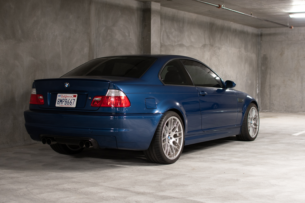

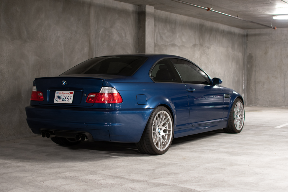

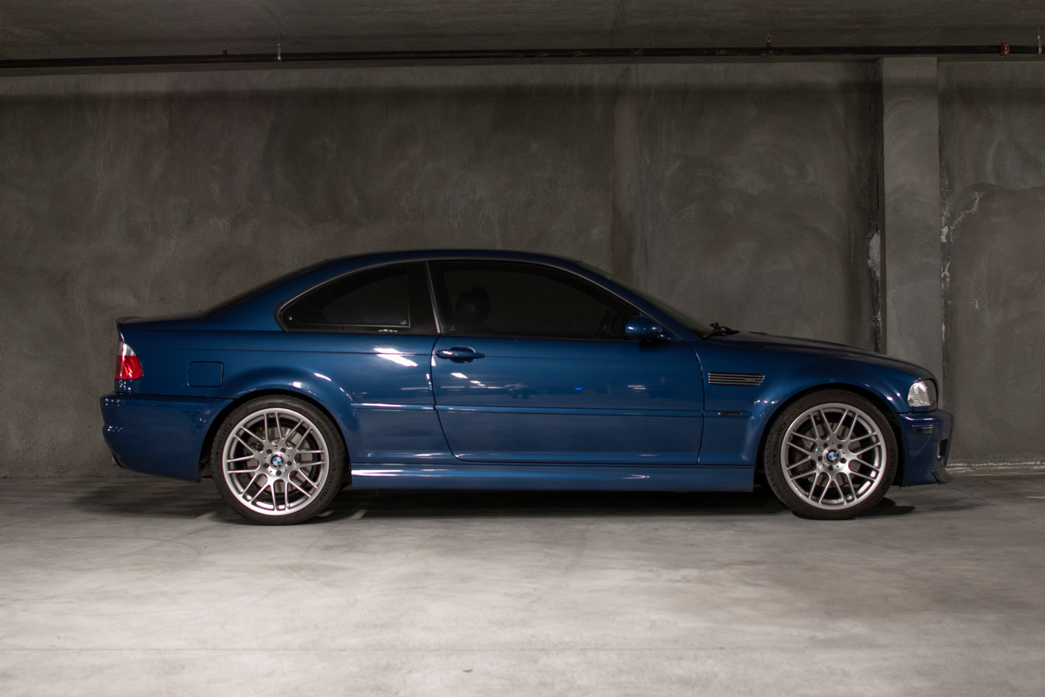

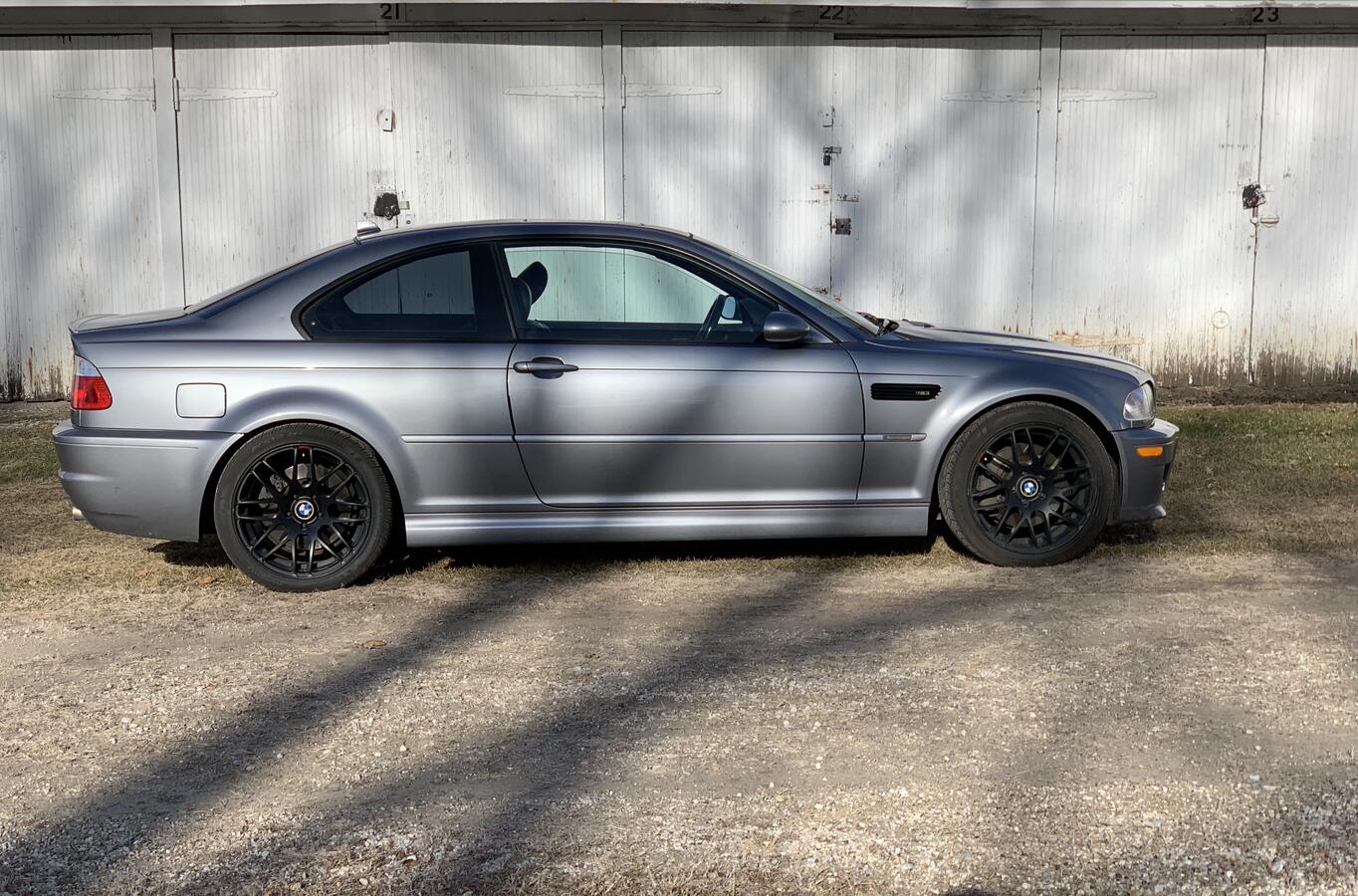

          Just installed this same setup on my car and took some pics. Tried to keep the angles/lighting/etc as consistent as possible. The pics were taken hours after I installed the springs, so I'm expecting the car to drop more with time. I'll take some more pics in the future. Top are before and bottom are after.

          Click image for larger version  Name:	After Rear Three Quarters.png Views:	29 Size:	795.1 KB ID:	76395
          Click image for larger version  Name:	Before Side.png Views:	30 Size:	813.6 KB ID:	76396
          Click image for larger version  Name:	After Side.png Views:	29 Size:	784.6 KB ID:	76397
            @heinzboehmer It looks really tight. I just purchased the B12 so Im hoping for a very similar drop. Btw did you use any of the thicker spring pads or strut reinforcement plates?
              I've got the BMW reinforcement plates up front. Besides that, everything else is stock. I do have CMP solid subframe raising bushings in the rear, but those shouldn't affect ride height.

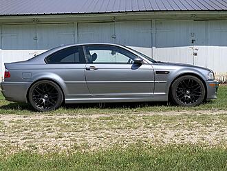

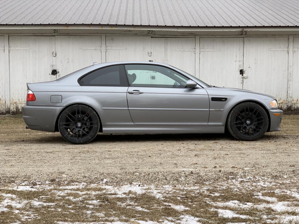

                The B12 will be a little higher... not much but will clear a dead possum, while this koni set up is less likely to.
                The B12 gives the look of reversed rake...nose up.
                I switched from B12 to koni the day after Christmas.
                If you haven't installed the B6 dampers, I'd encourage you to send them back and get Konis.
                I used E30 M3 front swaybar links but I don't think they are necessary..

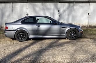

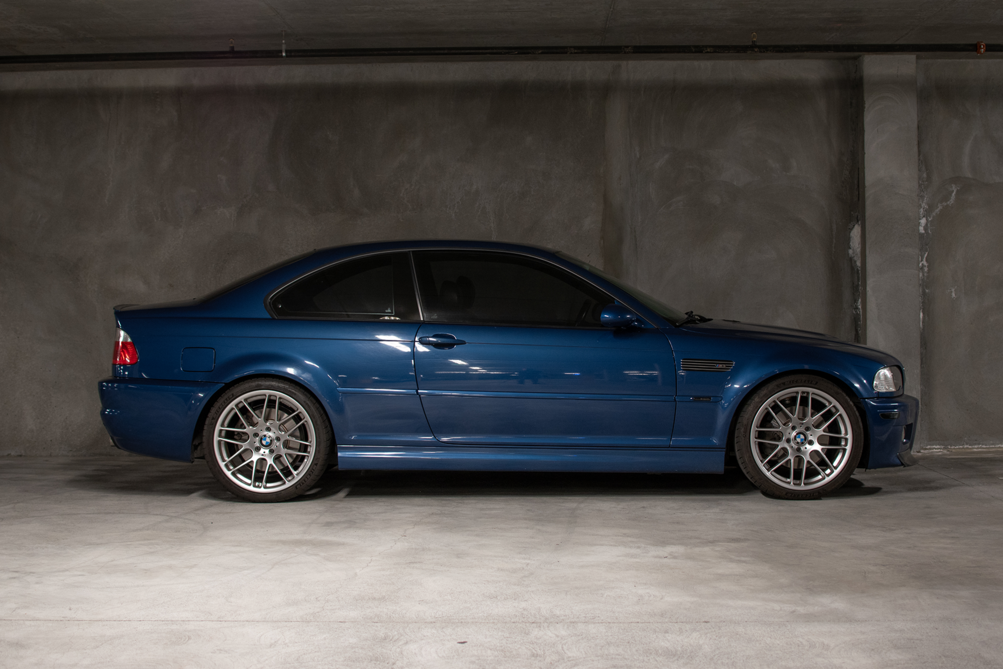

                  Click image for larger version  Name:	65D3B48D-A223-4A87-BAC5-5880D4513F46.jpeg Views:	0 Size:	210.3 KB ID:	76773 Click image for larger version  Name:	BFD18A8B-44F3-4A14-85AB-AA1623284492.jpeg Views:	0 Size:	234.7 KB ID:	76774 Click image for larger version  Name:	B8F54530-0DC3-431D-9DE5-B2BFD45BFA7D.jpeg Views:	0 Size:	225.6 KB ID:	76775 1st is Koni/eibach. Then koni rear B12 front. Then B12
                    THanks all for the very informative pics and replies. Ive heard of the B12 being less popular especially with the front shock travel. Although i have also read very positive reviews on it which seems confusing. So I'm hoping its a matter of subjective feel and i'll try it out at least for a year.

                      Most people don't compare these things in controlled environments nor have the qualifications or have bias so opinions are all over the place. I have it on mine (and I wouldn't call myself qualified since my experience is limited), but the bumpstop issue is overexaggerated and comfort wise feels fine, not harsh. The only complaint I have is at high speed going over very uneven surfaces (what feels like a mini 5" ramp/jump on the highway) the car doesn't feel planted and does become unsettled (which I do not think is acceptable and I don't know if it's because the spring is too soft or the shock to stiff or what). I never noticed it since traffic is so bad in LA but with the shutddowns, 80+ is normal and our freeways are exceptionally messed up, feels like there are literal jumps in the pavement. I'd love to see how other setups manage ( I think my rear camber is way too positive so maybe that is making it worse. Canyons and spirited driving though is very nice and I have no real desire to change it up unless I'm going super high end. If someone wants to do a back to back drive sometime with mine vs koni/eibach, I'm down.
