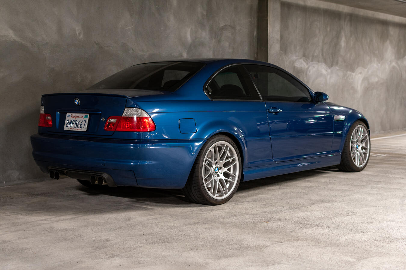

    Just installed this same setup on my car and took some pics. Tried to keep the angles/lighting/etc as consistent as possible. The pics were taken hours after I installed the springs, so I'm expecting the car to drop more with time. I'll take some more pics in the future. Top are before and bottom are after.
    Click image for larger version Name:	Before Rear Three Quarters.png Views:	28 Size:	802.3 KB ID:	76394
    Click image for larger version Name:	After Rear Three Quarters.png Views:	29 Size:	795.1 KB ID:	76395
    Click image for larger version Name:	Before Side.png Views:	30 Size:	813.6 KB ID:	76396
    Click image for larger version Name:	After Side.png Views:	29 Size:	784.6 KB ID:	76397
    Did the car end up dropping more with time? Or was that the final ride height?

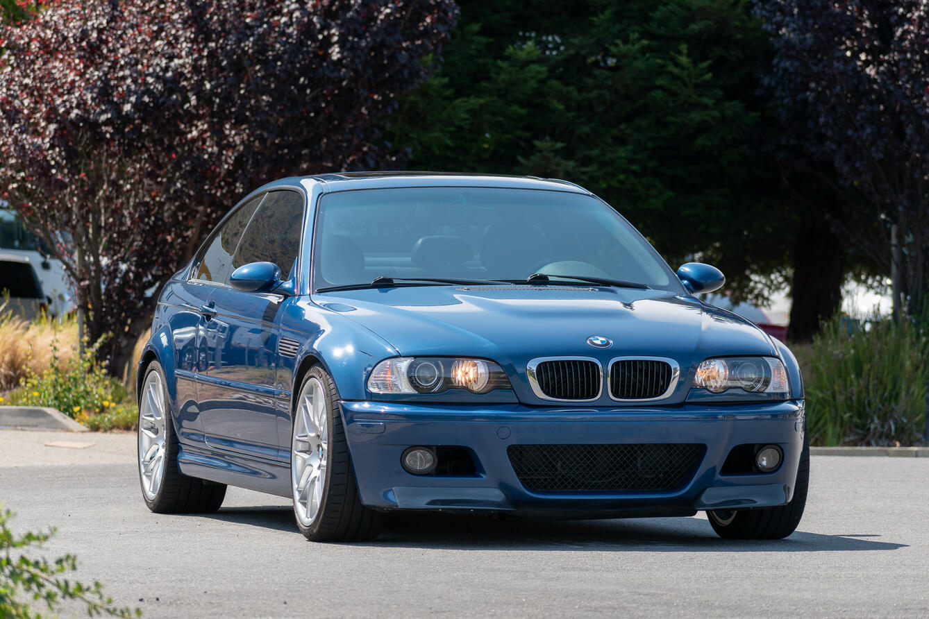

        Yeah I never did update this huh
        I think the car dropped down slightly more, but I can't find too many recent pics that showcase it well. Here's the two best ones I found:

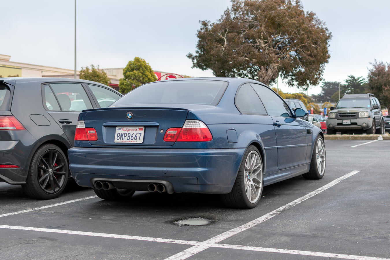

                Retook the pics. Drop is super slight, but you can see that it's a little bit lower than before (most notably in the front).

                  I noticed when photodocumenting mine, the height of the camera, and the angle of the incident light can make the gap look different in dimension.
                      Yeah, that's true.
                      I did have my camera on a tripod and tried to both park the car in the same spot and have the camera in the same spot. Definitely not an exact science though. Having other cars around meant I couldn't place everything in the exact same spot, for instance.
