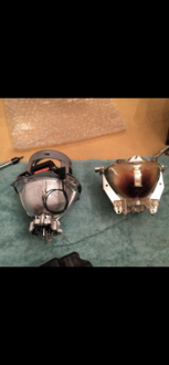

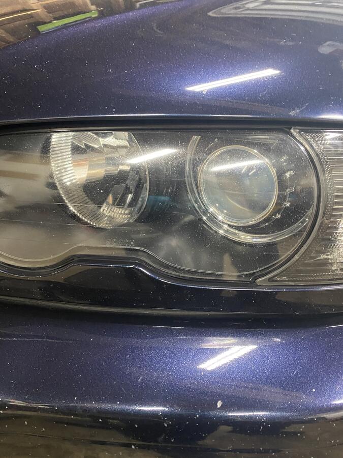

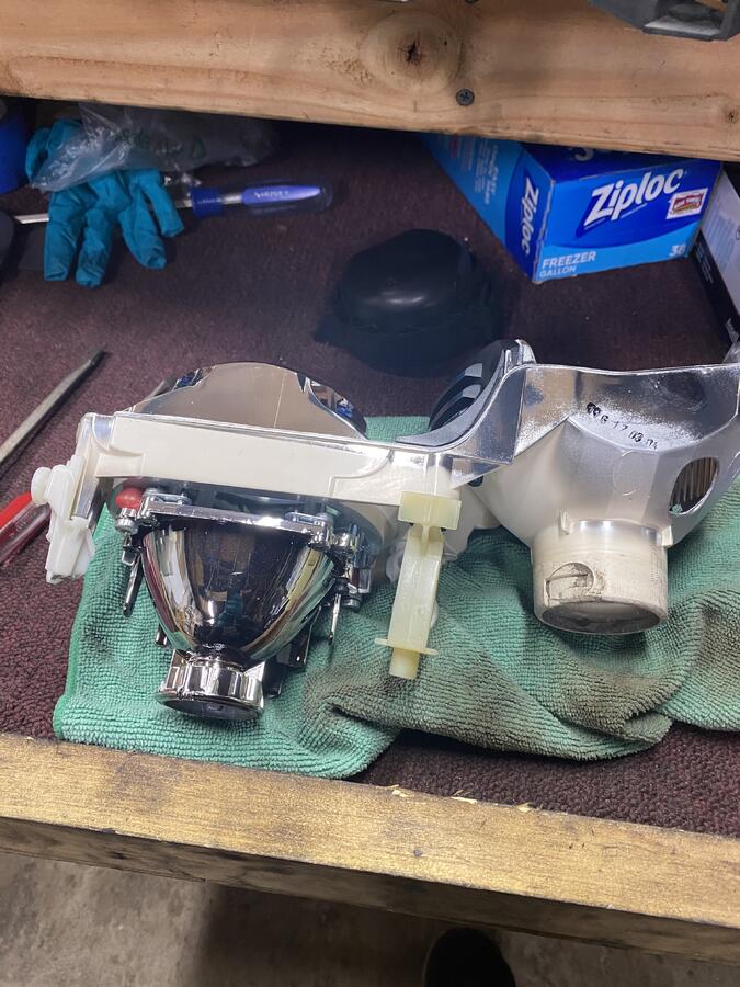

          Interesting this topic just came up. I too am doing headlight work and have the single projector. I owned a ZHP that had terrible light output which turned out to be the burnt ZKW bowls. When I replaced the bulbs with the ones you have linked as well as doing the retrofit listed on lightwerkz website. The lights became brighter then Acura lights. I loved them. So much so that I purchased the kit again expecting to have more burnt bowls in these. Yesterday when I disassembled my headlight I found no burnt bowl, thankfully. However what I did find is my projector lens was very foggy. Foggy with what?... no idea. But I figured what the hell, I’ll clean them back up and toss them back on the car and see if it helps. My lights have easily doubled in output. I didn’t snap any photos of the cleaned lens back on the car but you should be able to see the bulb if you look closely. You can see on mine it’s not visible. dug up photos of the burnt bowls
