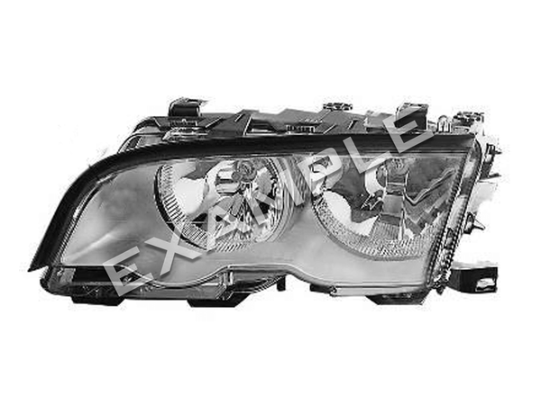

              Headlight upgrade kit with HID bi-xenon projectors for the BMW 3 E46 with ZKW halogen headlights. Guaranteed improved light output! High-quality retrofit parts
