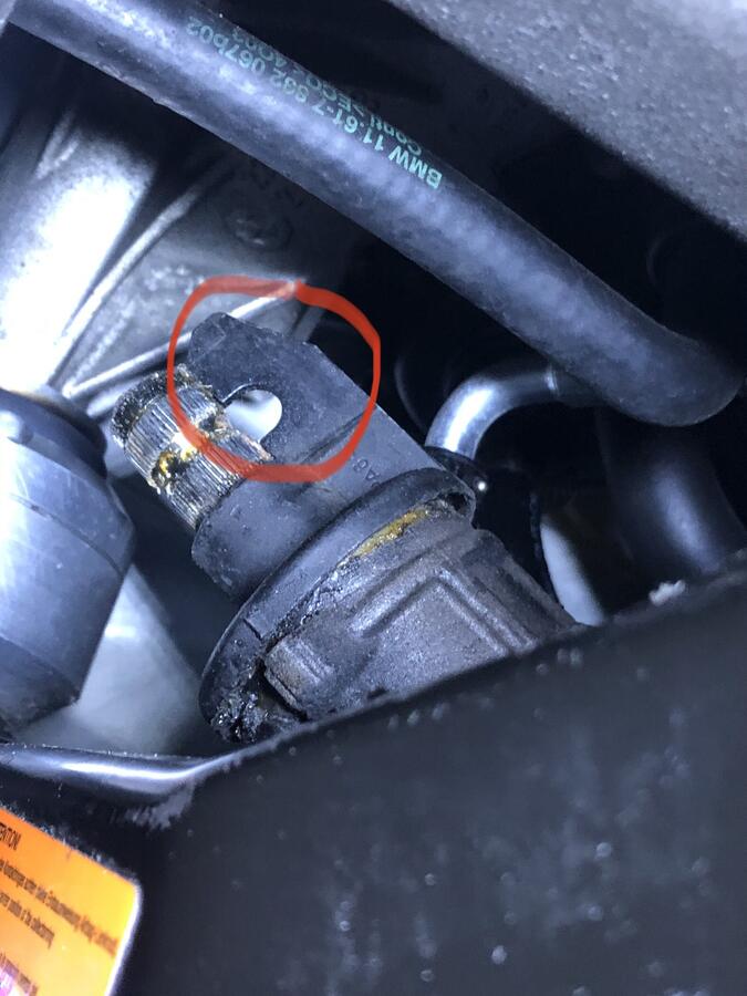

              Ok, so when you installed the Condor coupler, what did you do about the plastic piece that aligns the factory coupler...but prevents this joint type coupler from sliding into place?
                Had my mechanic do the install mate #softhands Can’t say what was done with that piece. Good luck!

                    Ahhh, ok, I usually can't afford a mechanic-lol. Anyone else have any experience installing this type of coupler?
