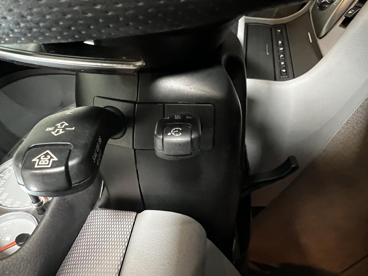

                    I just did this over the weekend, THANK YOU for this write up!
                    if you want to tap into the two wires without cutting, I recommend these…very solid connection.
                    I did have to trim the bottom inside the lower cover AND the bottom of the the stalk base to get the clearance needed, but I’m not worried about it.
                    I also just removed the foam/metal piece altogether by cutting the plastic rivets they are popped into, made this a much shorter ordeal.

                      Looks fantastic, nicely done!
