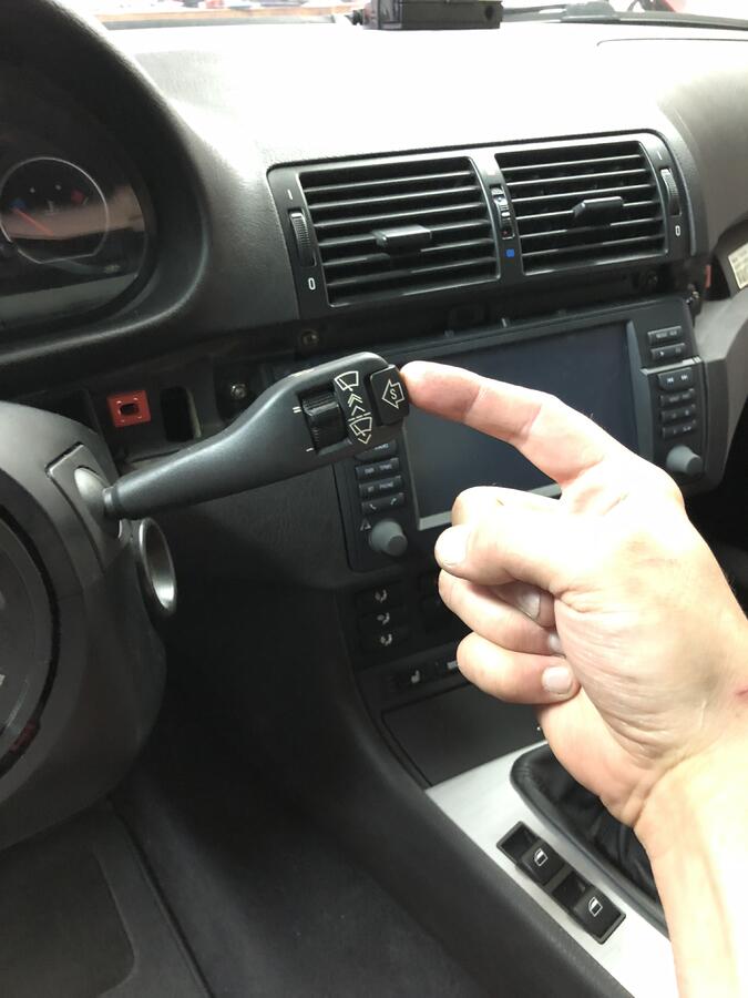

    All Finished
    Plug everything back in
    Put on your lower trim
    Plug back in your battery and turn your car on, test the switch. Just push up or down to enable cruise, you should see a light come on the dash
    Enjoy the cruuiiiseeeee
