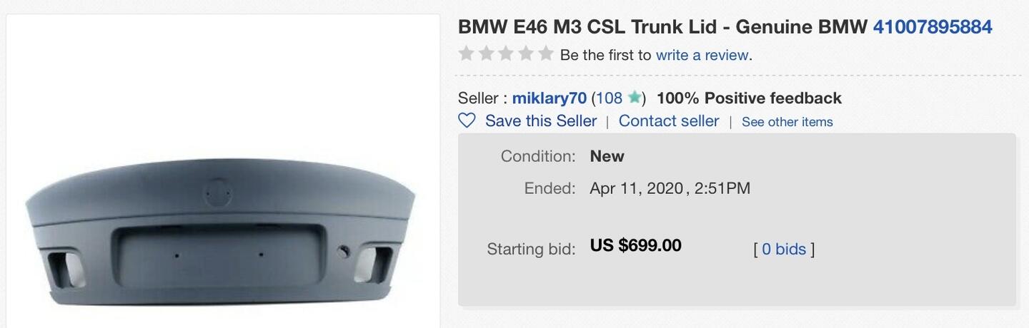

    Damn that was a good deal!!

      That is a good deal, if it is a genuine CSL trunk. The seller has a 100% rating... 🧐🤔
        #33
        Yeah, I’m sure it was legit, it sold already. Seller feedback was good too, I would have paid for shipping on that piece

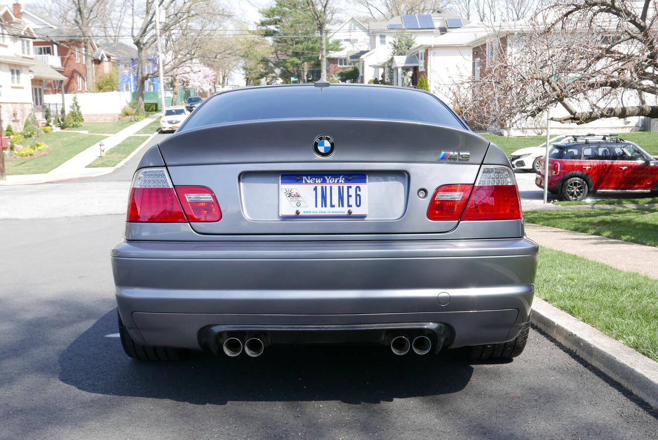

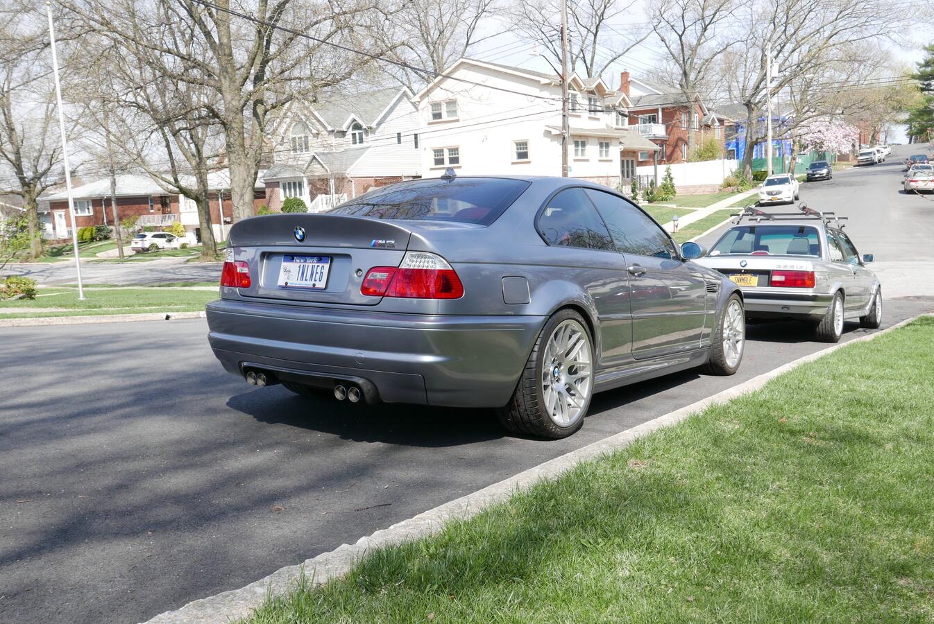

              I have a Vorsteiner trunk on my M3 right now and ive had it for many years but its time to get an OE CSL one and sell the Vorst one.
              already ordered one with the CSL lid liner too. No idea when it’ll get here from BMW Germany due to the current situation.

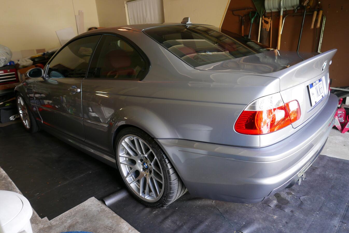

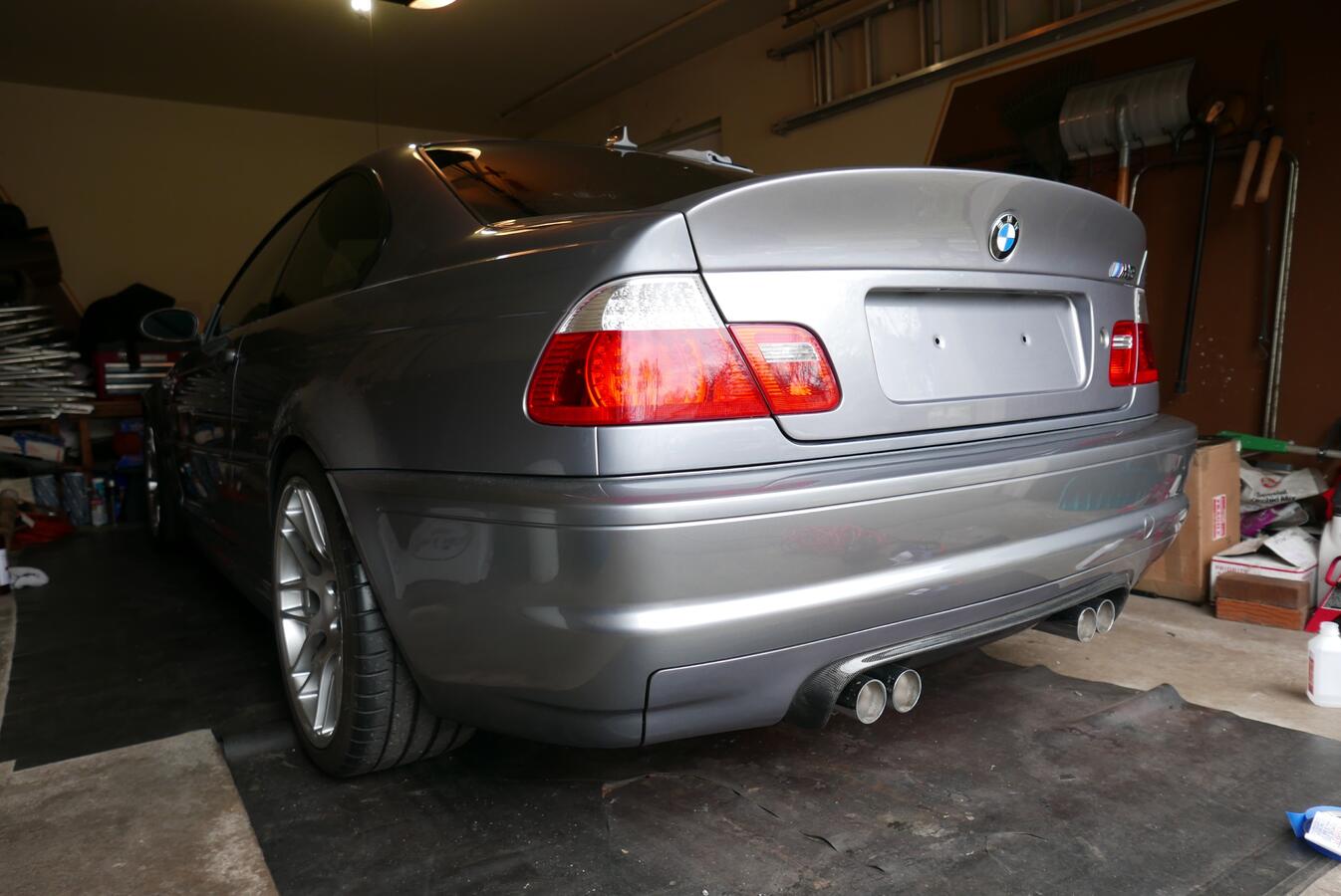

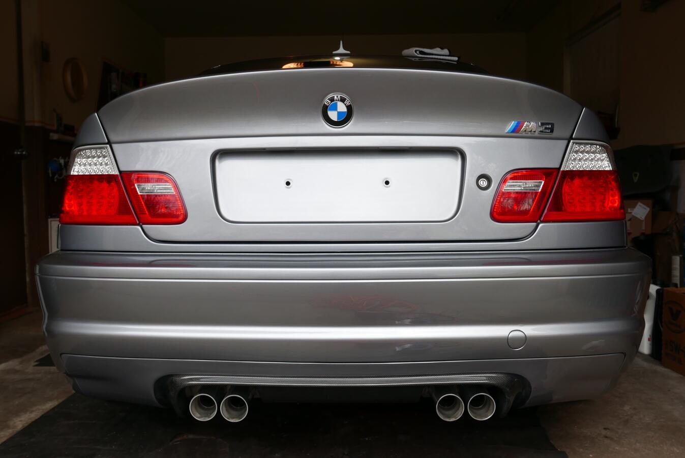

                        Have a Vorsteiner and very happy w the fitment. Would’ve gone OEM but a friend sold me this new, never installed VCSL. Weighs almost nothing!

                            Looks really great if you ask me. Perfect fitmentI think. Am I correct that they stopped selling any e46 stuff?

                              yeah i think they stopped years ago. Sucks bc their products seem top notch compared to some other replica stuff coming out now
