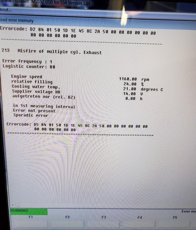

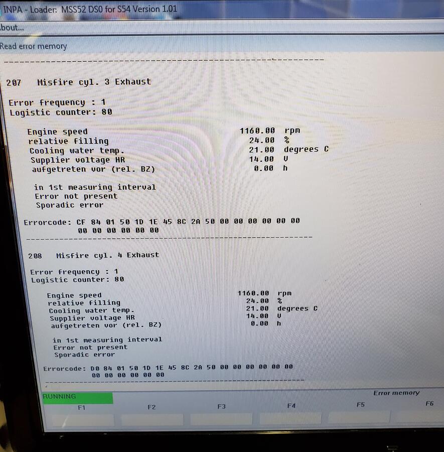

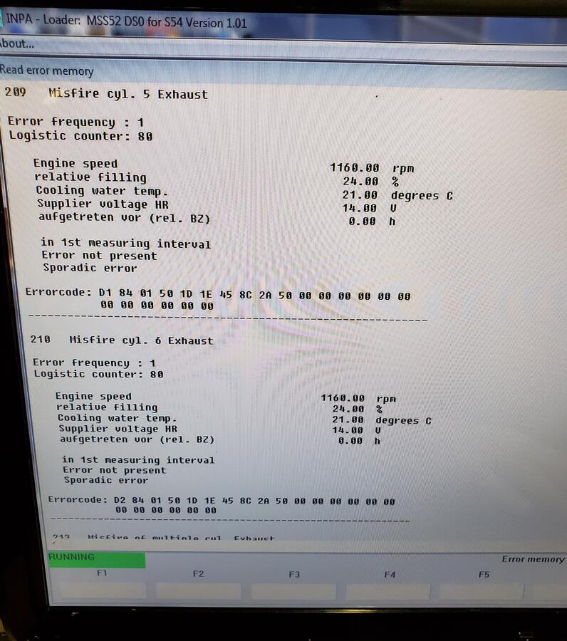

    So after my car sitting for a few months and a full Beisan Vanos rebuild, valve adjustment as well as new spark plugs I started it up.
    Unfortunately I am unable to drive it as there is too much snow but after idling for a minute or two I shut the car off and read error codes, there were no codes present before I stared the car.
    I had a multiple misfire on all 6 cylinders. I cleared the codes, started the car and again let it idle for a minute or two. The error codes were gone at this point.
    Not sure what to make of that.

    Any symptoms? Did you run the vanos adaptations yet?
    Check all the electrical plugs? (vanos, maf, O2, etc)
      All plug connections are good, I did NOT reset adaptations before starting the car. I did reset adaptations after I cleared the misfire errors and then started it the 2nd time and no errors were present.
      Edit: Also the first time the car ran a bit rough, although it's been sitting in a cold garage for months. When I first started the idle RPM was at about 1100, the 2nd start the engine smoothed out and idle was around 950, I figured this was simply running closed loop vs. open loop on first startup as the engine had dropped 2 warm up lights during first idle sequence.

          This is normal after the vanos has been removed from the car and cleared of oil. There is air in the vanos system once it is opened and in the first few seconds after the first startup this results in rough running/misfires. Once oil pressure has built up and the system has vented the idle will stabilize.
          You should still run a vanos test (after first drive and when car is warmed up) to verify full vanos function.
