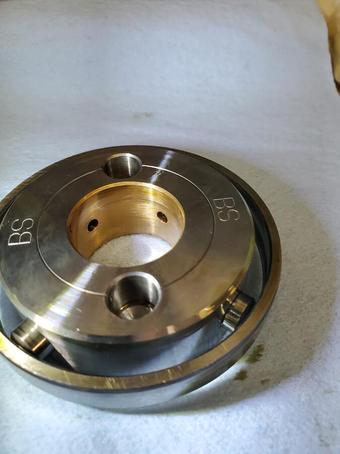

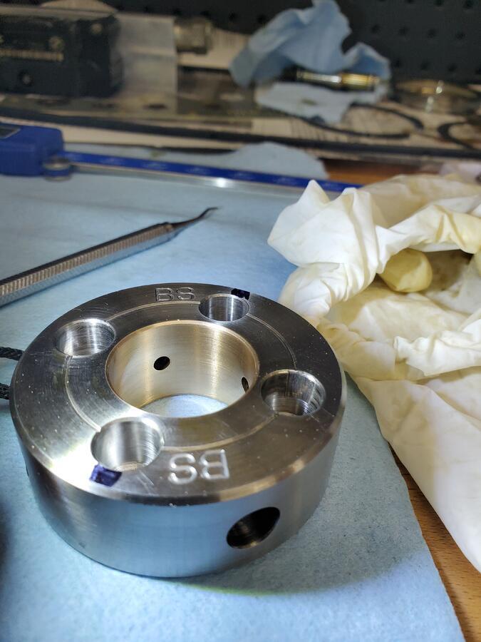

                        Cubie, a few things I wanted to ask
                        • Did you confirm the Beisan disc has two heights as the OE?
                        • In your photos, the Beisan disc seems to be scored, or is it just reflection?
                        • are you sure on the cup springs measurements, it is known that the S62 are slightly thicker, hence why they are used to reduce chances of chatter or rattle. this is even called out on the Beisan procedure
                            I did not ask Raj if Beisan disc has two heights, Raj did tell me the "A" and "B" on on OE discs had nothing to do with dimensions but maybe with different production runs/lines.
                            The inner portion had two distinct lines,likely from the oil jet, why there was two distinct lines I am unsure of. However it would appear they correspond to two holes on the shaft, not the main holes in line with the "oil groove" but the two smaller holes present on the shaft.
                            Are the lines on the inner portion what you are referring to? Those lines can be felt when a pick is dragged over them.
                            The S62 plate is indeed thinner than S54, that confused me until I saw that the S62 cup springs look over twice the thickness of S54 cup springs. I wonder if the thicker spring reduces chances of rattle due to harmonics? I re-installed my S54 springs for better or worse.

                            The two heights is nothing you need to ask anyone, just have a look at the disk, on the back side you will see a slight step, this step is about 0.15mm. see below.
                            Towards the center, the OE disk gets thicker / taller, I measure 20.15 there, whereas after that step is 20.00 (using a digital caliper, does the Beisan disc have this "feature"?
                            Click image for larger version  Name:	OE disc back.jpg Views:	0 Size:	51.3 KB ID:	93888
                            By the look of your photos, the Beisan disc seems to have some scoring on the inner surface of the bushing, the OE is silky smooth by the looks of it. did you inspect your shaft to ensure it was perfectly smooth without scoring?
                            Click image for larger version  Name:	image_22259.jpg Views:	0 Size:	54.6 KB ID:	93890
                            Click image for larger version  Name:	image_22263.jpg Views:	0 Size:	66.9 KB ID:	93891
