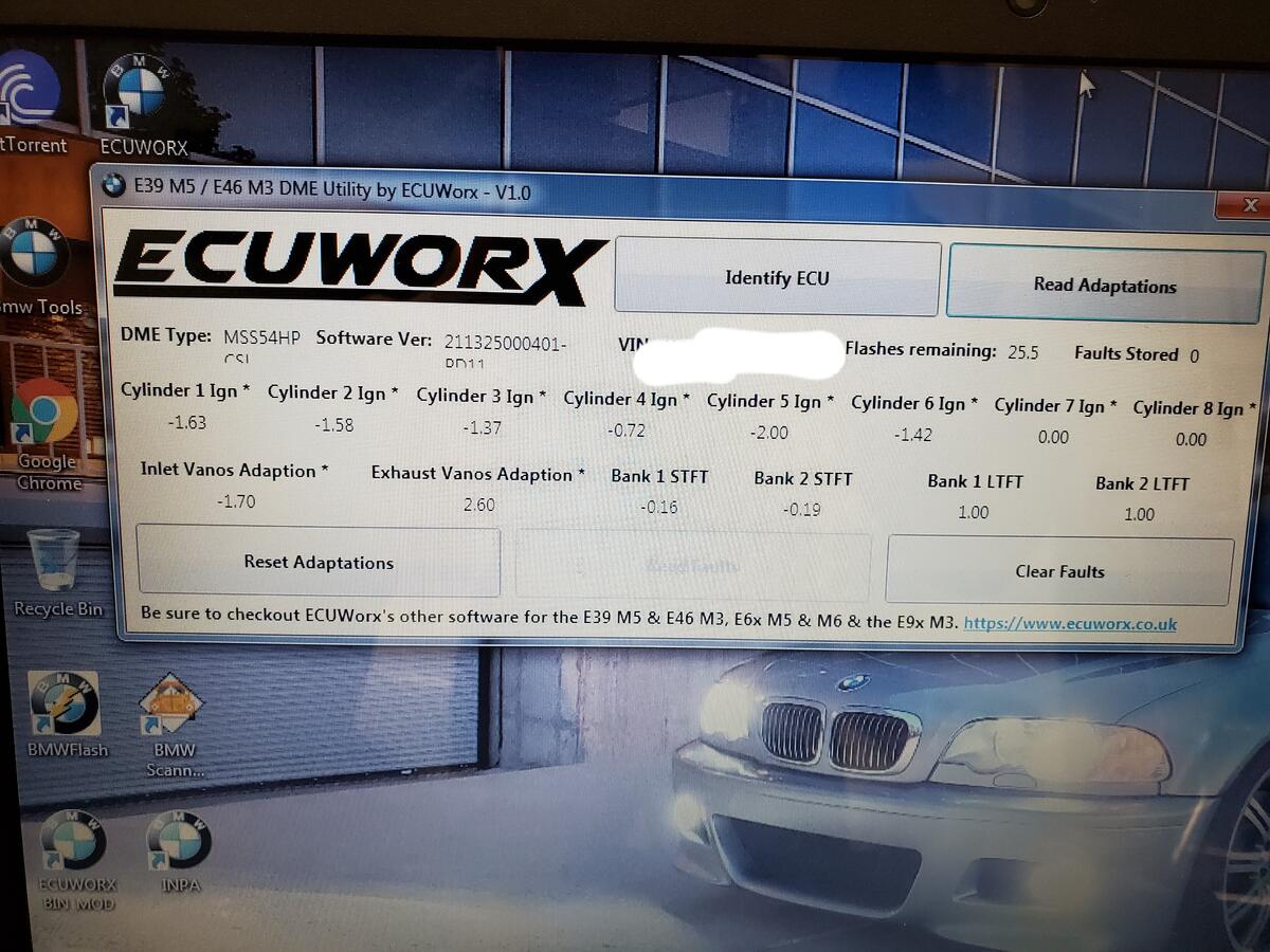

      The amount of EX cam advanced you saw is way more than the DME can adapt (that you wanted to read out) to get it in normal operation, therefore it is not caused by timing drifted. I bet on this.

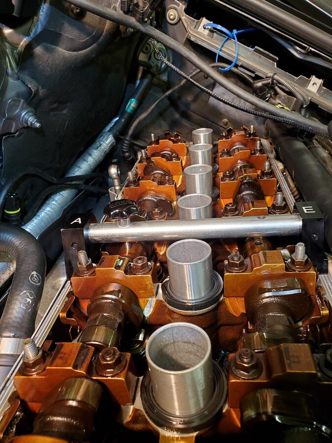

        I installed the vanos and turned engine over 4 times with the same result of EX cam advanced. It is far enough that the pin won't even go into the hole, the IN cam is perfect with bridge flat.
        Wondering if I need to re-time and how this happened.
        I also pulled my adaptations, they have not changed in regards to vanos since my original read after I installed the vanos the first time.
        I am nervous looking at how far off my EX cam is at TDC 1, but also know this is how the car ran and simply taking the vanos off did not change timing.

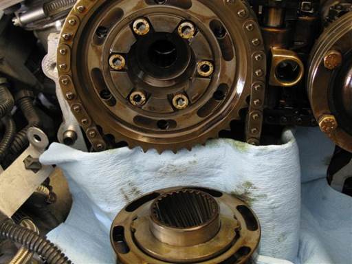

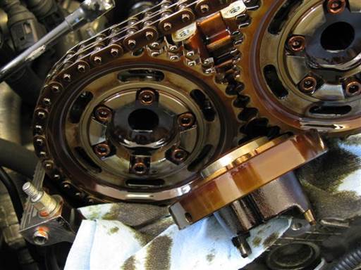

          I’m glad you agreed that the hub bottomed out on the sprocket. I don’t know how can you tell they are bottomed on each other or a tiny gap by looking at a pic.
          The hub, sprocket and the threaded 6-hole ring on the cam have to be clamped altogether by the 6 hub bolts at 14Nm. If they are not bottomed on each other, the timing that one painstakingly set will be changed as the hub slides against the sprocket in operation.
          Re to the spring cup, it only contacts the hub by a thin circular line and so there is very little contact surface area to worry about increase friction and slow down the vanos response, even for the S62 cup. Without the cup to preload, there is a tiny gap between the sprocket to the cam and the push/pull action of the vanos piston will cause rattling by this tiny axial plays.
          I hope we all agreed that bolting down the hub bolts to 14Nm, or even higher, will not change the distance from the hub tabs to the disc.
          the oil varnish pattern on the back of the hub as well as the front of the sprocket are the witness marks that they are line to line and the cup spring is compressed and contained within the pocket at the back of the hub.

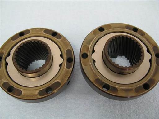

          Click image for larger version  Name:	image_22283.jpg Views:	7 Size:	36.4 KB ID:	93607
          Click image for larger version  Name:	S54Hubs.jpg Views:	0 Size:	23.7 KB ID:	93606
          And an S62 just for reference
          Click image for larger version  Name:	S62-VanosPumpHub.jpg Views:	0 Size:	31.9 KB ID:	93608

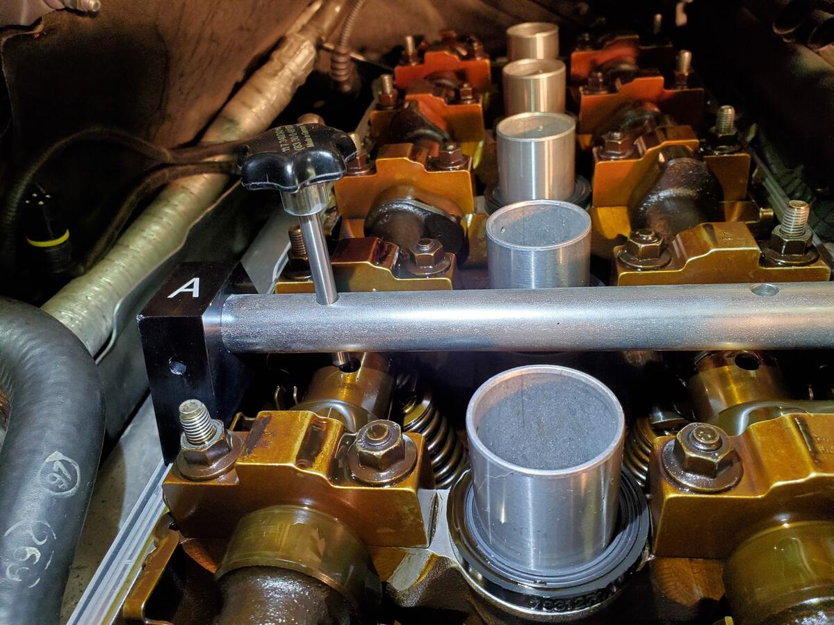

              For reference, here is the point at which the bridge/pin sits flat on head when inserted into EX cam. The crank must be ~3/4" CCW of TDC to allow the bridge to sit flush, what gives?

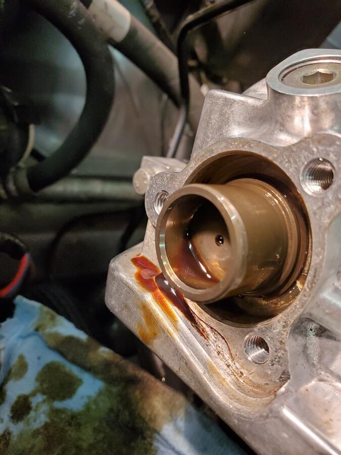

              Edit: pulled off cap on exhaust side of vanos and piston is nowhere near fully extended, so apparently I am unable to retard cam without using what I feel is too much force.
                For some reasons turning the crank few turns didn't push the EX piston to its forward max position. With the vanos removed, why didn't you turn the EX cam to max retard and align to the pin? With that, when you bolted down the vanos, everything lined up.
                  " so apparently I am unable to retard cam without using what I feel is too much force"
                  It's not easy to turn the cam to force the spline shaft forward. This is why the cam is too advanced. But nothing has changed.

                          S62 plates = 3.19mm
                          S54 plates= 3.54mm (these are my factory plates/springs)
                          So while the S62 cup springs may be more rigid the S54 plates are thicker.
