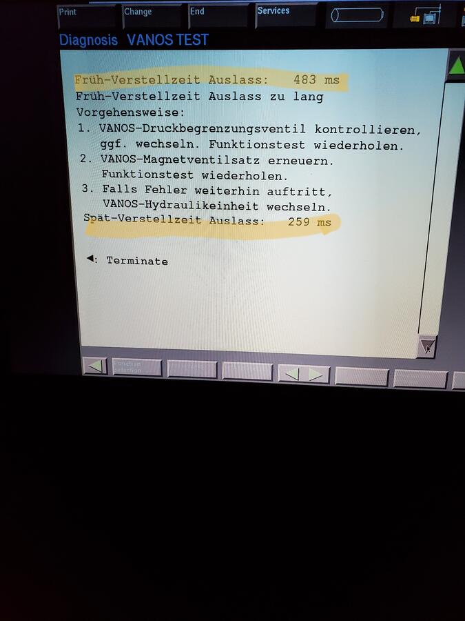

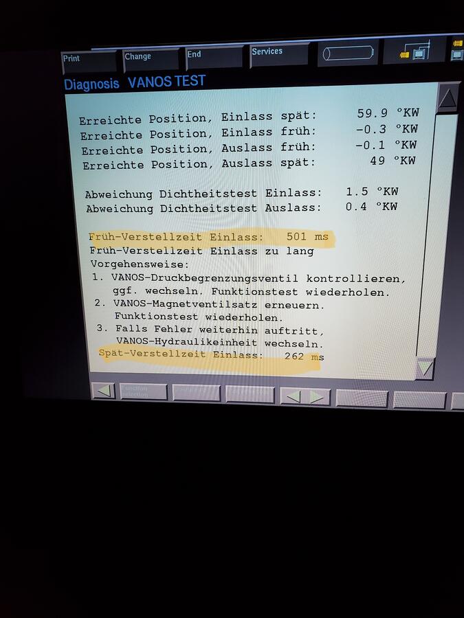

                                Unfortunately my 3rd vanos test (75 miles city driving) is the worst yet. My second vanos test did improve a bit so I was optimistic, but after 50 miles between the 2nd and 3rd tests and a worse result I'm not sure what to extract from this.
                                As noted before, it was suggested that the fact that I used S62 diaphragms may be causing the delay, I can see that being and issue. These result may mean nothing but I just thought I would share this in hopes of finding out why it's been inconsistent.
                                24 hours before vanos rebuild:
                                6 Miles after rebuild:
                                26 miles after rebuild:
                                75 miles after rebuild:
