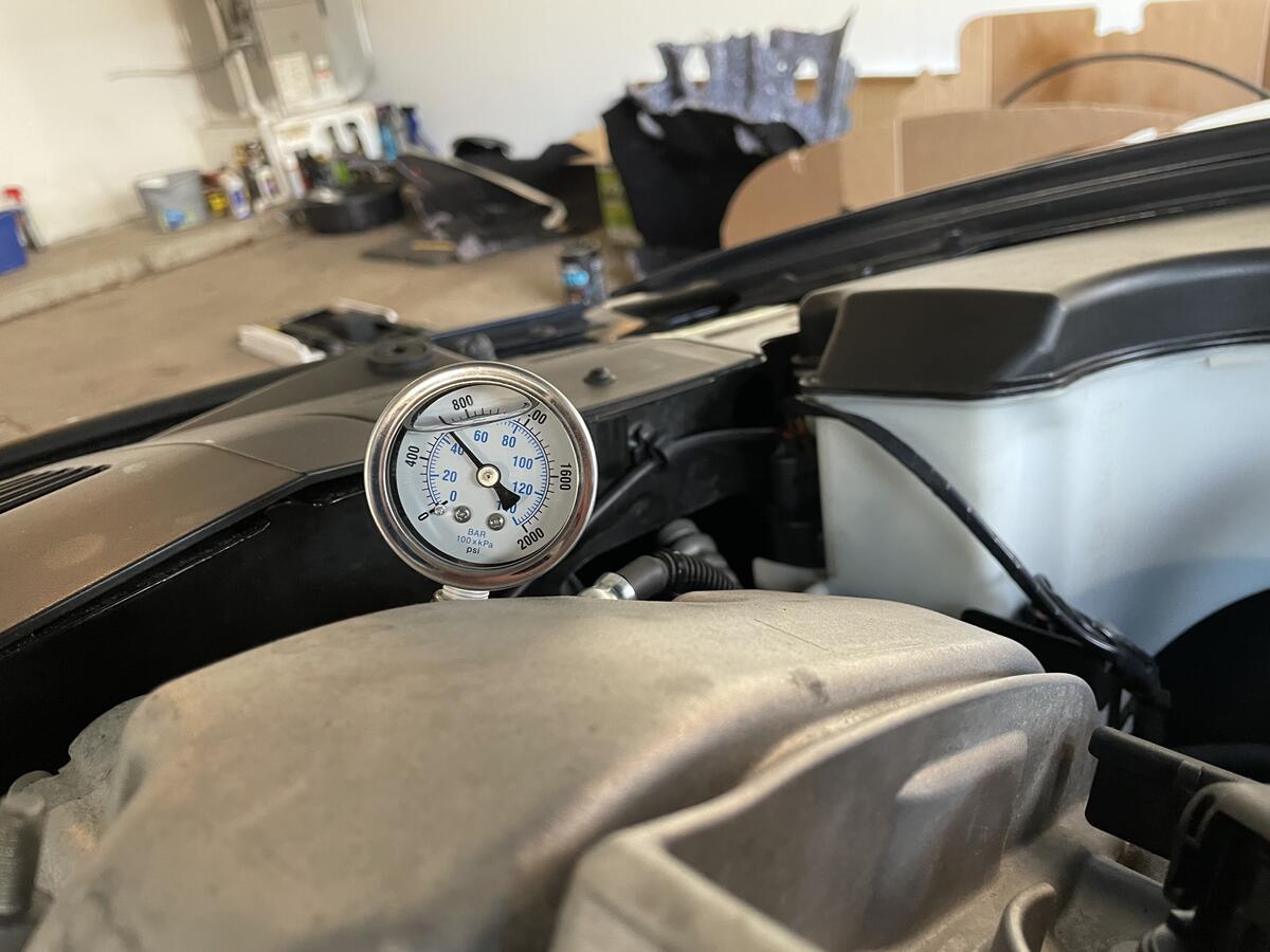

      Cold start was right at 100bar, it was slightly higher than 100bar for a brief time period before the vehicle went into closed loop and the idle dropped.
      It then got down to 40 bar when up to temperature, wow that's low.
      I talked to Raj over the phone and he is pretty confident that my low oil pressure is due to the oil pump disc shaft wearing.
      I did not take a pressure reading before disassembly so I cannot say if this is the case or not.
      Raj is of the opinion that my oil pressure was the same or likely worse before the new pump disc was installed due to his disc having tighter tolerances in regards to pump cylinders.
      He thinks my worse vanos response times are due to the new seals having to get set. He thinks my response times will improve by 200 city miles. I am at about 125 city miles post install at this point.
      Raj gave me this gauge and is going to help me out to figure out the root cause. Man, this is super disappointing to me.
      Cold:
      Click image for larger version Name:	20210313_141211.jpg Views:	0 Size:	95.6 KB ID:	91294
      Getting up to temp: (Settled about here temp wise after 20 min)
      Click image for larger version Name:	20210313_142959.jpg Views:	0 Size:	54.1 KB ID:	91295 Click image for larger version Name:	20210313_143550.jpg Views:	0 Size:	62.7 KB ID:	91296
      After vehicle was up to temp. I hit the throttle of few times to see what the pressure did.
      At 1500RPM (DIS test RPM) gauge read approximately 78 bar.
      At 2000RPM gauge read about 82 bar
      This is exactly my very same case. And we did the same, and we both have low miles, in my case even lower. I am not sold that the shaft is worn out

                          The OP and I have the same setup, low mileage (mine is lower at 43k), and new disc. this is with oil at 95C. in my case my car reaches 80bar at 2k rpm, and I can reach 100 at ~2.8k
                          the below is with a new pressure regulator valve in place, so now we know that would not be the solution.
                          If what Beisan is saying is true, and his disc has tighter tolerances, well, that may actually play against the performance of the VANOS instead of improving it.
                          The OE disc has 9.03mm holes, and the pistons measure 9.00, sot here is a 0.03mm clearance, so that discussion about some pistons being 0.003mm larger, does not matter, 0.003mm would fit in the 0.03 OE clearance several times.
                          also, FWIW, the ID OE disc measures 26.09, and the shaft is 26.07, so they have 0.02mm clearance, and the shaft and OE disc have zero signs of wear on the races, so again, I don't buy the theory that we have worn out shaft at these low miles
