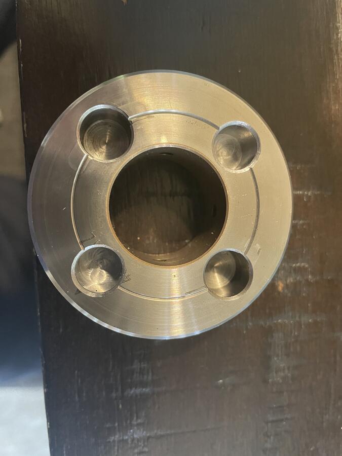

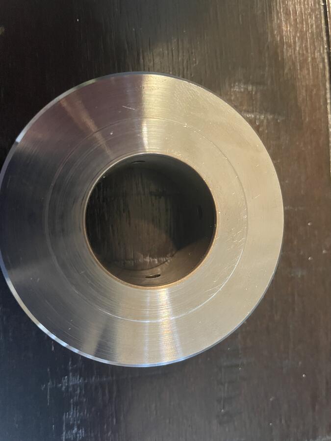

          That was me, you can see it for yourself on these images. it more than likely was pressed and then machined down to the final size and finish

          you can see the two material layer on the inner race side hole

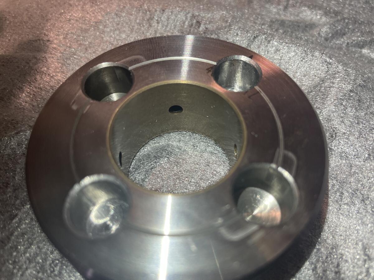

            I see the line in the drilled hole which I didn’t see in my disc. Optical illusion?
            Why there is no similar line in the other holes in both pictures? And the newly drilled holes have a uniform shiny material instead of two different shades steel vs brass?
            1)The holes must be hard material to be driven by the hub tang sharp edges, and brass cannot be 50% of the holes.
            2) The high pressure 115 bar small focused oil jet flow out of each piston would enlarge the brass holes in short time.
            3)It’s magnetic material so cannot be brass.
              Seriously I believe the disc is a one piece hard steel but don’t know why BMW machined the deep circular groove on both sides of it for some reason, making it looks like 2 pieces pressed together.

                it is even in the replica's product information. is not an optical illusion, the color is different because the material is different, I would not know for sure if it is brass, but is not one single piece of steel.
                the machined grooves do not denotate the two material joint, the top one may be there for manufacturing reasons, the one on the back denotate a step in height of around 0.2mm. no OE would spend time and money if these features that add machine time were not 100% necessary. I work for an OE in PD, and we eliminate anything we can get away without if not needed for performance, spec, durability, etc.
                The bushing is much closer to the inner race, and is very thin (download and zoom in), so it was pressed in and machined after to the spec. this will give you a better idea what I am talking about

                  You're right. I thought you meant the inner brass core separated form the disc by the circular groove on both sides and so when I saw the magnet was attracted to it I said it must be steel which is correct. So the brass is just the 1mm or so thin layer for the inside diameter. It should have ring the bell when I saw the "jet cleaned" circular line with brass color inside the hole -- I thought it was from the engine oil tarnish. I will use an exactor knife to test the brass bush at the chamfer edge.
                  "the machined grooves do not denotate the two material joint, the top one may be there for manufacturing reasons, the one on the back denotate a step in height of around 0.2mm. no OE would spend time and money if these features that add machine time were not 100% necessary."
