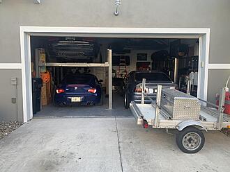

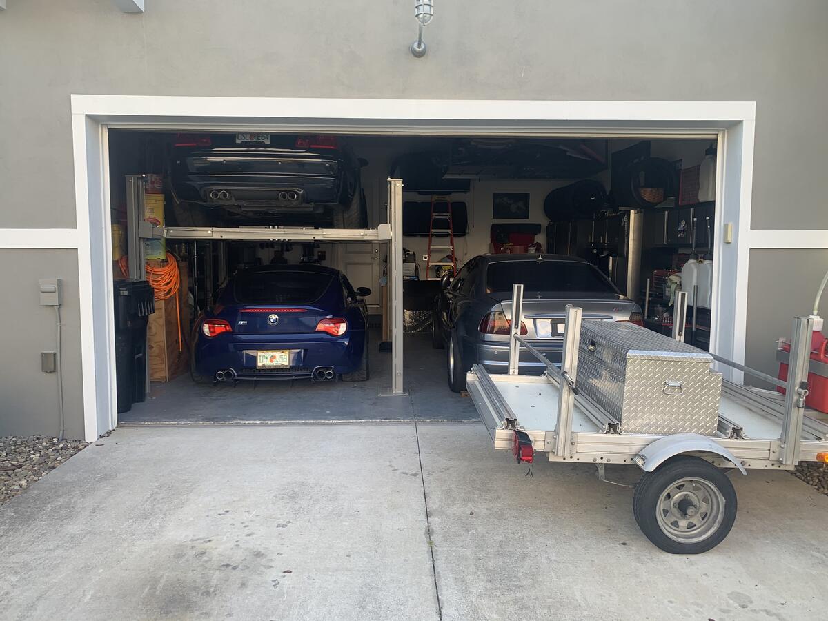

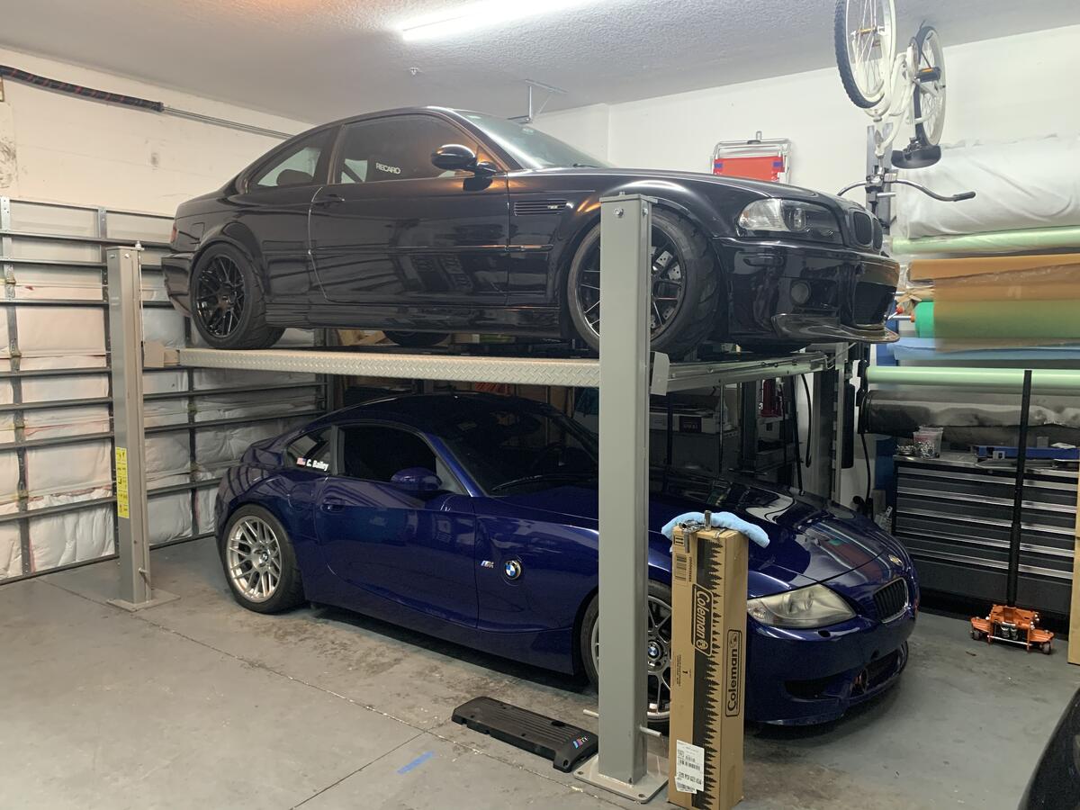

        How much garage height is needed to stack cars like that?
          #49
          I have 11.5” which works for my lift and cars (I did raise my garage door though) I Can raise the m coupe or m3 max height and walk under just barely, but anything much taller then the m3 won’t work max height.
          I have bridge jacks, a 4 post, plus quick jacks. Some times easier to use bridge over the pinch rail quick jacks depending on what you are doing. Also work nicely for supporting things (like dropping subframes).
          only reason I went with a 4 post is my garage is pretty small and mobility is key for me. My 4 post actually is mobile when not loaded, and only when fully lowered. It’s definitely less rigid then others lifts I have been around as it’s not mounted to the floor, but I feel safe around it.
              10-11 is an absolute must, more if your cars are taller. I have 14 in the tallest part, and 10 at the lowest, but my door is far enough that its not in the way, otherwise you'd have to raise it:

                  #53
                  Good to know. It looks like most of you guys have to remove the ramps for the car on the lift for the bottom car to get in. In would imagine the ramps hang a bit lower than the lift.
