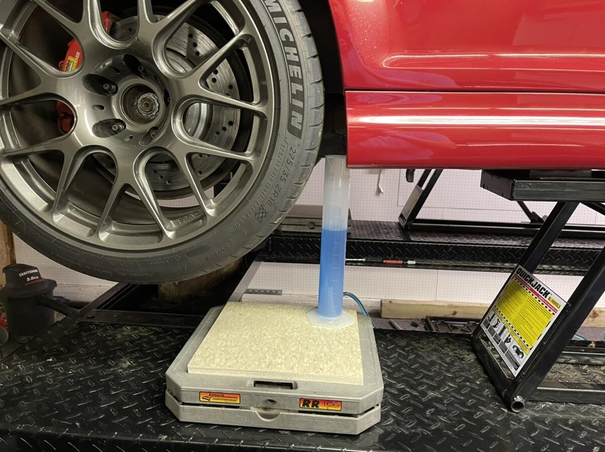

                Was just doing an alignment/corner balance, and loving the quick jack/4 post combo.
                Am i the only one trying to figure out what’s going on with the scales and graduated cylinder in that photo?
                Are you lowering the car onto sclaes using the quickjack for the corner balance?
                Is the graduated cylinder meant to be some kind of water level?
                  #68
                  Yes and yes
                    #69
                    Nice job with the water level. Just curious - have you seen different results with the car rolled into scales vs dropped onto them? I've always understood the car should roll onto the scales, and that lowering from a lifted position artificially loads the suspension and gives wonky numbers.
                      #70
                      That’s why I have those vinyl slip plates, and a rock the car bunch… and I do a drive off/on for a final check.
