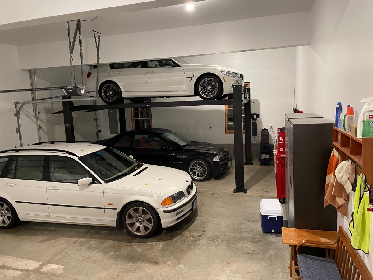

                            So I ended up following Ian's path and got a 4 post lift as well as a set of quickjacks. Very happy with my purchase - right now the '16 M3 in the pic is gone and it's replaced with a '04 M3 donor that's almost completely stripped for my full metal slicktop M3 wagon project.
