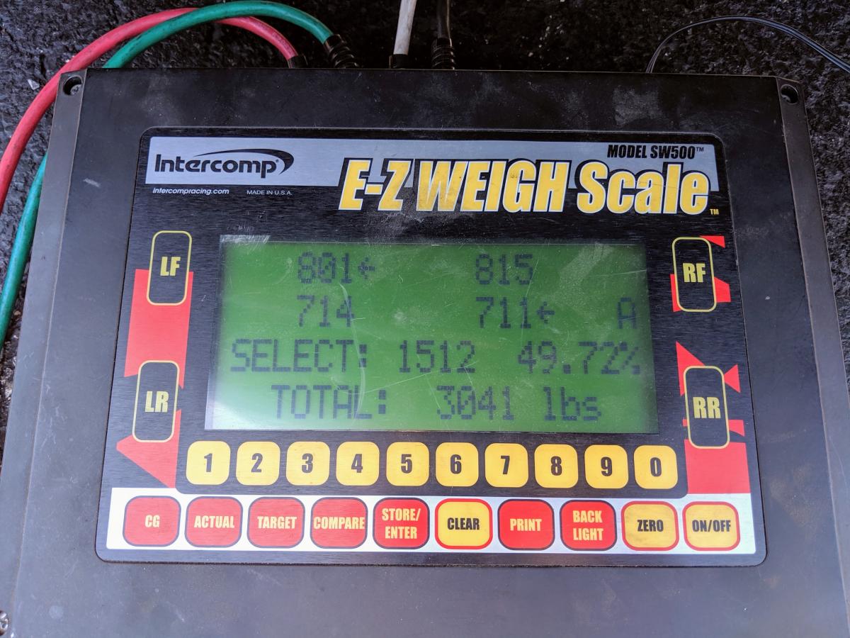

        Can you share your corner weights?

                I guess I can see it if your car is rather stripped where you are carrying closer to 55-60% of weight in the front.
                  Had me searching deep for the pic.
                    Nice, looks like you have some significant weight reduction.
