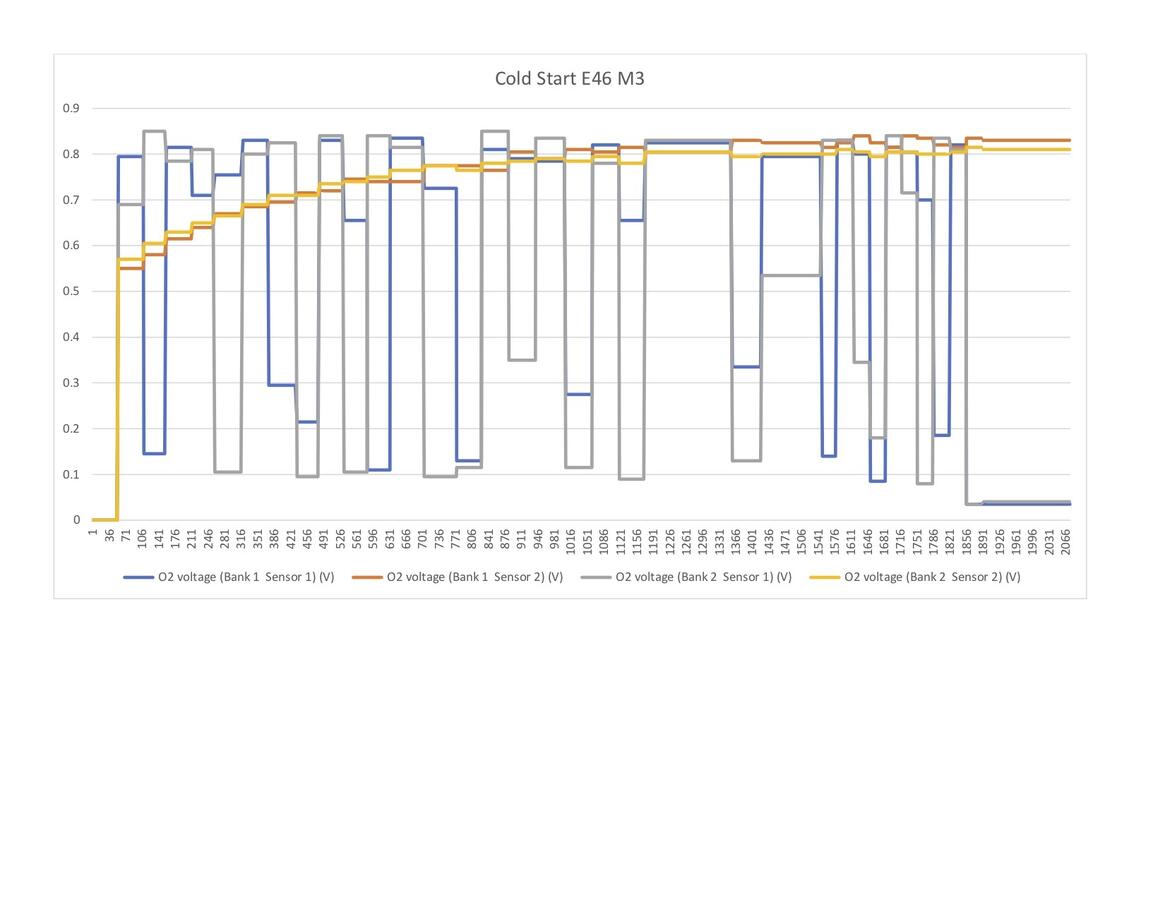

                              I attached my O2 logs to see if anyone can help me narrow down which sensors are acting up?
Name:	Microsoft Word - CSVLog_20210330_110616 - Cold Start.03-30-21.jpg
