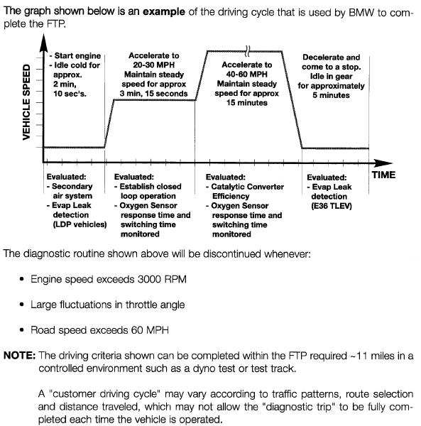

            any luck getting the cat readiness set?
              This worked for me on more than one occasion. Had to do it in the dead of night to get it completed without interruption with hazard blinkers on.

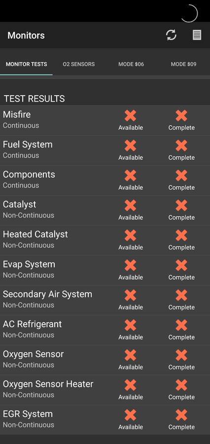

                        Trying to get my drive cycle done, but have been having issues. Checked the monitors status with torque and obd fusion and both show that none of my monitor are available.
                        I have a DME that was originally a non-HP that I converted into an HP. I tried with a completely stock 2501 binary and with one that I modified to remove the 151 DTC. Same results with both. I've probably druven the car 150 mi since the last flash.
                        Anyone know what could be could be going on?

                                I used this. It worked. Done and drove right to the emissions stations and success. Choose the right "not crowded" road that you don't have to brake, speed up to merge or otherwise fall outside the limits.
                                I used this approach a few days ago and it succeeded in getting my catalyst and heated-catalyst tests into readiness.
                                (Driving at 55mph in the slow lane was a revelation. There appears to be a large class of people who actually do it full time.)
