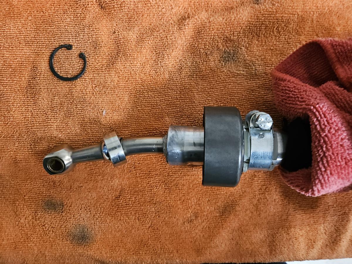

                          Question for those with the AutoX, can you confirm that it is using an actual spherical bearing instead of a steel ball?
                            I forget his name, but I've texted with the owner and had a phone call not about your question but he's very responsive.
                            Just and FYI: the ultra kit will sunset and the only one he'll be producing going forward is the Auto X kits. The Auto X was made taking the last 20ish years of design and tech to make the best shifter.
                              Yes, here's a picture of mine:

                                Nice…thank you
