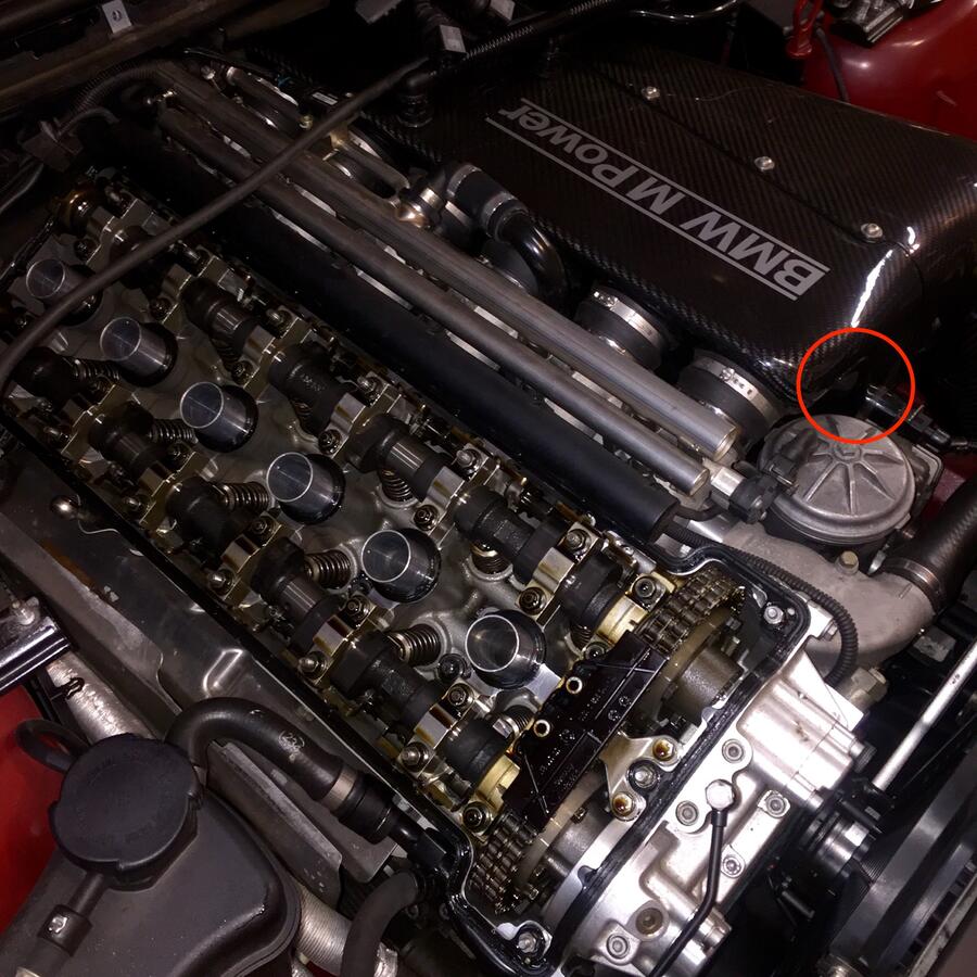

      It's in the OE location on the clean side of the filter. Not the best picture, but the first one I found in my library where you can see it:

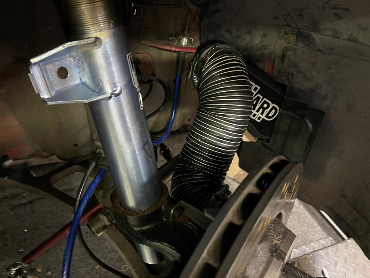

                  So the only cold air ducting you run is the kidney grille piece? Nothing from the fake brake duct area?
                  Correct, the only duct I'm running is the kidney duct. My brake ducts are 100% functional brake ducts, that do nothing else :P

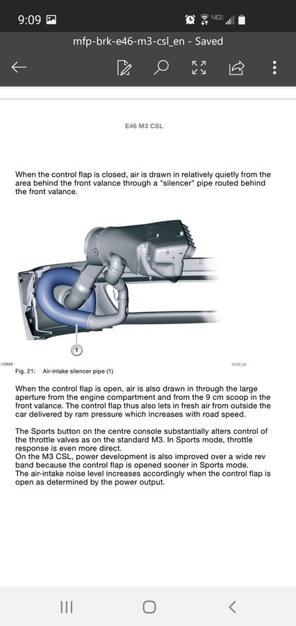

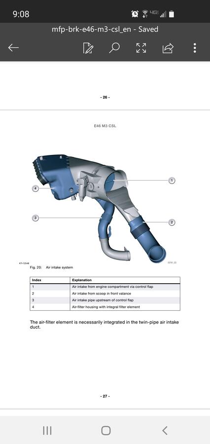

                          Also, here is some shots of the CSL ducting just because.
