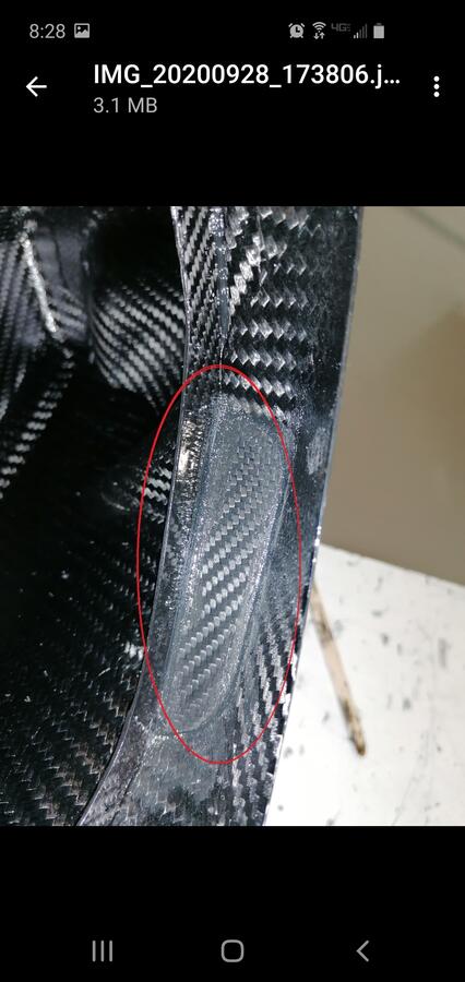

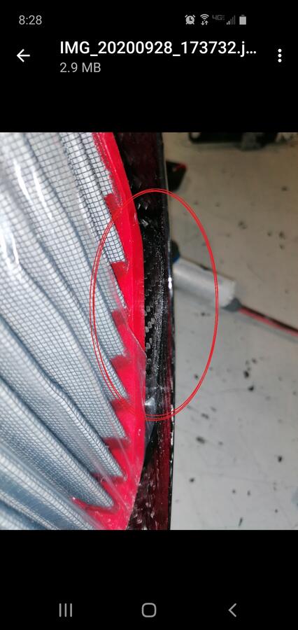

              Yea part of my ITG filter is in the gap. I will likely send my box over to them this winter though. They sent me this picture of the "repair".
ID:	108676 Click image for larger version
