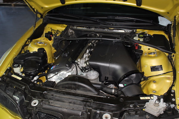

                      Speaking of which, Click image for larger version  Name:	 Views:	0 Size:	160.6 KB ID:	110147

                        Obioban or anyone else who happens to be running the Race version with the built in snorkel. All weekend, I've been hovering over the buy button on the Karbonius site for both an airbox and a trunk (for the $500 in shipping of that trunk per this thread, I figure might as well get an airbox shipped).
                        MY QUESTIONS:
                        1. Are you running any sort of ducting to the box to direct cold air? Ian, you said you were just running ducting from the kidney grills earlier in this thread. Is it just the factory duct work or something more complicated / custom?
                        Reason I ask - it *seems* like with the "regular" Karbonius CSL carbon box that you could get cooler air to that box more easily, given the provisions that exist via ideas in this thread and others. With the Race version, the opening at the bottom of that snorkel is quite wide, so getting cooler air to it seems (again... seems) like it might be more challenging. If I went with the regular Karb CSL box, I'd use their carbon snorkel.
                        2. Is anyone running their heat insulation kit? Don't love the look of it, but seems like a really great way to mitigate some of the heat soak issues mentioned in this thread, in particular post #49 by Anri.
