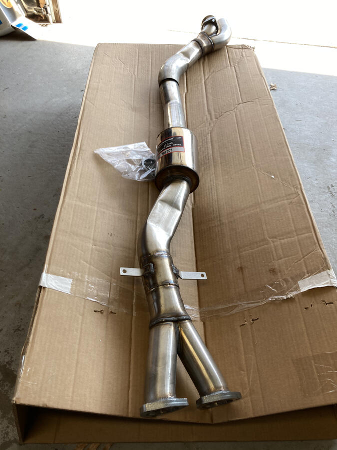

ID:	97265 Quick delivery!
        FYI- I’m not above modding purely to get the right sound... it’s awfully hard jumping back and forth between the sound of a Ducati with full Termi exhaust and this m3...

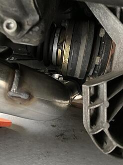

          Has anyone had clearance issues with the SS Sec. 2 (Or SG..) comming too close to the output shaft/flange on the differential?
          I would imagine these single pipe designs do not re-use the OE heatshield and may gain some clearance simply because they are smaller as well.
          After installing SSv1 headers/Catted. Sec 1 my OE section 2 heatshield was touching the differential, not a good scenario.
          I removed the factory heatshield and put some washers above the exhaust hanger plate/reinforcement plate (the 2 small black rectangle plates) and this helped bring Sec. 2 down to where it won't make contact with the diff.
          I see that the SS dual pipe comes with spacers for the 2 rectangular plates but I would assume the single pipe does not, but please correct me if I am wrong.

            I"ll be installing this SS section 2 tonight (hopefully)... it's being mated up to fabspeed headers, modified OE section 1 w/ cats, and an aftermarket back box- so not the exact same variables as you, but I'll report back on fitment issues here afterword!

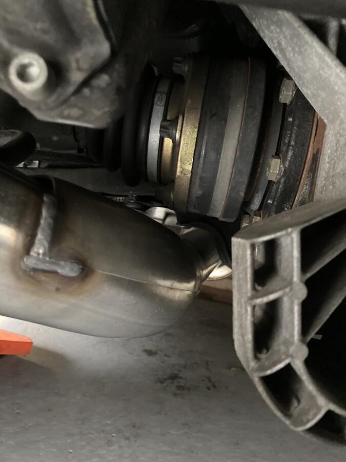

              Cubieman no spacers included, but miles of room
