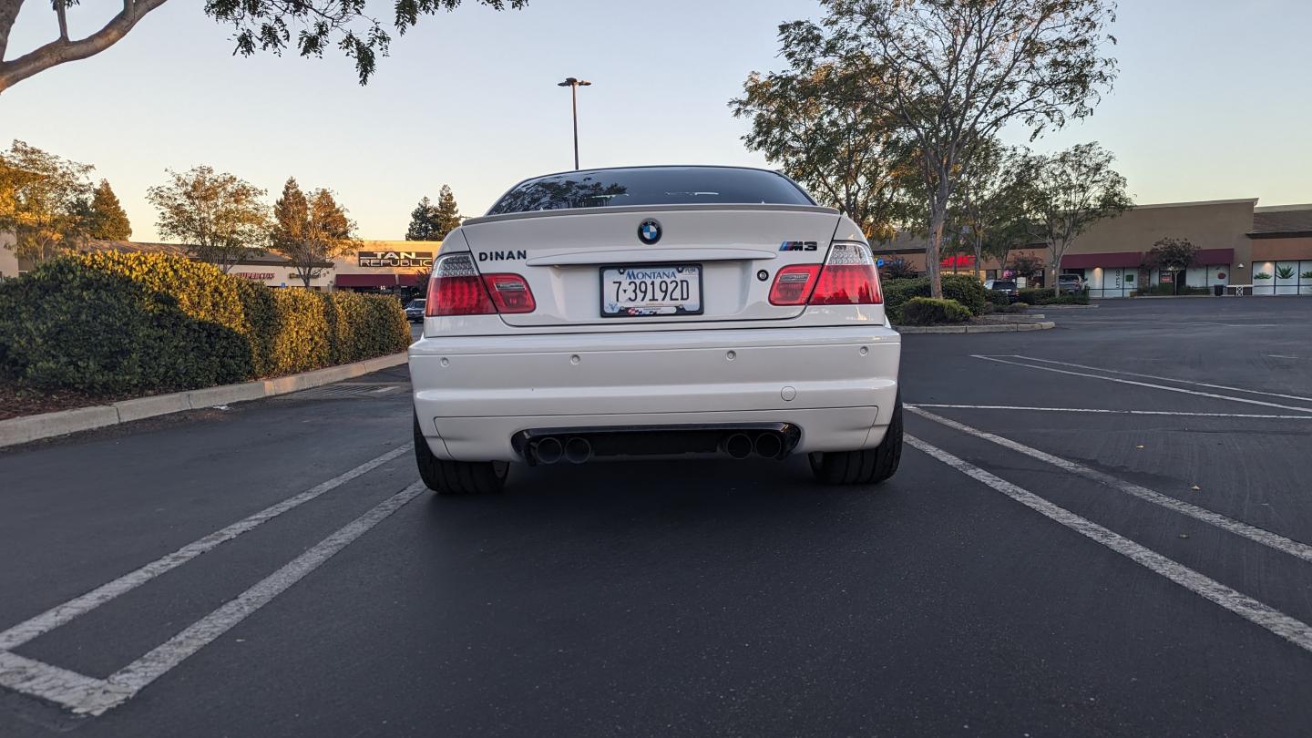

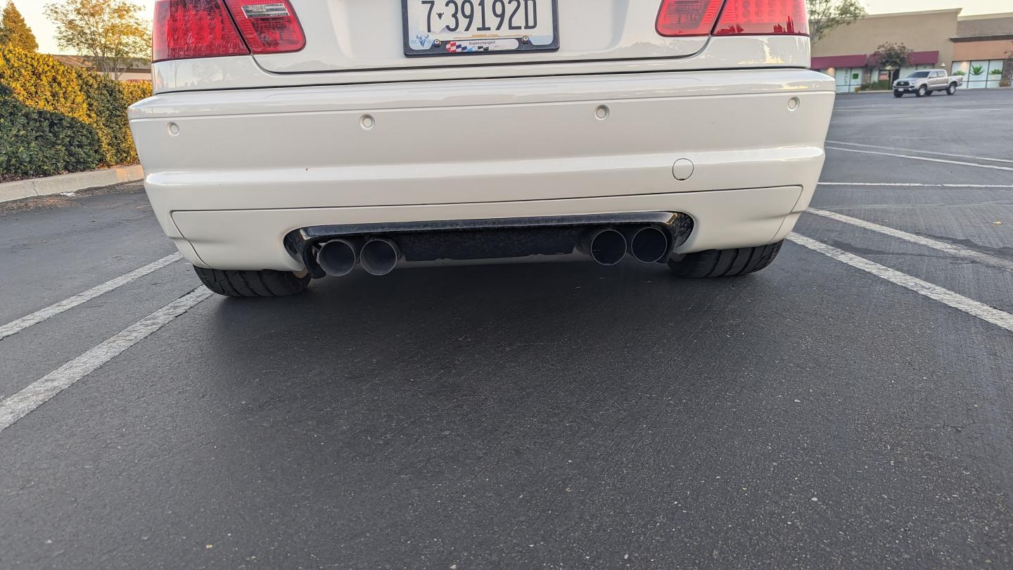

          More pics. I ordered brand new clips for the bottom, and I did eventually get all 6 clips in. I had to drill 4 new holes, I only used the 2 middle factory holes.
          I personally think fitment looks factory, IDK that I see any gap at all. Just posting for anyone that is worried about fitment, if you know what you are doing you can get this to fit like a glove. Just don't expect it to bolt on and be perfect.

            Dang - you nailed it. The side gap and curvature alignment looks perfect from here.
