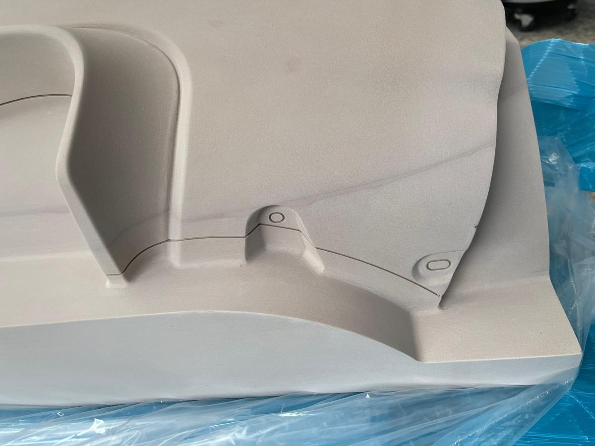

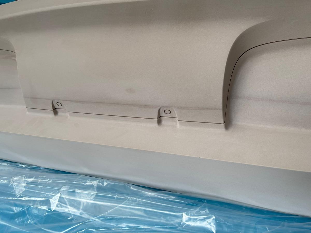

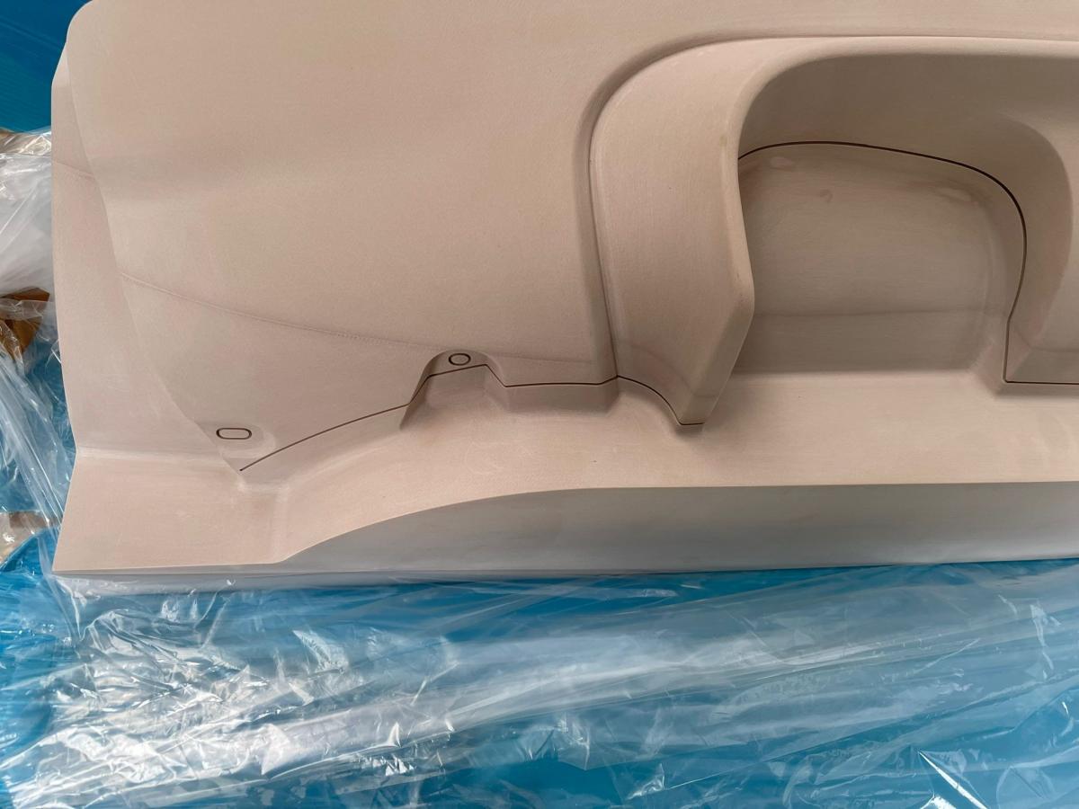

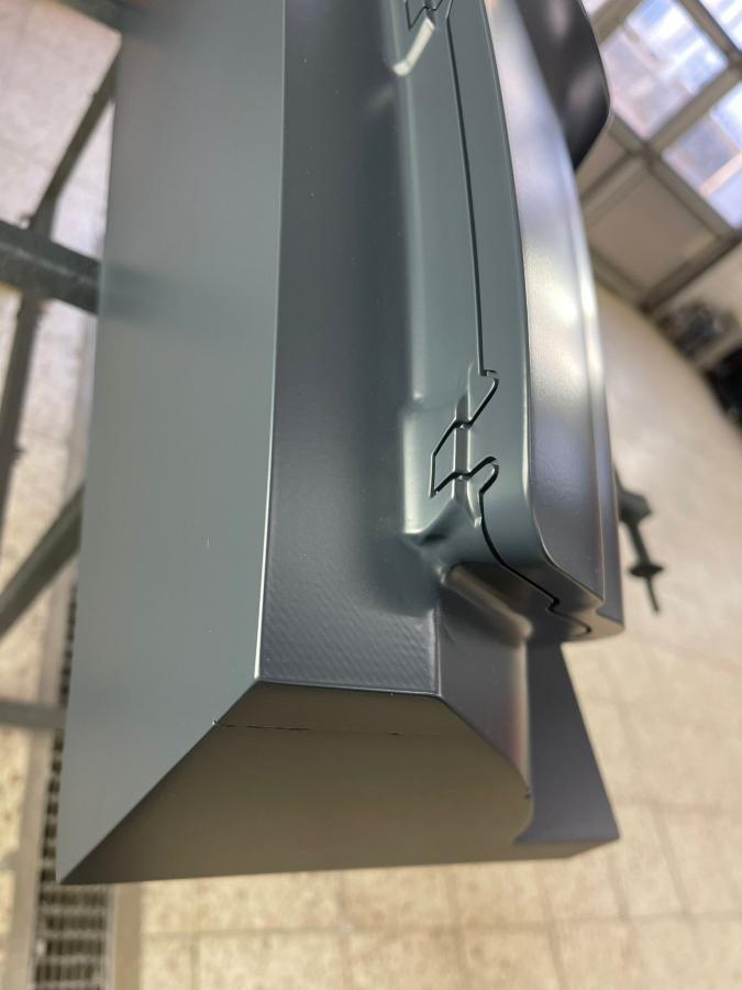

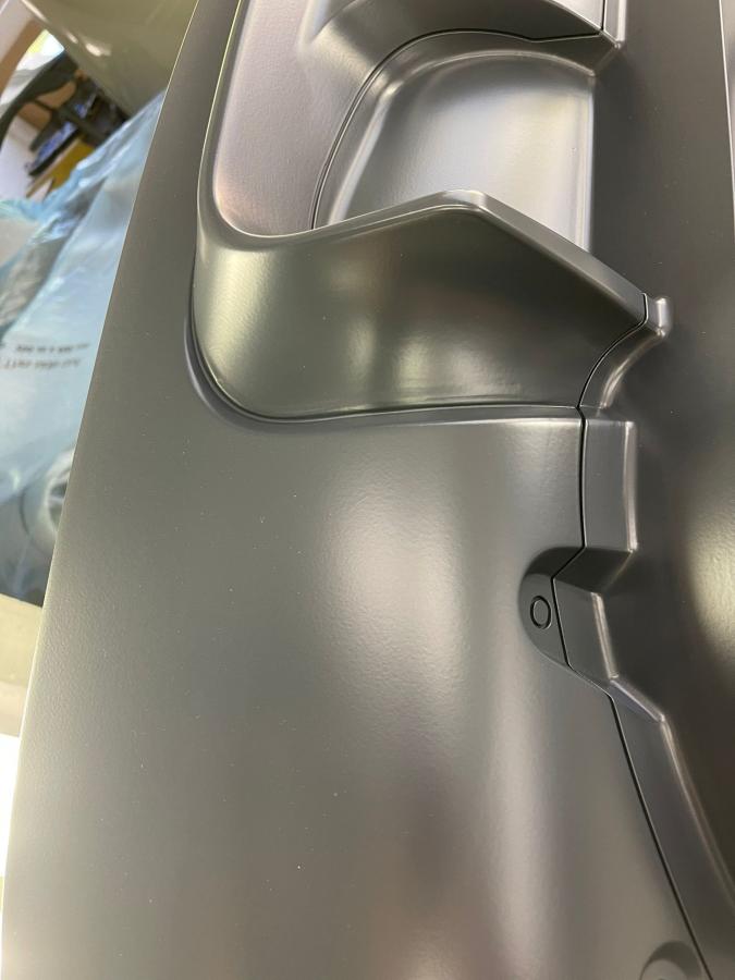

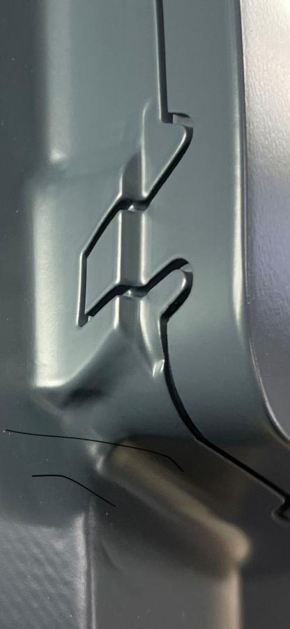

                      Another update
                      The master positive mold is done! It will now get epoxy'ed and the first negative mold will be made out of carbon to create the 1st production diffuser.
                      I added a new, detailed Journal entry here.

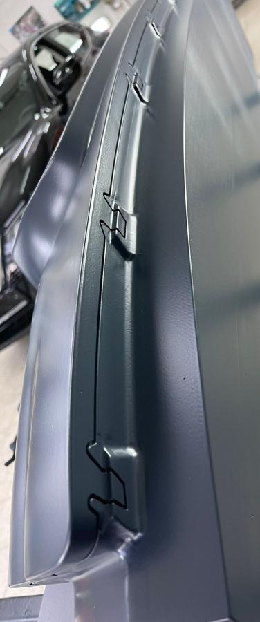

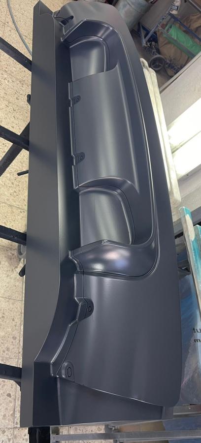

                          The epoxy is done. See attached.
                          Negative mold creation has started. Rene wants to do 2x negative mold production considering the popularity to cut down production time in half. He'd be able to do 6 to 8 diffusers a week.

                            This is looking great dude. The mold looks exquisite.

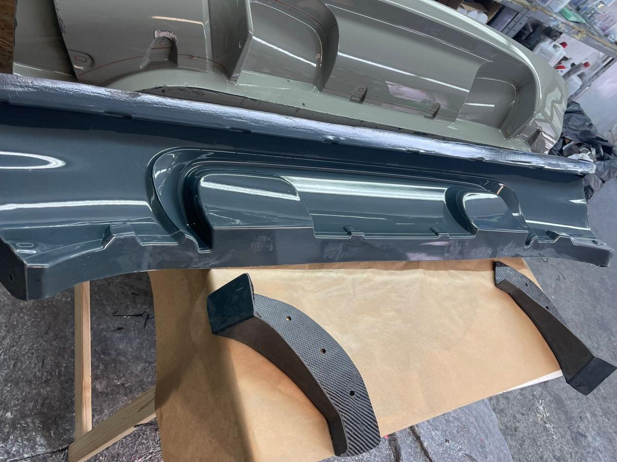

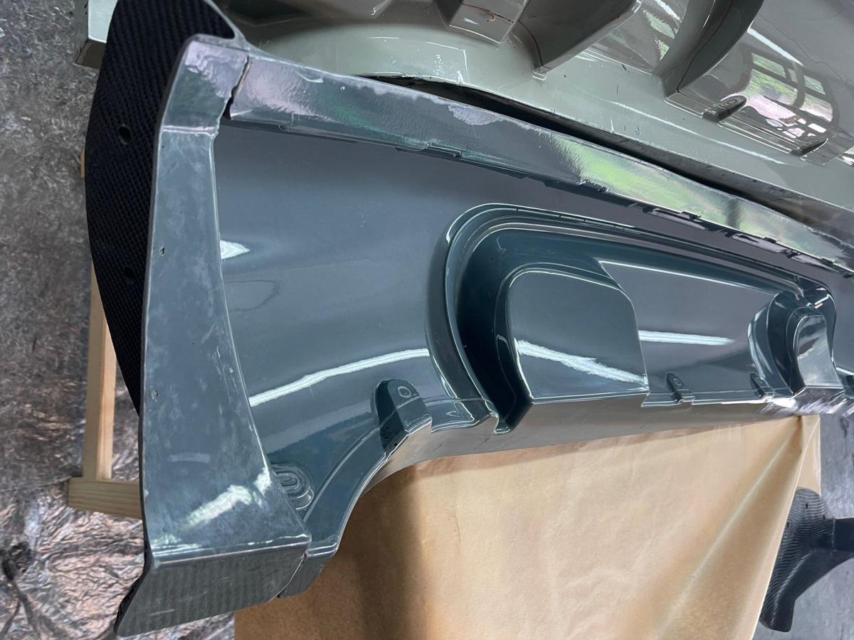

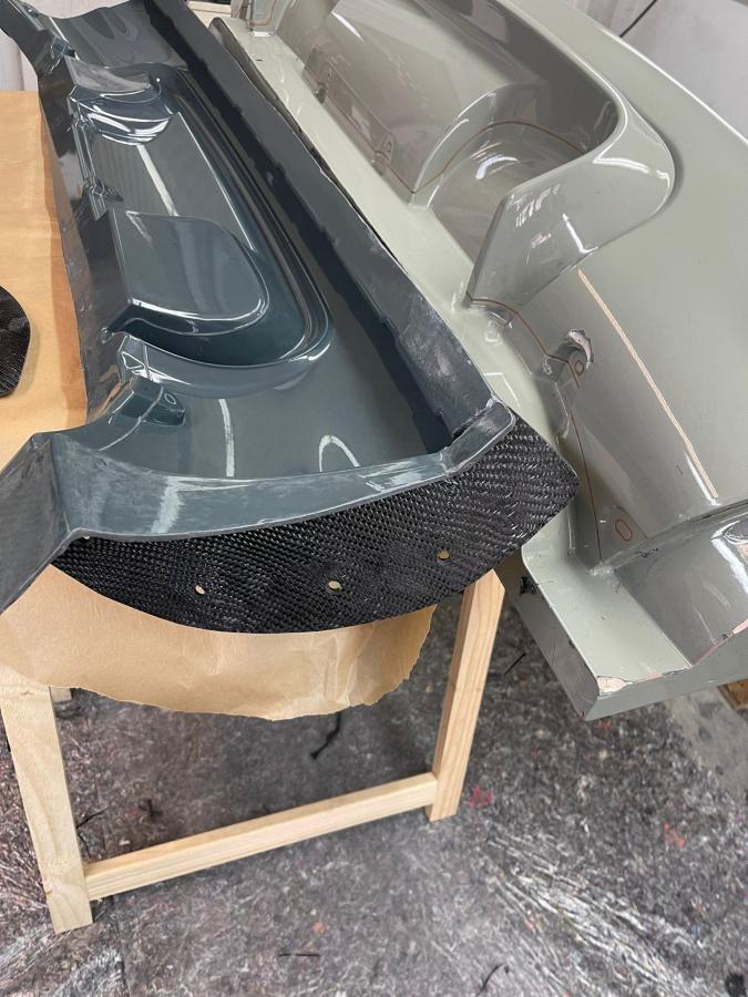

                              Inching closer to production:
                              Negative Mold Creation.
                              As of June 8th 2022, René has created the 1st negative mold. Made from carbon fiber, this mold will be used to create the actual production units! The mold is further reinforcement by adding carbon fiber plates to ensure the mold stays true during production and autoclave process.
                              The negative mold will now be finalized by applying the various layers of release agent needed to start production.
                              Next step: my test diffuser gets made this Friday : )
