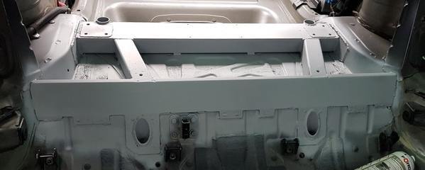

    Would installation of this impede the installation of say a vincebar or other topside RACP reinforcement later on down the road?
    I know if that was the case one could simply do topside first, then rear bulkhead.
    No, but it would make it slightly more annoying because of the limited space.
    Edit: On second thought, it might interfere slightly with the front mount reinforcements. Vince-style gusset cups are probably fine because they're low profile, but something like the CMP solution might not fit. Regardless, I would still do topside reinforcement before this.
    I wasn't able to find a picture of the bulkhead without the seats in place, so not sure what it looks like towards the bottom. Maybe someone else can chime in?
      The CMP front top brace appears it would not be compatible.
            Vince front cups possibly can be installed, but i think you need to install them first.
                Vince bar should be compatible (I’m counting on it 😜), but you should install the front portion before this for sure. Not sure if it’ll be impossible after, but it’ll absolutely be at least a PITA.
                  #83
                  It will be impossible after without removing this reinforcement. The gusset cups sheet metal will end up under this reinforcement.
