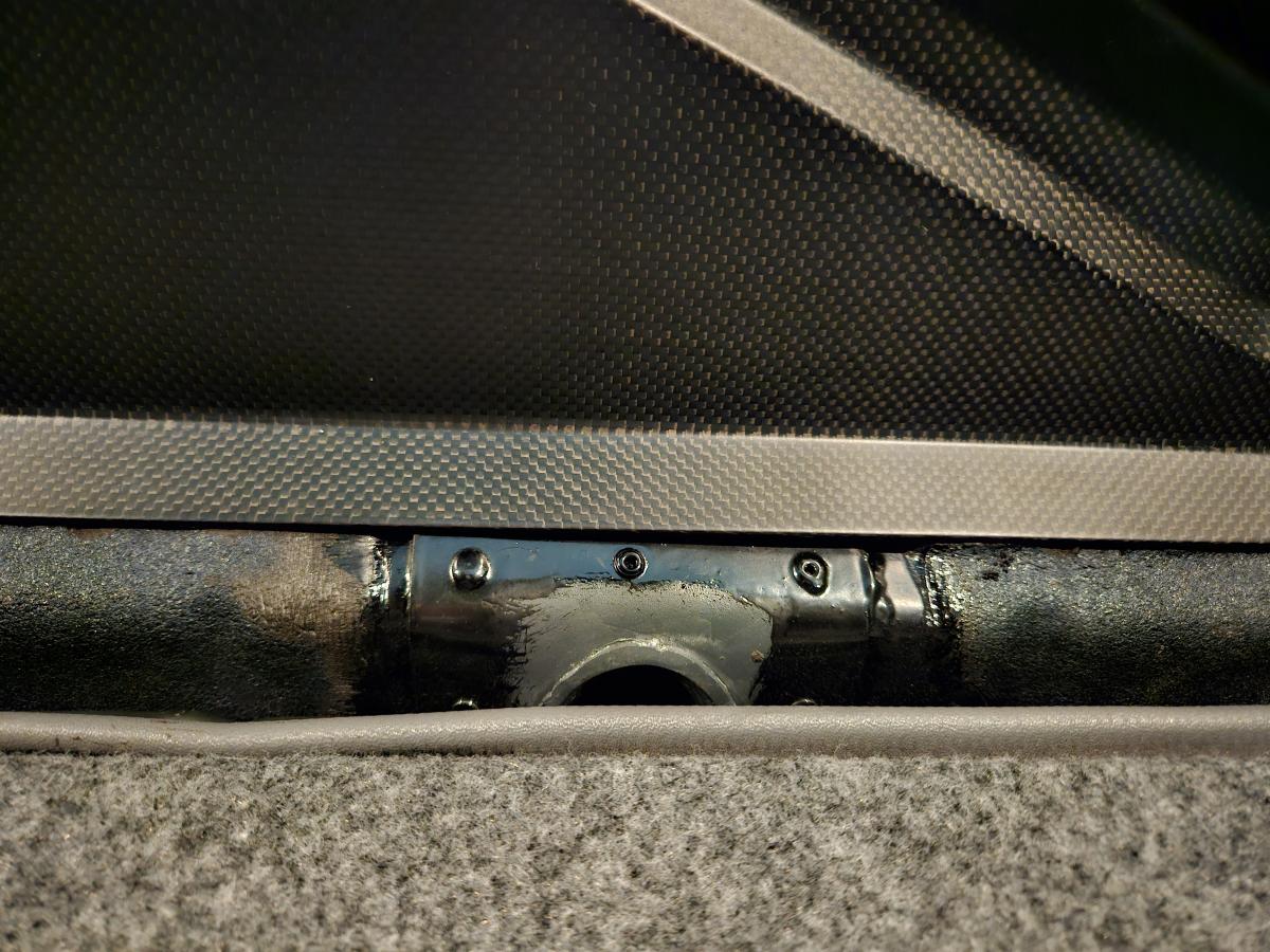

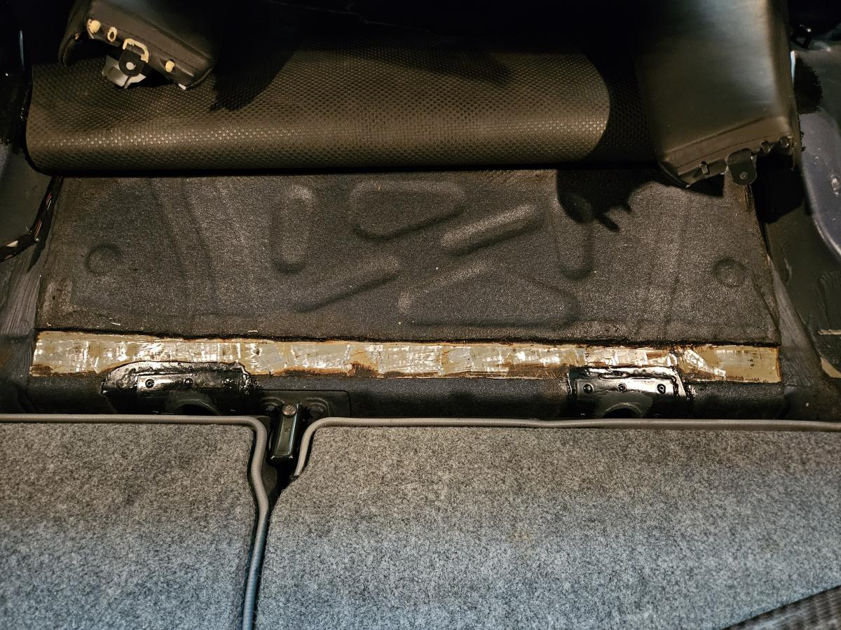

      Remove a sliver of sound deadening today and this is how it all fits now:

      It's not 100% behind the cups, but I think I'm okay grinding back that last mm or so.
      Also brace still isn't fully seated. It's interfering a bit with the seam sealer on the sides. I need to removed absolutely everything along the bonding surface before the final test fit. Then I'll be able to see exactly how much I need to grind back from the plates.

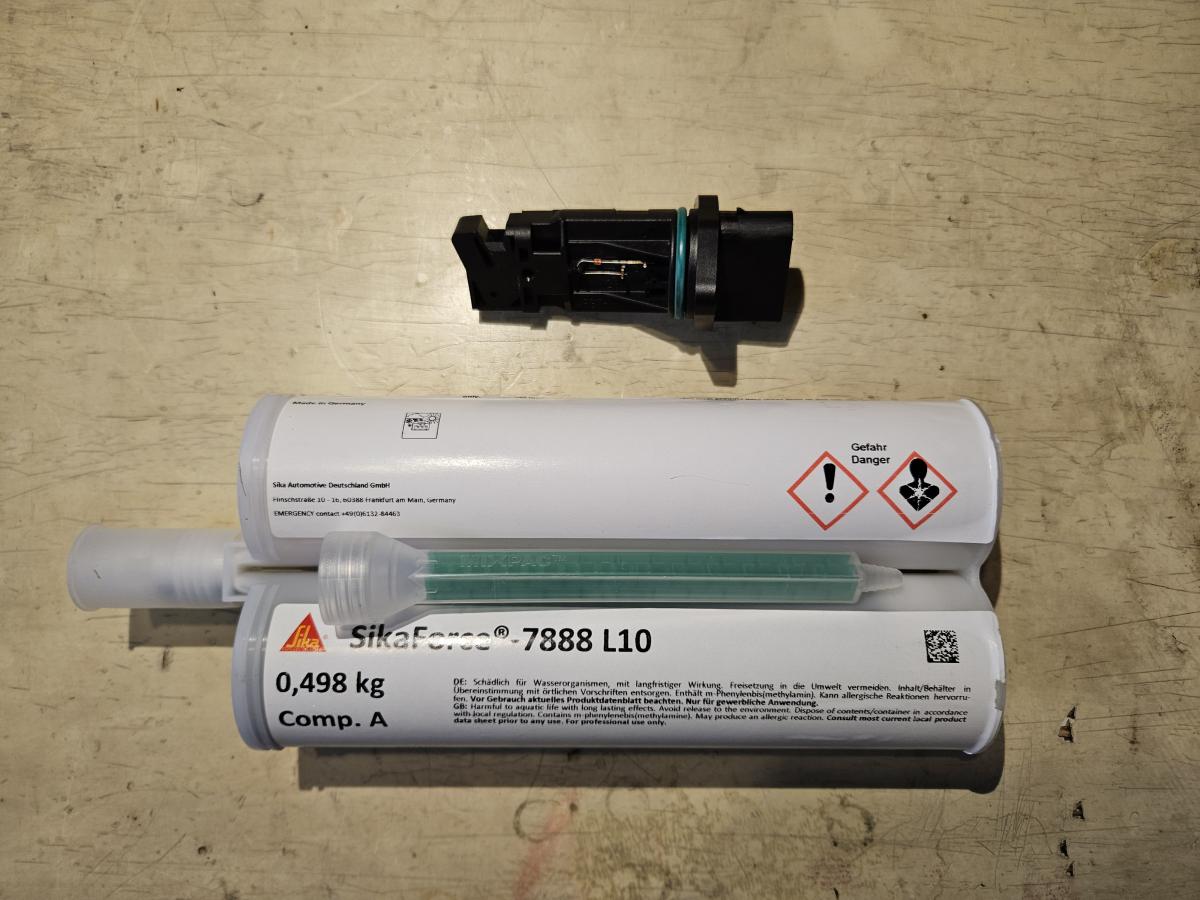

                      Just got this in the mail today. Expires in Oct, so will have the brace installed before then.
                      It's also a lot more than I expected. I'm used to the much smaller 3M cartridges. There's no way I'm going to need the entire thing. MAF for scale:

                          ... think it fits in the normal 3M gun?
                            I highly doubt it, the footprint of this is significantly larger.

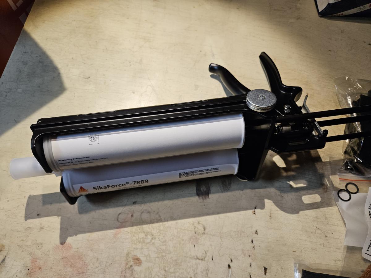

                              Shitty pic, but this is the type of applicator you need for the Sika adhesive Obioban​​​​:

                              Gonna try to get this installed this week or next. Will post pics and impressions when I do.

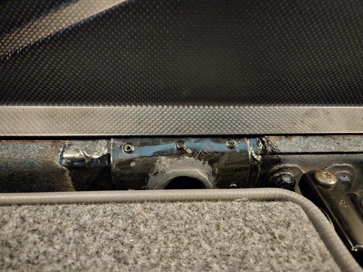

                                It's in!
                                Click image for larger version  Name:	20230803_195652.jpg Views:	105 Size:	121.6 KB ID:	227951
