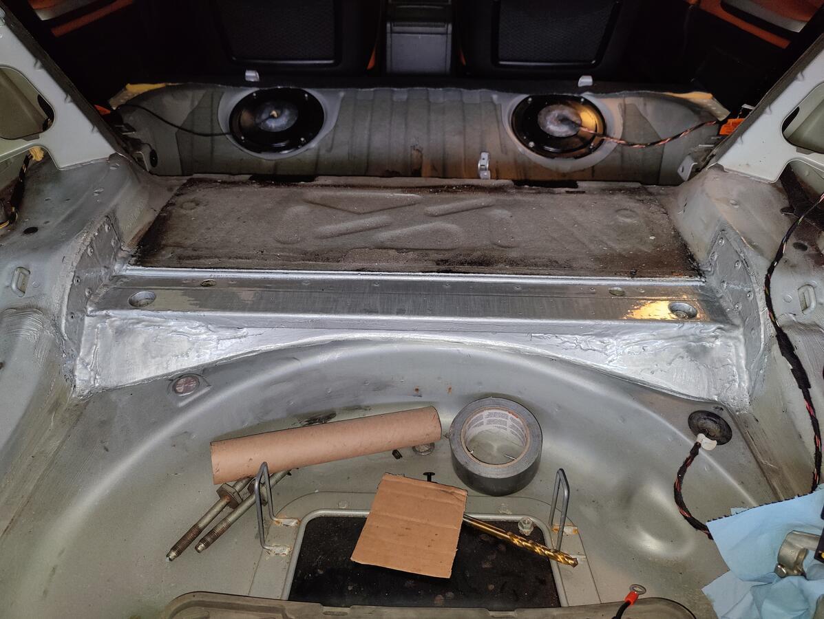

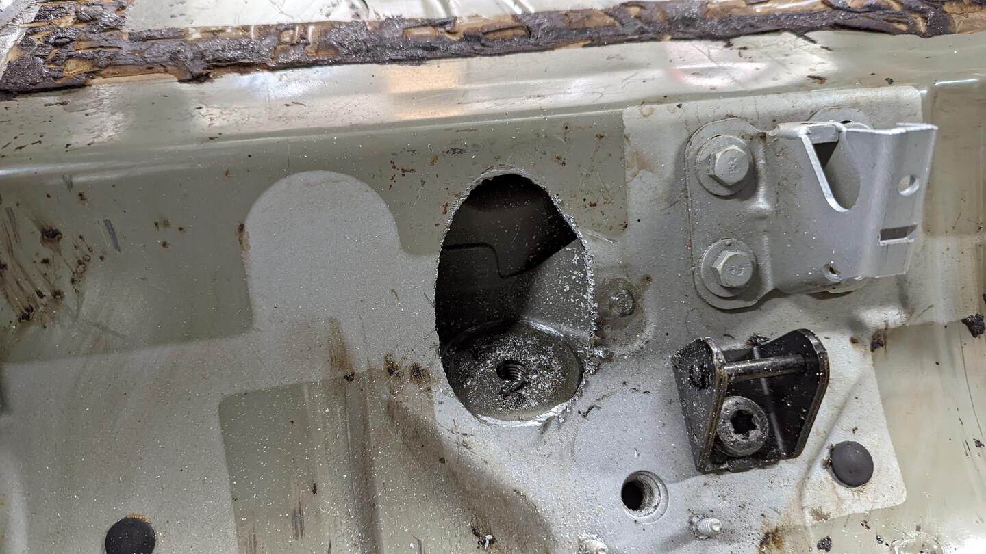

          how far are you on the process? I've prepped everything and measured, i'm about to start cutting the trunk area. I need to go buy a 4" cut off wheel from harbor freight though.
            I plan to start this weekend, way behind where I wanted to be at this point in time.
              BTW I didnt need a 4" cut wheel. I just removed the cover on my angle grinder and it worked fine. But I did buy a lot of metal brush wheels to help with the paint.
              I think I bought more tools than I really needed to but luckily I didnt open them all!

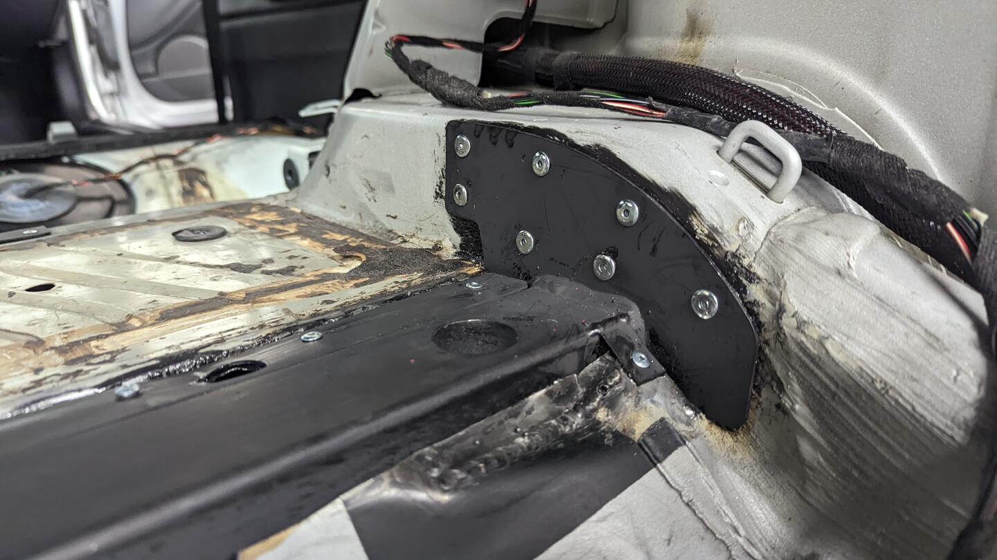

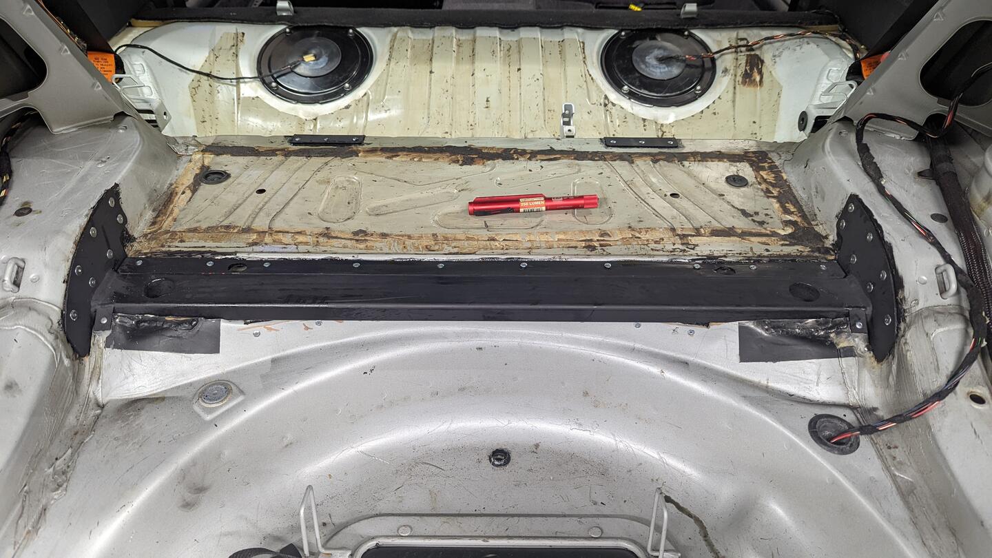

                I feel accomplished, finally complete with this install. I did everything to the T.
                The biggest issue I ran into was my rivet gun not strong enough to break the big rivet on the side so I had to really muscle them off.

                  Nice work!
                  I just purchased all hardware/tools last night and will begin disassembly maybe tonight, I sure hope it all goes as well as it did for you.

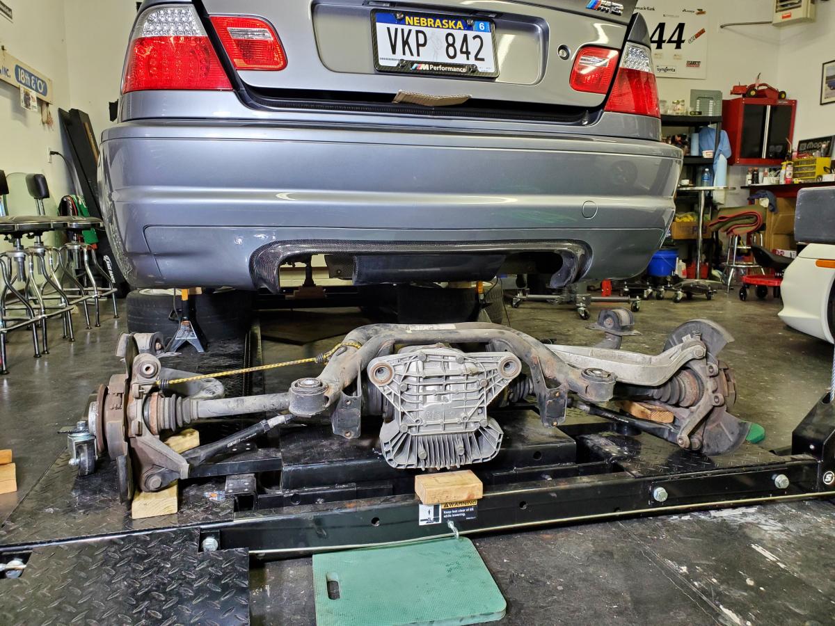

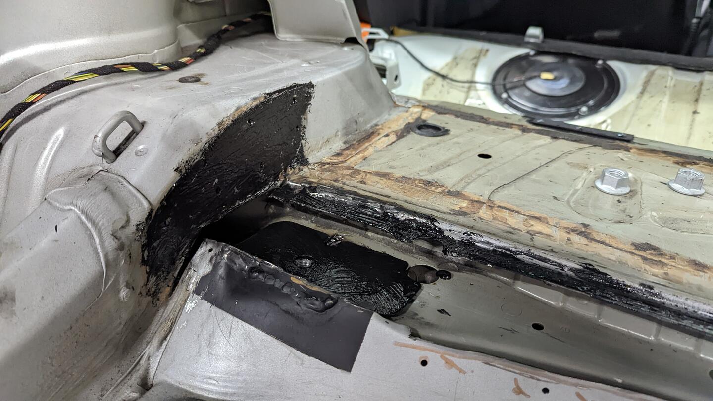

                    starting a job is like ripping off a band aid. Man it took me forever to get started!!
                    Now I have to clean up the underside with a wire brush to clear the surface rust and repaint then the reassembly begins. Got my subframe parts from the powder coater and they look sick. Gotta install the CMP bushings and slowly put back together since its so damn heavy

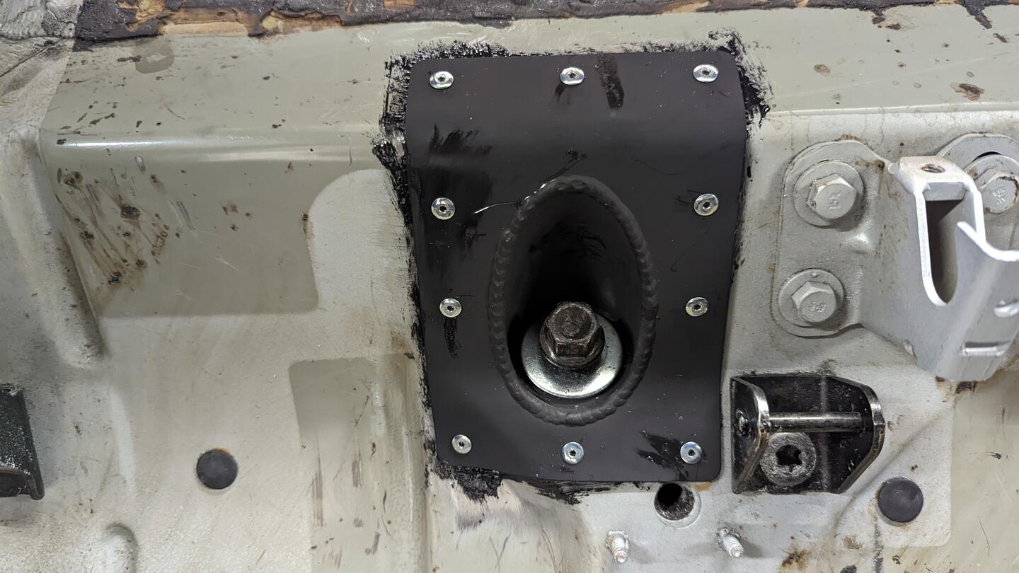

                        tightening the front bolt is becoming a pain, def needs 2 people, the nuts are those locking nuts that are oval in size. so the bolt keeps rotating.
                          Dang I should of painted my silver too.
                          Great job guys!

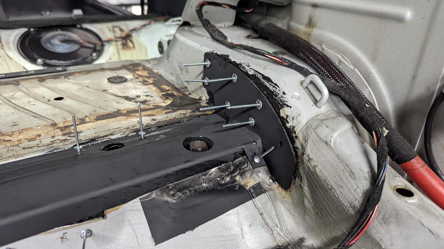

                          Please remember to use the extra plain nut as a locking nut in one of the ways shown below. The jammed nuts will now act as a bolt that allows you to use a wrench when inserting the stud and when holding the stud while tightening the top collar nut (in the gusset cup).
                          Once that top collar nut nut is tightened the stud is fixed and there’s no need to hold the stud when later tightening the lower nut that holds the subframe.
                            Originally posted by VinceSE2 View Post
                            Great job guys!
                            THATS what those nuts are for!!!!!! duh!
                            Edit: I did the complete install watching videos. I did not find the printout instructions you sent anywhere online.
