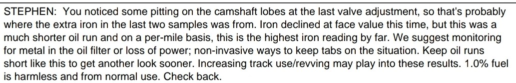

            I got my UOA back from Blackstone the other day. It reads kind of scary but their interpretation is accurate on how I'm driving the car harder nowadays. Not sure where the brass/copper is from (valve guides?) But I think the iron is from the camshaft wear I noticed.

              I don't know...with low lead count and high copper and trending higher iron, it may be time for a rod bearing job? You may have already gone through the lead layer (thus low lead count) and working past the copper layer (high copper count) and even into the steel shell (high iron count)? When was the last rod bearing changed? That would be my conclusion.
                Yeah copper is usually attributed to rod bearings. Doesn't really mean much without a clear trend though.
                  Rod bearings were changed out about 80k miles ago at around 200k.
                  I'm leaning towards looking for a trend before I make any moves. The weird thing was there was always copper in the oil samples I've given. The first sample was after I bought the car. The second sample was after I changed out the rod bearings.

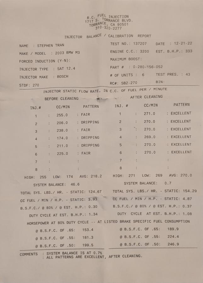

                    Just before Christmas, I sent the (presumed OE) first set of injectors out to RC Fuel Injection for cleaning and flow testing. Got back from vacation to find the package of freshly cleaned and flow tested injectors waiting for me like a late Christmas present.
                    I was also waiting to see how bad the injectors were lol.
                    Seeing that injector 4 was nearly 100cc lower than spec, I wasn't disappointed lol. That was amazing. I'm betting these were the OE that came with the car, so about ~260k miles on them.

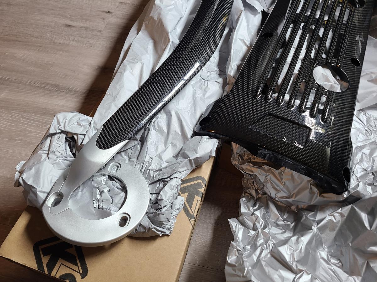

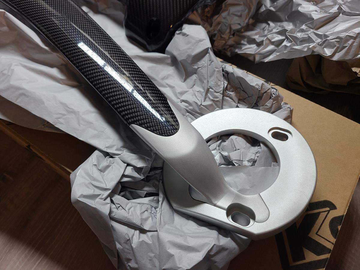

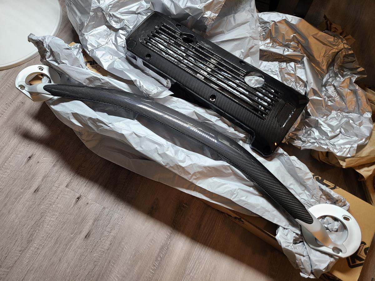

                      Oh yeah, forgot I had these too
                      Bought them during the Black Friday sale, while waiting in the Madrid airport for our flight back from Spain. I jokingly asked if I could pick them up on the way (they were actually a 5.5 hours drive away from Madrid).
                      Click image for larger version  Name:	20230103_211628.jpg Views:	0 Size:	139.5 KB ID:	199019
                      Click image for larger version  Name:	20230103_211530.jpg Views:	0 Size:	220.4 KB ID:	199017Click image for larger version  Name:	20230103_211554.jpg Views:	0 Size:	209.0 KB ID:	199018

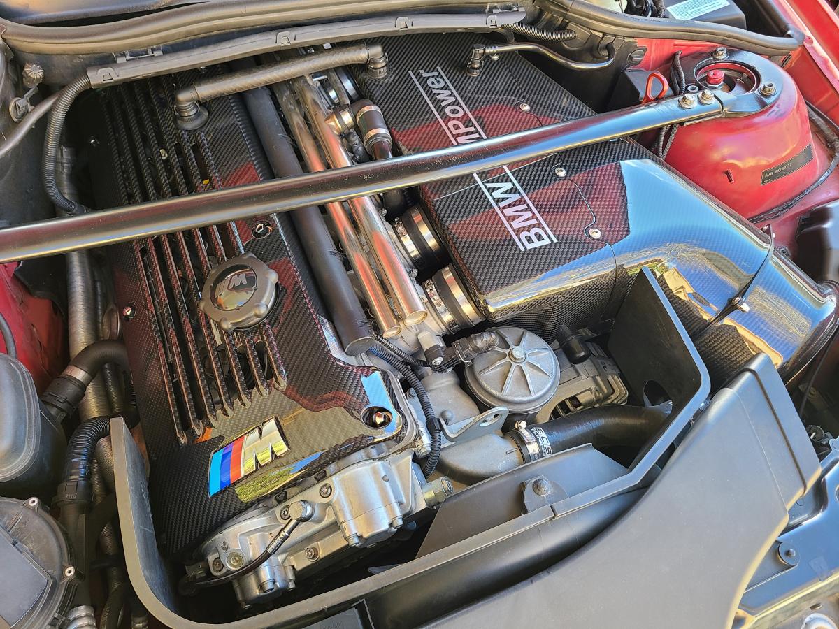

                        Finally installed the (pricey) badge on the engine cover.
                        Click image for larger version  Name:	20230129_125450.jpg Views:	0 Size:	231.9 KB ID:	203079
                        I'm leaning towards leaving off the Karbonius cf strut brace as the 3 piece OE brace is much more convenient for working under the hood.
                        I've been thinking of either cleaning/dressing up the current bar or buying a fresh new one.​
