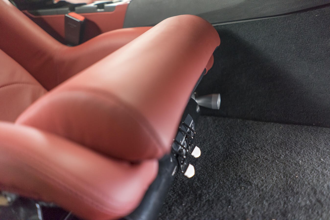

    Trade off with the front handle is you lose the ability to mount a fire extinguisher under the front of the seat-- if you care.

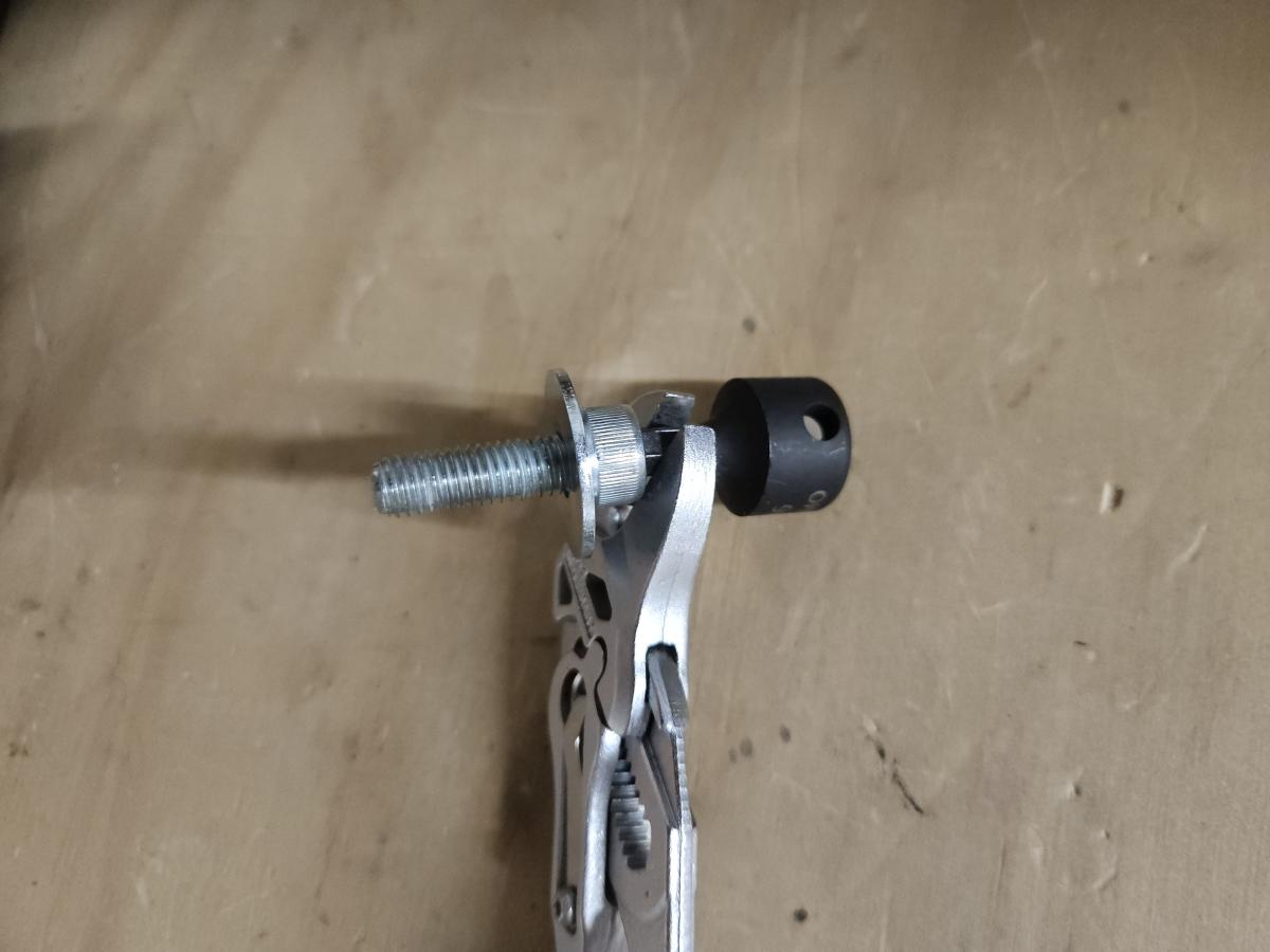

            Click image for larger version Name:	20260907_140020.jpg Views:	0 Size:	65.8 KB ID:	367658
            Instead of the channel locks, use a ratcheting 8mm box end wrench on the allen socket. ***I assume its an 8mm, if its 7mm, then switch to 7mm wrench, etc

              The real cost of power is speed of back seat access.
                I'm pretty sure I can package a fire extinguisher and the slider handle, there's a ton it space under there. I'll mess around with the CAD later to make sure.
                And I'm immune to your peer pressure, Bryson. It really is just a preference thing, I like having the manual sliders. E82 has manual seats too and I've had no desire to change that.
                One bonus that comes from being stubborn is that if I can package everything for the manual sliders, it should work for the electric ones as well.
                  Really nice work

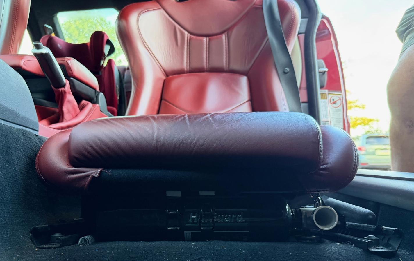

                    I don't know how standard the bottle size is, but mine is basically the exact same length as the space between the slides.
                      ... iphone really exposed for the wrong area of that picture, but the statement stands :P
                        Hmmmm, I think I can still squeeze a handle in there. Keep in mind the handle is going to be made out of bent sheet metal, so I really only need a space that's ~5mm wide for it to sneak through.
                        Might look at different fire extinguisher sizes to make my life easy though.

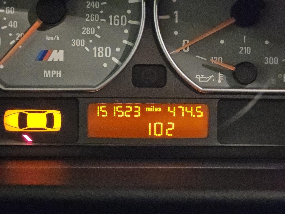

                          Was also kinda hot and it was super nice to have a digital readout of coolant temp in the gauge cluster. Glad I spent the time developing that feature.
                          I did quickly realize that, even though I previously discovered that you could display up to three sig figs in the low OBC by overflowing the BCD nibbles, I never implemented the functionality. All displayed values were being capped to two sig figs (which is technically how BMW intended this to be used, but that's no fun).
                          This two sig fig limitation meant that all coolant temps between 100 and 149 C would display as 100 C. Not a huge deal since I could always look at Gauge.S for the more precise value if I saw 100 on the low OBC, but definitely annoying. Fix was easy, though:
                          Tested it by sweeping through numbers on Gauge.S, but I think I'm going to need to do some more validation before I fully trust this. Not because I think the logic is incorrect, but moreso because I fooled myself once already . I tend to start shifting at 6k when I see coolant temp reach 100 C, so want to make sure this is fully accurate.
                          Repo updated and all that in case anyone is following along at home.
