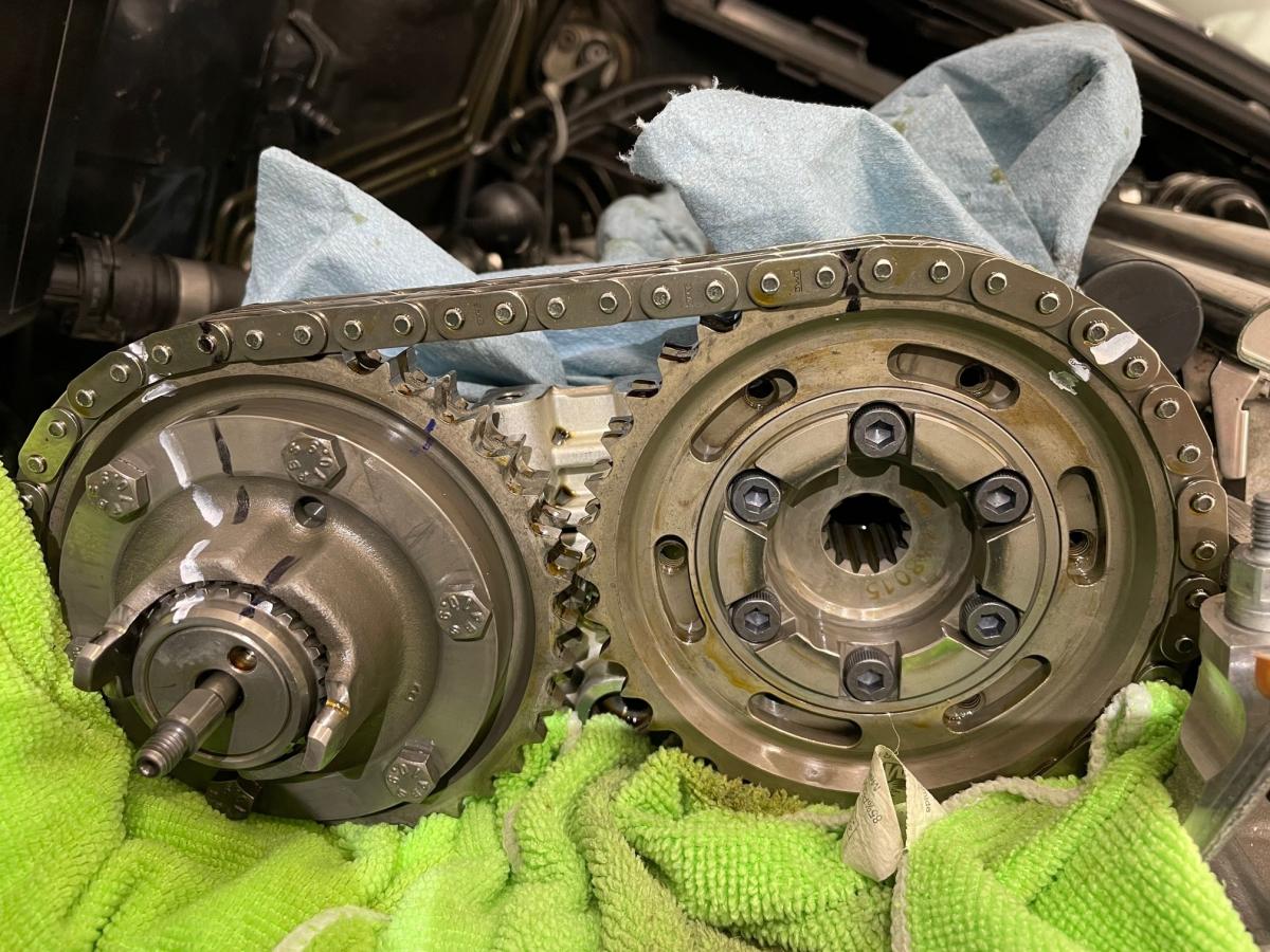

    On the Vanos rebuild I decided to address all the issues and completed the rattle fix, install new cam bolts and the Beisan upper chain guide. My guide was intact when I replaced it, but glad I did. Had some issues putting it back together where I couldn't get the timing chain/sprockets back on the hubs and then took things apart and realized I inadvertently installed the upper chain guide below the lower guide 🤦‍♂️

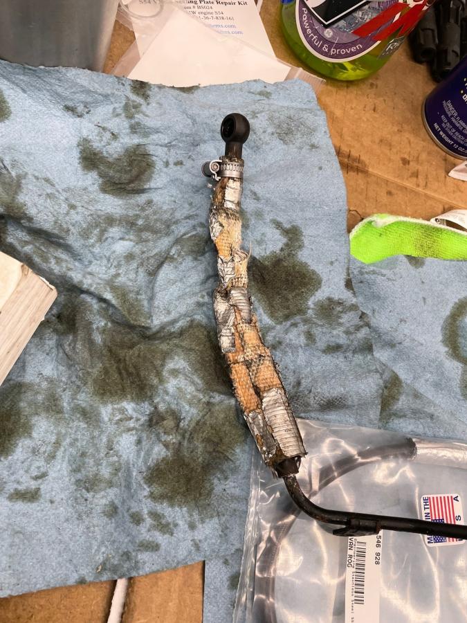

    Next was replacing the oil feed line for the Vanos - opted for Rogue Engineering, here's the original one - man, lower end was TIRED, glad I did this.
Name:	Vanos oil supply.jpg
    And here's the entire Vanos system reinstalled and buttoned up with new oil feed line.
Name:	Vanos installed.jpg

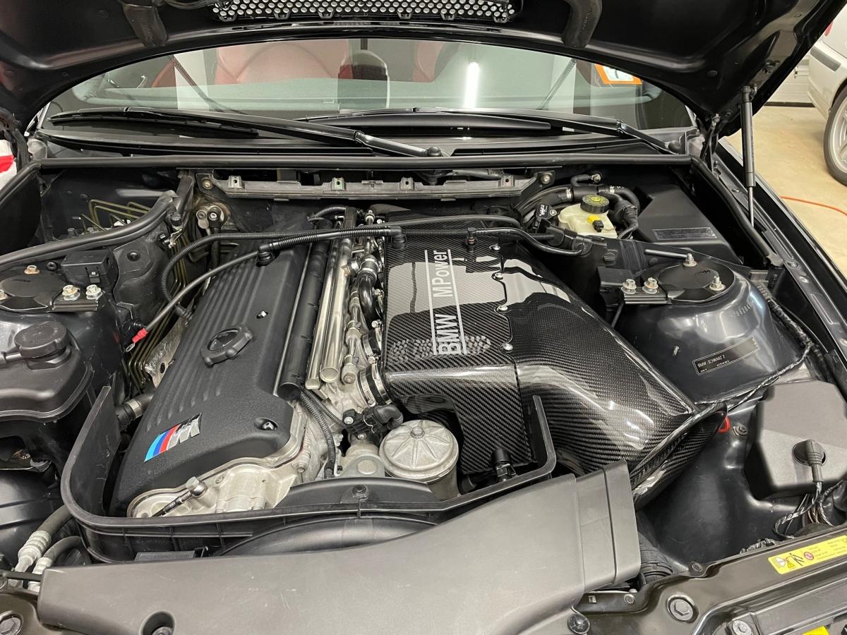

    Finally it was time to install the new intake - getting the plenum into the new boots was a bit of a struggle, but once I got it started it went on pretty smoothly.
Name:	CSL intake installed.jpg

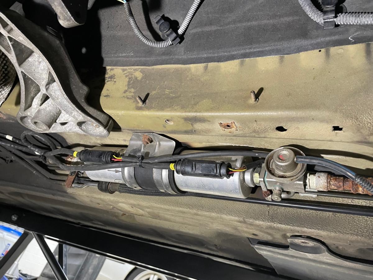

        While I had the intake off the car I decided to clean up the routing of the secondary O2 sensors. I had previously split off the secondary sensors from the harness going back to the DME to be able to have good wiring run to the rear O2 sensors without splicing the line. Here's the line with the harness for the rear sensors.

        And here's how I tied them off where the fuel filter resides to help provide some protection for the connectors.

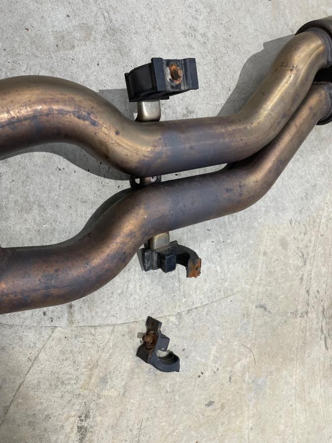

          I've been struggling with a resonance on this exhaust system after I installed the new SS headers and cats. While I was under the car I started looking for heat shields that I thought might be rubbing and when I moved the exhaust I heard some noise near the mount on Section 2 and realized the mounts had sagged...
          Lesson learned for me - pretty much anytime you have Section 2 off the car - change the mounts, cheap and a much bigger PITA to drop everything and do it later. Top nuts were in tough shape so removed the whole section and was able to beat an 11mm socket onto the nuts and get them to back off, phew - avoided the cutoff wheel.
          Here's the old hanger
Name:	Exhaust Hanger.jpg
          And here's old vs new hangers - FCP to the rescue!
Name:	New exhaust hanger.jpg

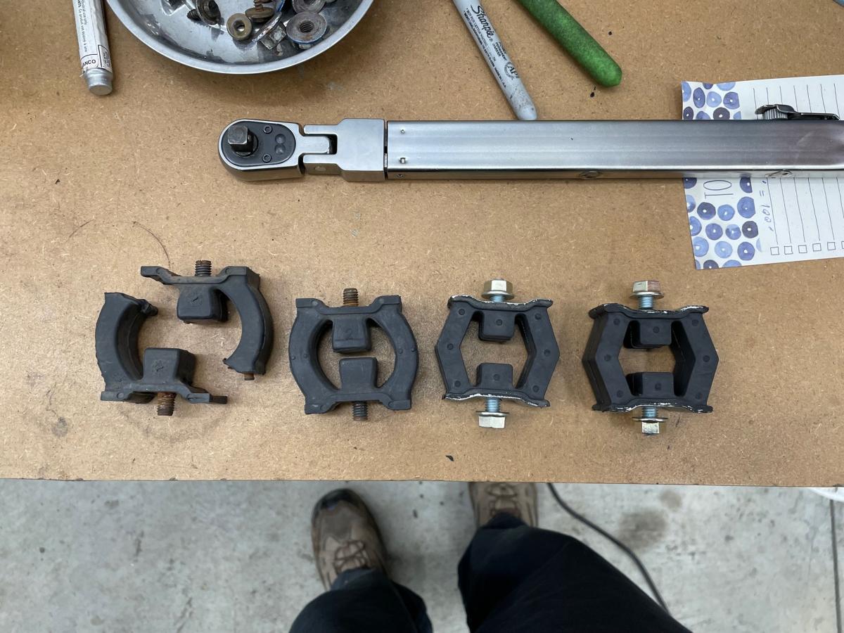

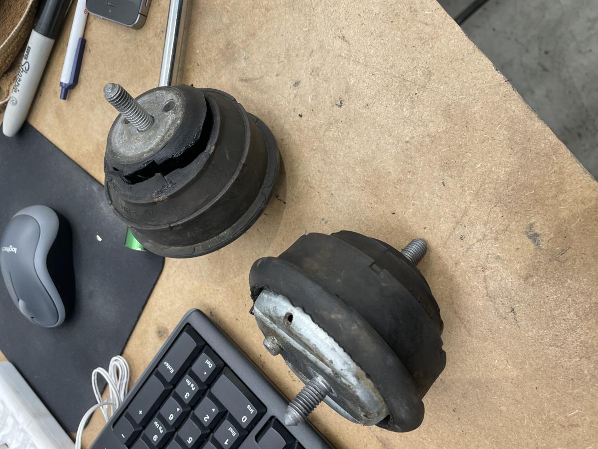

            From reading the installation instructions for the TMS airbox, I knew it was going to be sensitive to engine height - so I bought a set of new engine mounts and decided to throw them in. After pulling out the old ones - wow, glad I did!!

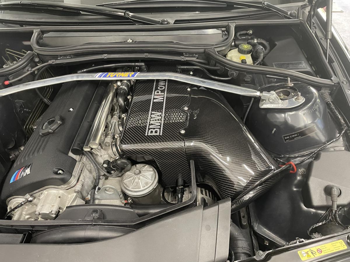

              Then went to install the airbox inlet half & no way could I get the pins at the bottom to engage. Maybe it’s a case of user error - but it shouldn’t be that hard…
              As I felt I was pushing the limits of breakage, I decided to put a engine lift fixture on and loosen the lower nuts on the engine mounts to get the engine as high as possible.
              That ended up working and the pins ended up engaging (but not in a particularly reassuring way - no definitive “clunk” when they mated) and I was able to join the two halves together and then finish the rest of the misc items in the bay. Here’s the installed pic:
              as you notice, I had to remove the OEM strut bar from the car because it interfered with the manifold - not a happy point in the build…. So I installed an old TMS bar that I had (that’s been de-stickered).

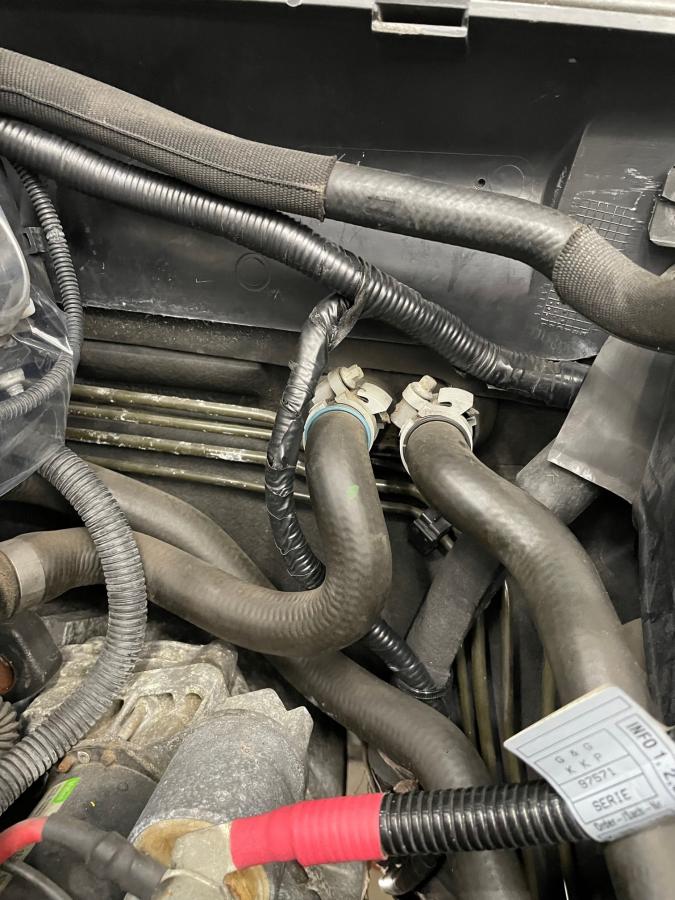

                      Originally posted by 01M3Fan View Post
                      I took the opportunity to install a different aux water pump that I’ve seen others use to free up real estate in the area.
                      Here's the original two pump setup
                      And here's the single pump setup which eliminates the taller pump
                      This is such a great little change, were these only available on the Euro models? I noticed it's hard to find the single pump on eBay in the states, mainly available overseas in Spain and UK. Great build, thanks for sharing 😎
                      /// 2004 SG/IR - Build Thread
                        #41
                        Any non-M E46 will have one of those. Easy to find on eBay/local junkyard/FCP/etc. if you look for the non-M part number: 64118369805
                          #42
                          Would there be any downside swapping to this single pump valve?
                            #43
                            Yeah no auxiliary pump for the heater core loop (that's what the second cylinder is in the M3 part), so worse heater performance. Not an issue if you don't care about heat though.
