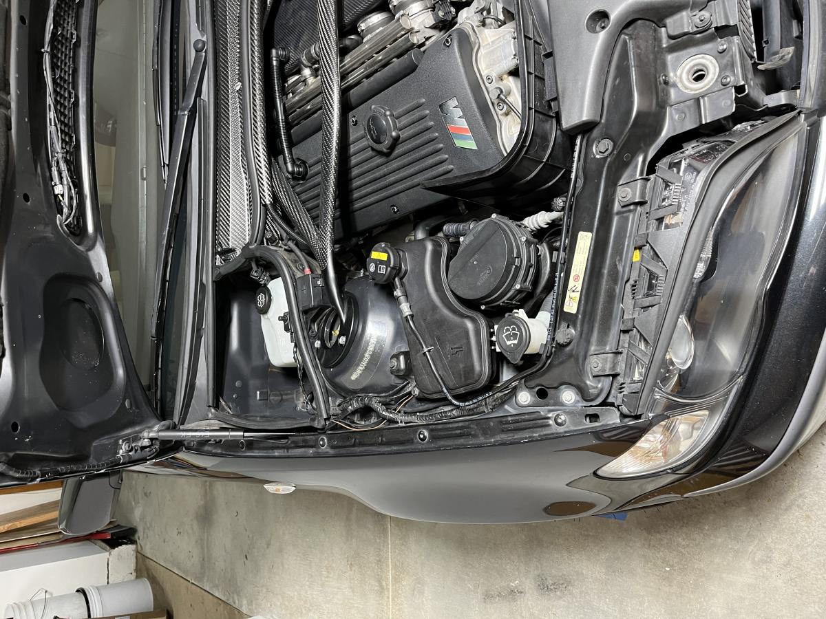

              Snuck a couple hours in to make the wagon that little bit more M3-like. In prep for the v-brace bracket welding, I installed M3 undertray panels with non-m sedan deflectors in front of the rear tires. I’m happy to report that the M and non-m parts fit perfectly together to support the v-brace while also mating up to the sedan side skirts.
              Click image for larger version  Name:	IMG_4764.jpg Views:	0 Size:	94.0 KB ID:	217396 Click image for larger version  Name:	IMG_4765.jpg Views:	0 Size:	104.1 KB ID:	217398
              After I got through that, I installed the M3 washer fluid reservoir and ran the wires to the level sensor. I’m waiting for a 5/32” union fitting before I plumb in the hydraulics and switch my wiring to the M3 pump. To fit the reservoir to the bumper carrier, I had to relocate the horn to just under the right side grille as the horn and washer reservoir were occupying the same space.
              I may be the only e46 with two washer fluid reservoirs right now.
