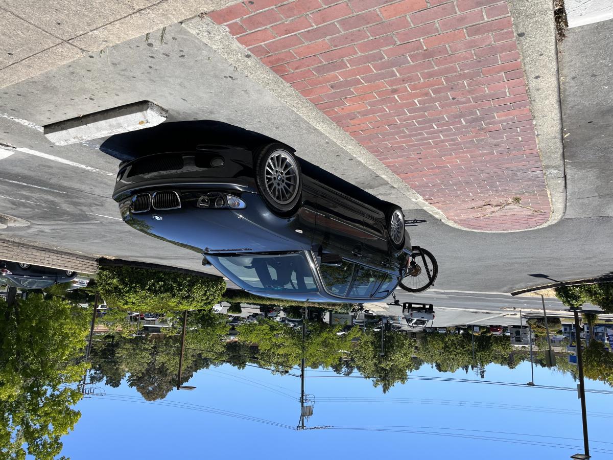

                        Did just fine with the big bike on the highway, no noticeable wind noise even though the bike is a solid foot and a half wider than the car. Trailer hitch is the way to go!

                          That is a big bike! looks fun tho. I need to get another one of those...

                                Get an older bike on 26’’ wheels with steeper head angle and it will be 1’ shorter, problem solved!
                                My 2022 SC Bronson XL also have a 50.5’’ wheelbase, at least I save 0.75’’ on my 1up hitch rack cause it’s mullet!!!
